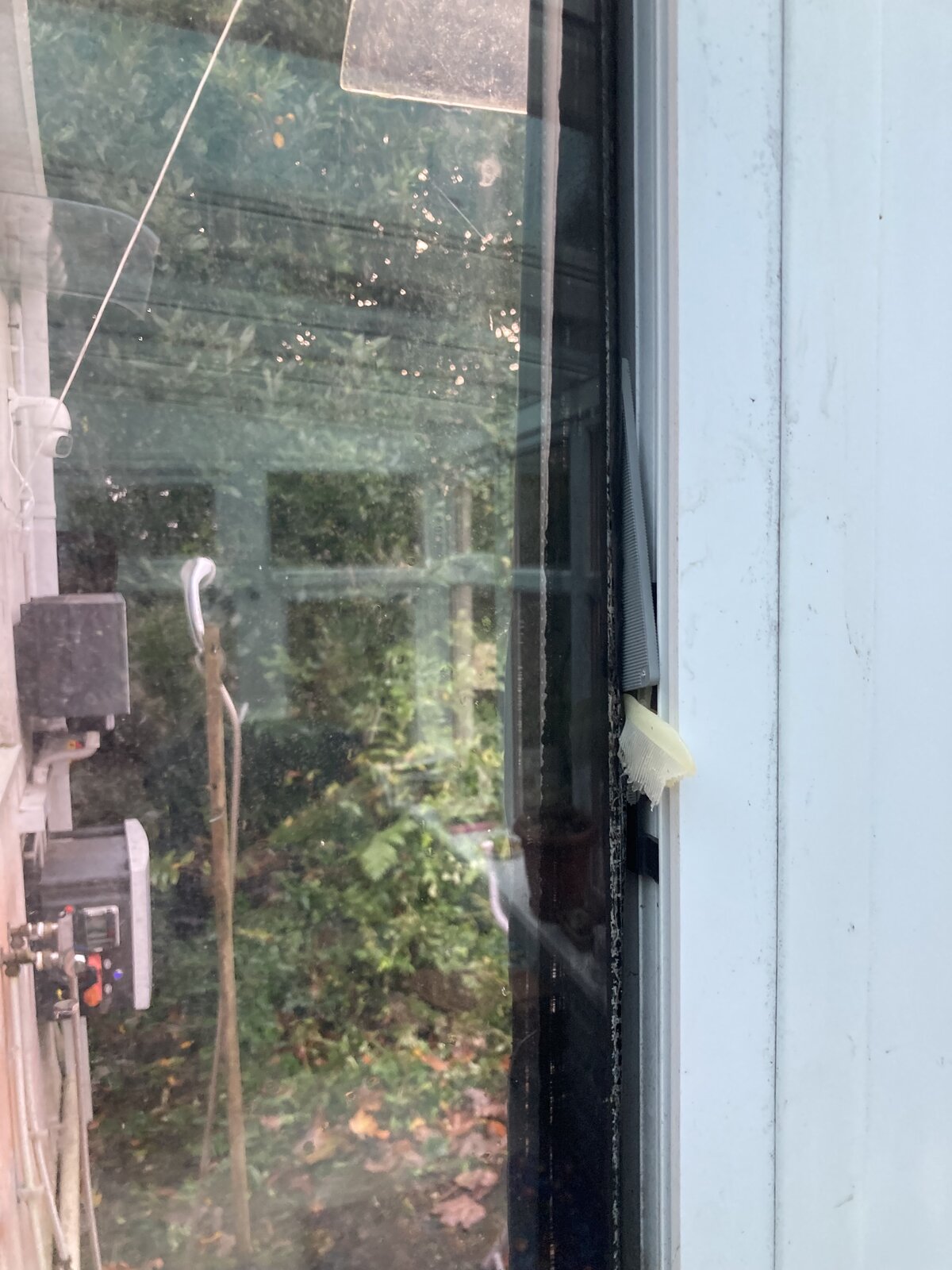

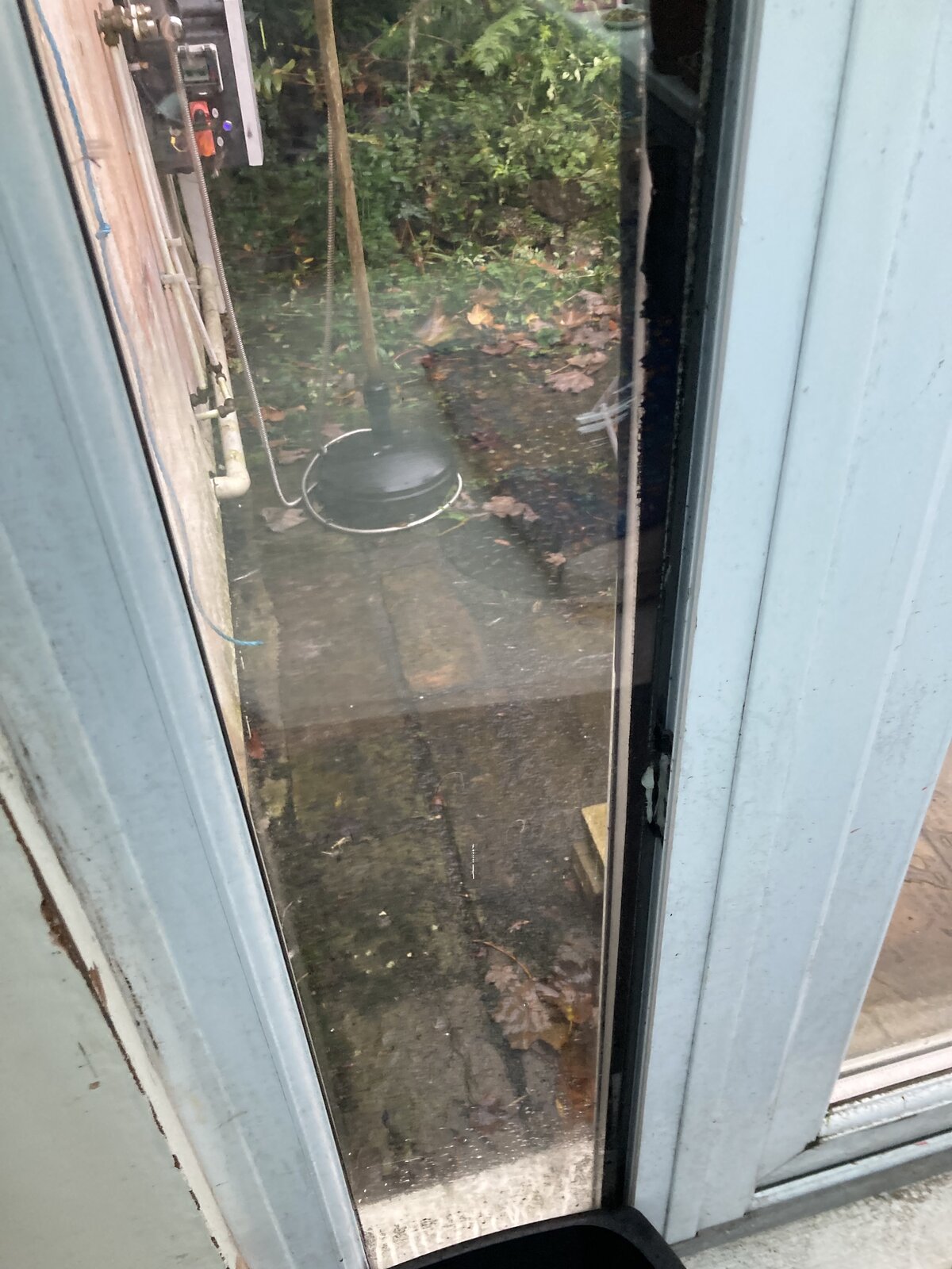

One section of the Conservatory has "Blown" so I am ordering a new Pane. But why is there a Gap between the Glass and the Frame?

Expansion. The glass unit is usually 10mm smaller than the gap. - 5mm all round
