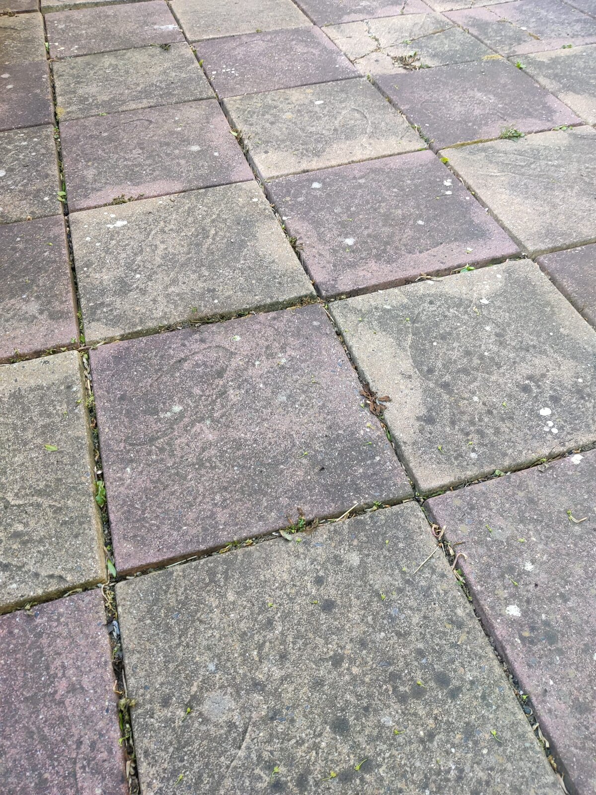

Not sure of the name but just general grown in between the slabs as pictured.
Most weeds grow from seeds that are blown in and grow upwards. People don’t seem to understand this and imagine that they have somehow spread underground to appear in the middle of their lawn / drive / etc. There are some weeds that do this - Bamboo for example - but they are the exception. Fabric will do nothing for you here.
