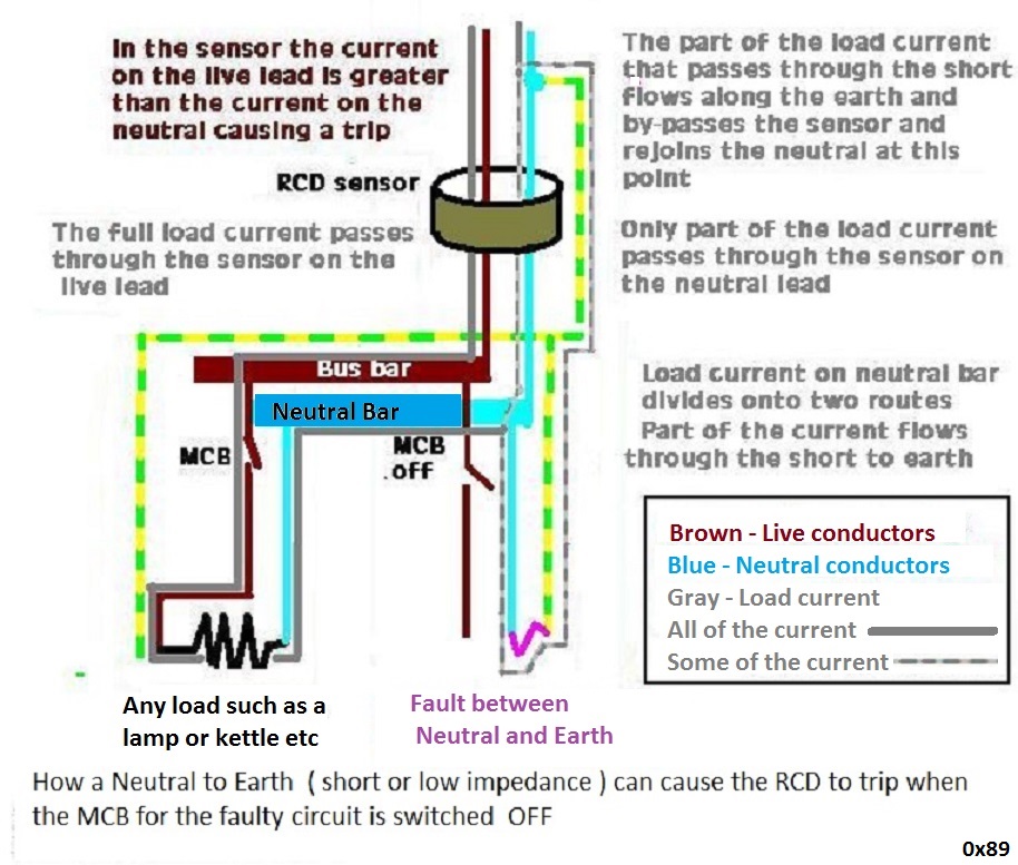

I have a garage which just has a new consumer unit installed. The building, separate to the house, takes its 13amp supply from the main house.
I'm installing some lighting on one of the circuits on the board, all switches are off and I'm freely touching the copper. No current.
When I put my metal screwdriver across and bridge the wires it knocks out all the sockets in the house.
Keeping in mind the garage consumer unit circuit is off.

You are probably shorting out neutral and earth and tripping an RCD or RCBO.

A fault between Neutral and Earth can trip an RCD even though the MCB for that circuit is switch OFF.

Presumably you've left the main switch (on the garage CU) on while you"re working on the lighting circuit? Bad habit to get in to

Is it an RCD/RCBO that is tripping in the house (if it is it'll have a TEST button on it).
If thats a yes then low odds there is any fault in the garage CU, most likely cause is you not isolating properly before starting to work.

The only fault is the short circuit you created with your metal screw driver, The RCD is doing exactly what it is intended to do.
