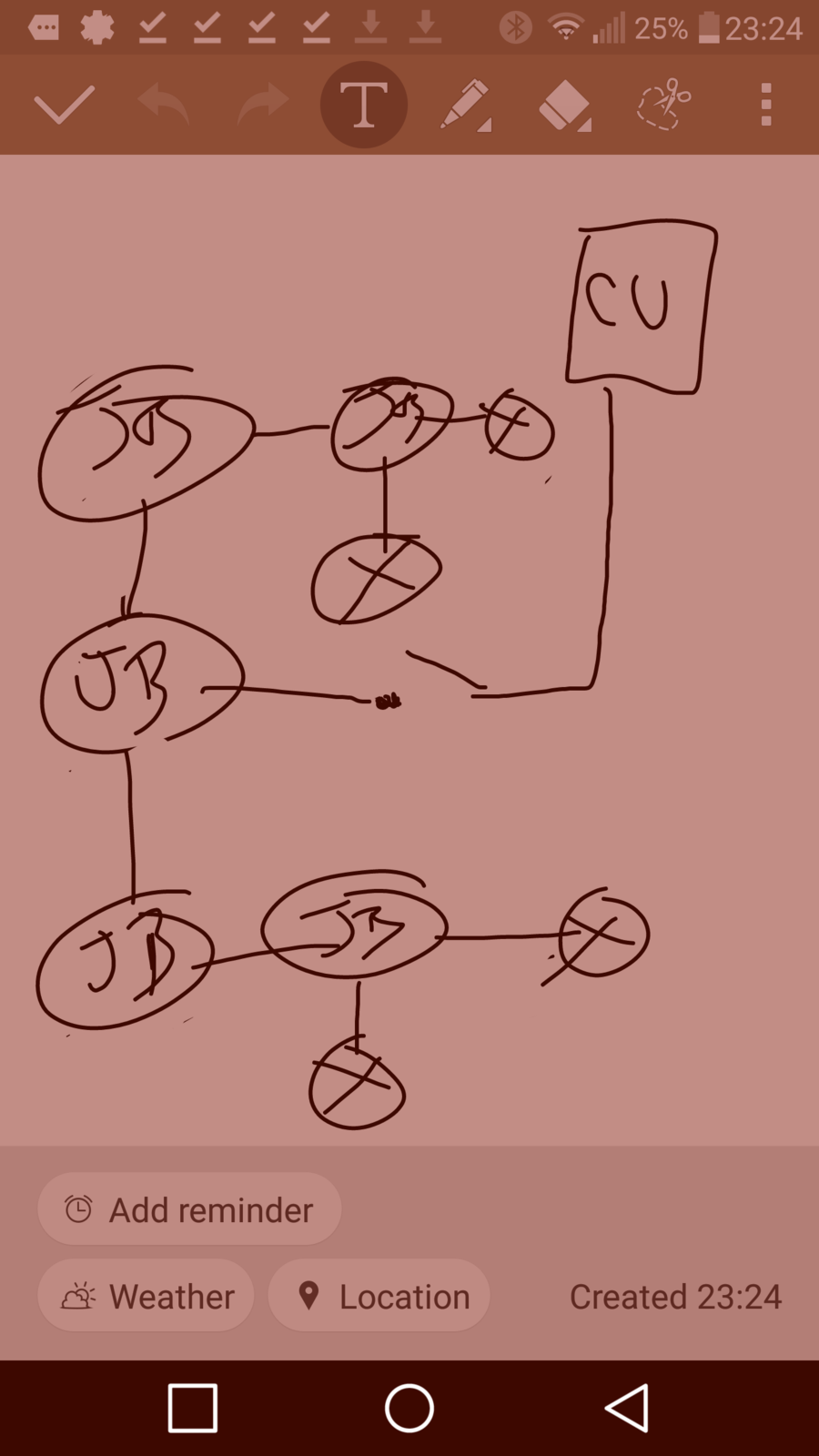

The guy that owned my house before me was an electrical engineer. I suspect he done a lot of the electrics himself and although he obviously had the electrical knowledge he clearly knew nothing about building regs, as I discovered when I ripped apart the kitchen to find a 10mm cable to the cooker run just below the bonding plaster at a perfect 45 degree angle.
I examined the lighting circuit in the garage, a condensed version of which is shown in the crude schematic attached (JB=Junction box, X=Ceiling light). I know you can essentially branch out anywhere on a radial but is this circuit permissible?

Nothing eletrically wrong with it, as such. Perhaps he liked junction boxes.
He could have run the cable from light to light - if the location of the lights and the routes made that feasible and better.
That's not actually an explicit BR contravention. There is no BR which requires cables to not be run like that.
