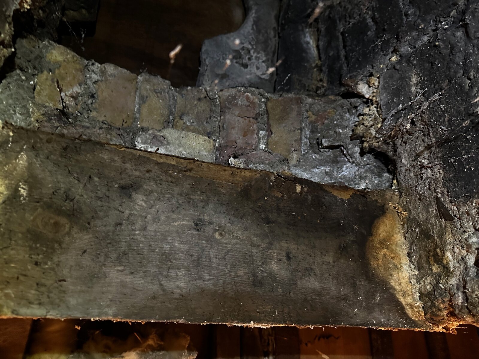

Hello all,

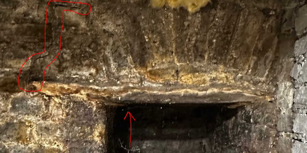

I am doing some works in my old victorian damp cellar. Whilst working there, I have noticed this lintel over the old coal chute arch, which is not is used anymore. The lintel is actually wood and suffers quite some wet rot, especially on the left side. I can almost peel off bits of the wood and the entire lintel feels damp to the touch.
It's not in great condition, but given that this is 100 years old in an already damp cellar, probably not too surprising. I am not looking to invest much here, but any suggestions of how I can cleanup/strengthen this a bit? I still have some ronseal wet rot wood hardener, but I am not really sure this is going do to anything. Are there perhaps some epoxy based hardener to add some strength here?
I am not looking to do any changes to the wall other than maybe a coat of lime wash to bright up the area a bit (as I have done on the right wall)

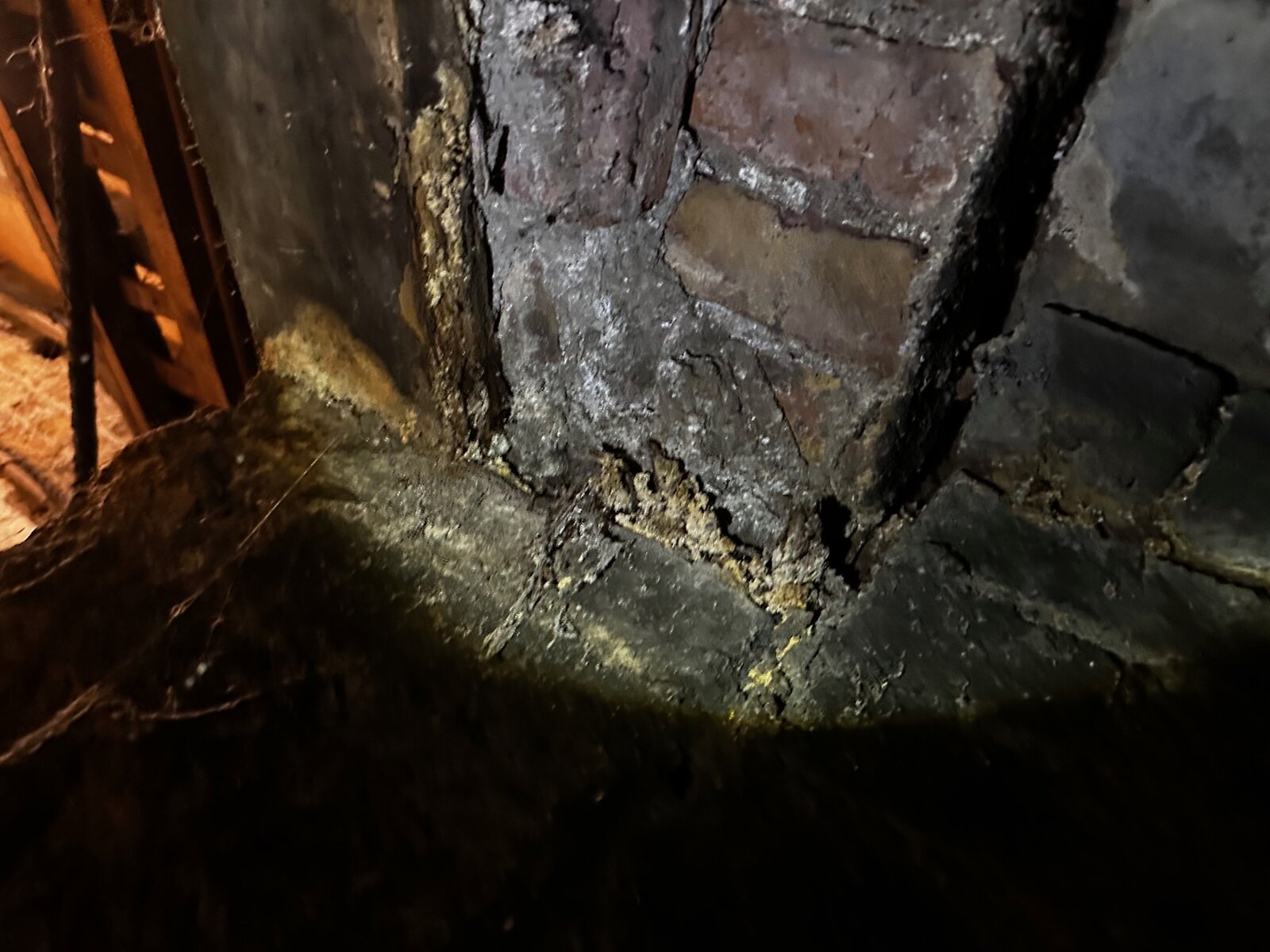

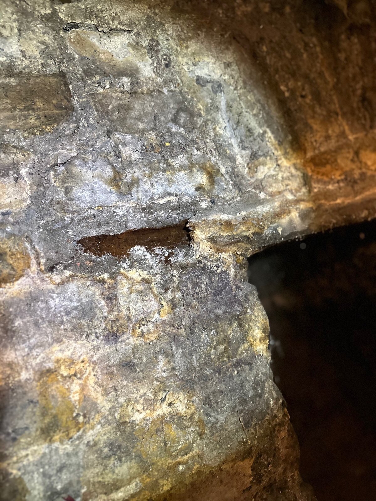

I fiddled around with it a bit, and a big chunk came off... that brown area behind feels very porous, I can almost carve out more with my finger

the right hand side of the arch looks good - but the left hand side the arch looks like it is sitting on the wood, even some cracking in the stonework where it may have settled a bit onto the rotten wood, if that is the case it could come down if you remved the rotten wood
chances are you could gently remove it and it may stay up, but if it does move down you may have to do some repairs to those tiles near your frnt door. If the wood is still has a bit on integrity too it where my arrow is pointing, acro prop it, slowly and gently remove the rotten wood and back fill with concrete

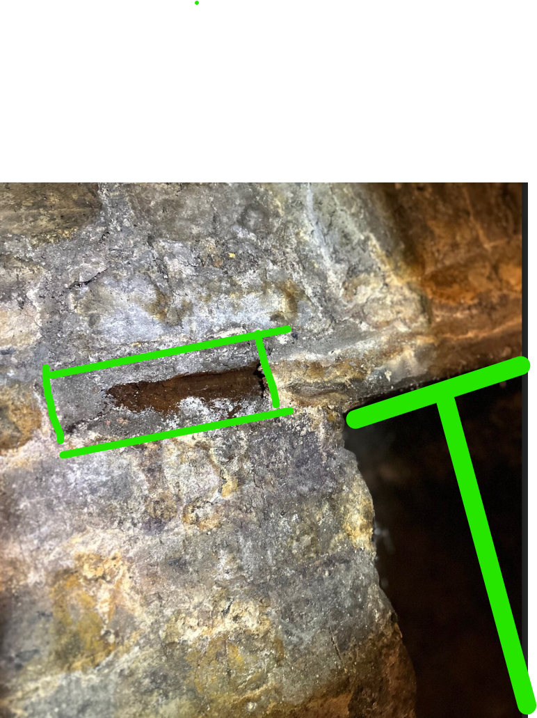

2. Removing the entire lintel would probably also cause these filler bricks between the lintel and the actual arch to come down. Would it make sense to prop up the wood and then scrape/carve out only this rectangular bit and backfill with cement?
you don't want to be jacking up to much, in fact not jacking it up at all, it needs to be tight so it can't move down, lift it up and you have made things worse - you might get away with a car scissor jack on the end of a piece of 4x4 -
the green square you have highlighted - how far can you shove a screwdriver into that ? how soft is it a couple of inches in
pressed a screwdriver in with virtually no resistance.... all mushy..

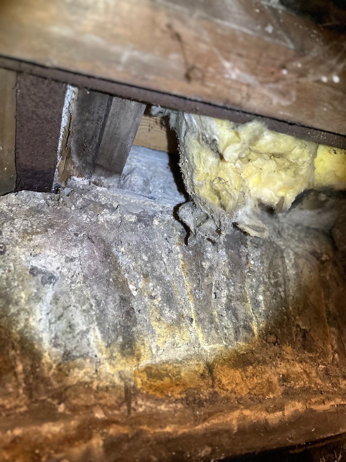

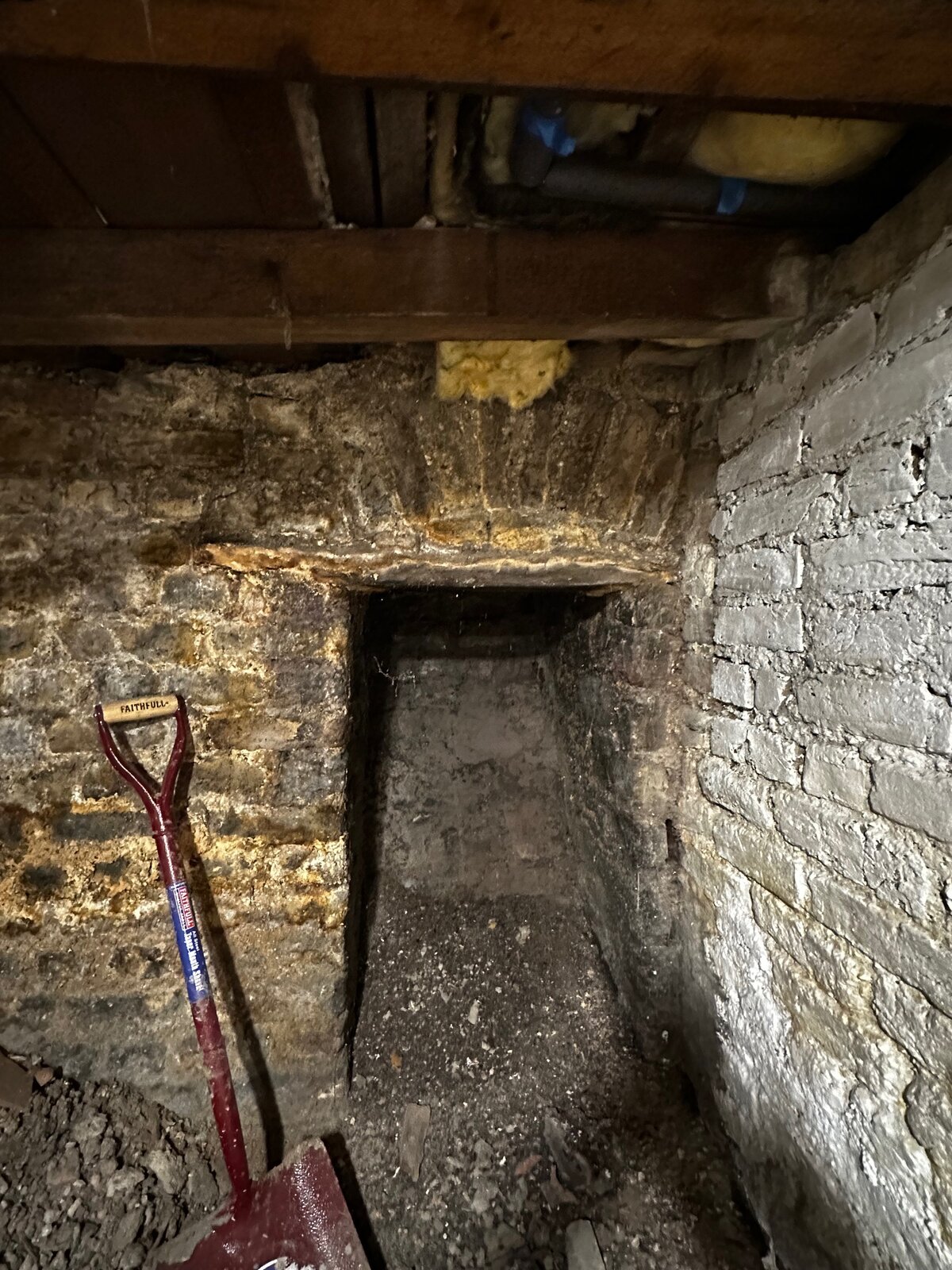

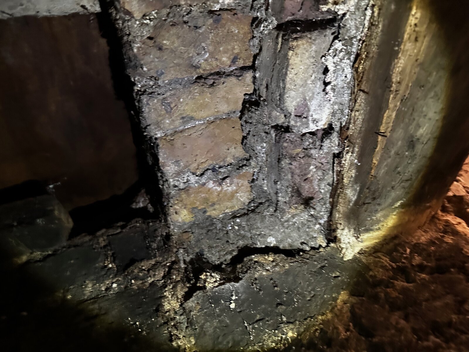

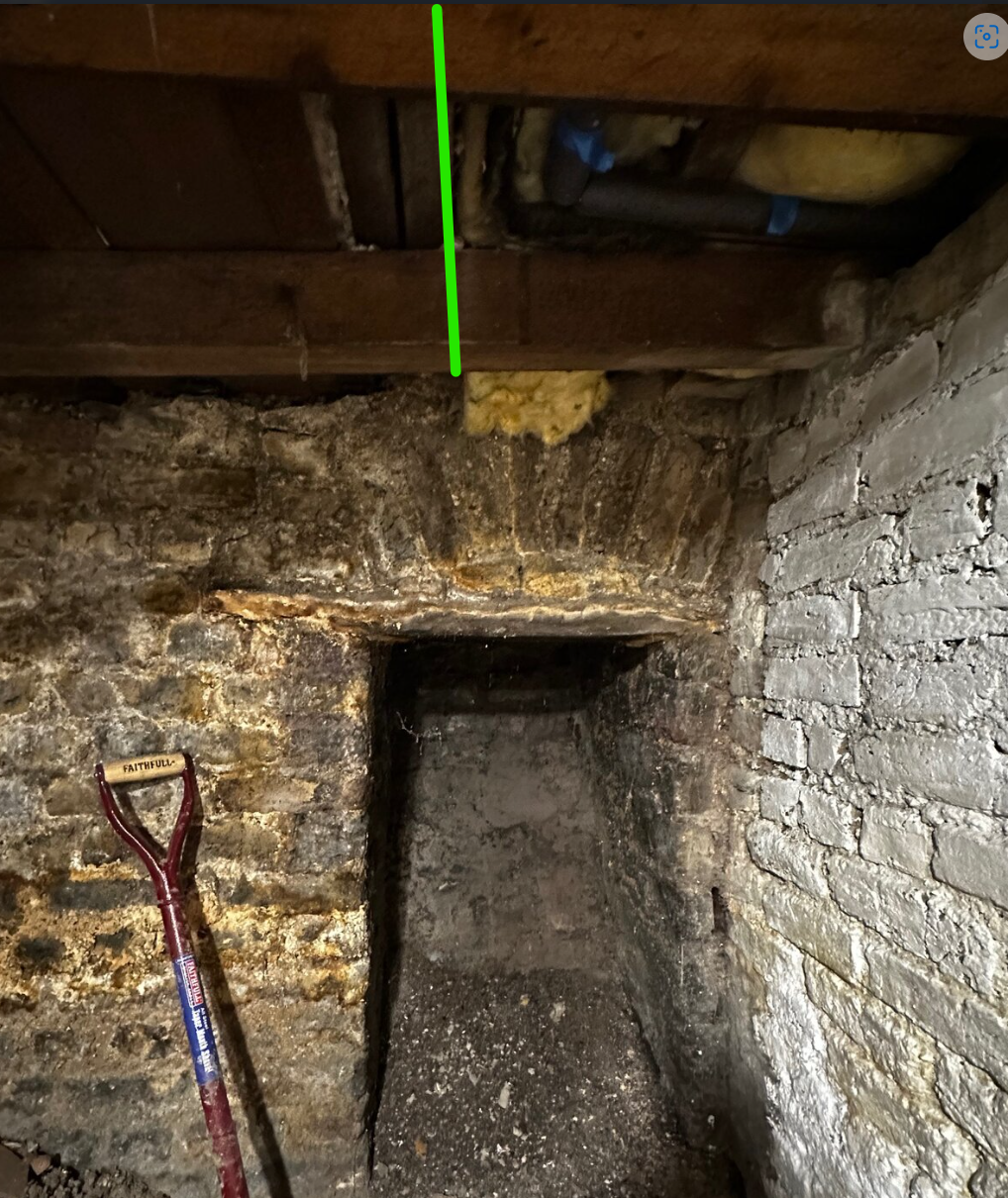

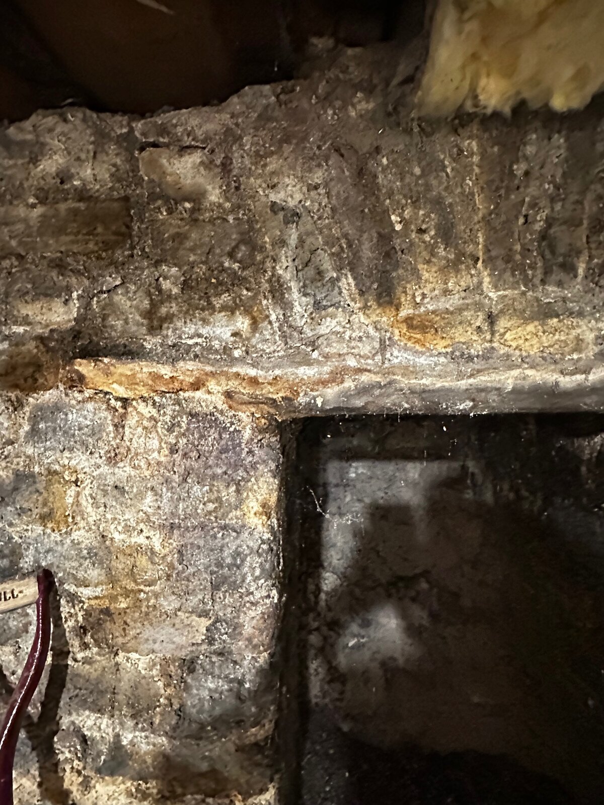

Here some more details. The wooden lintel is about 17cm wide, but the entire brick arch is 40cm wide. The wood lintel is just on the front part...
this picture shows the arch and the wood board from below:
and then the left (bad) side from behind:
and the right side from behind:
Given that the board is only on the front, the arch must be supporting itself fine? To me it looks like the arch is stable, and the wood board is just holding up the filler bricks between the arch and the wooden lintel? What do you think?
OP,
Keep your arch its a rare Victorian survivor - dont go knocking everything about or using a concrete lintel.
The lintel & infill need replacing with, say, a steel, Former strap just like the wrought iron ones supporting Victorian fireplace arches. There would be no need for a Big Boy Acrow.
What the archway itself might be supporting is hard to tell?
Pics of the timberwork above the archway would help?
Joist tails seated in wall pockets & all timber showing signs of rot will need to be cut out, the area treated with fungicide, & replaced with treated & protected materials.

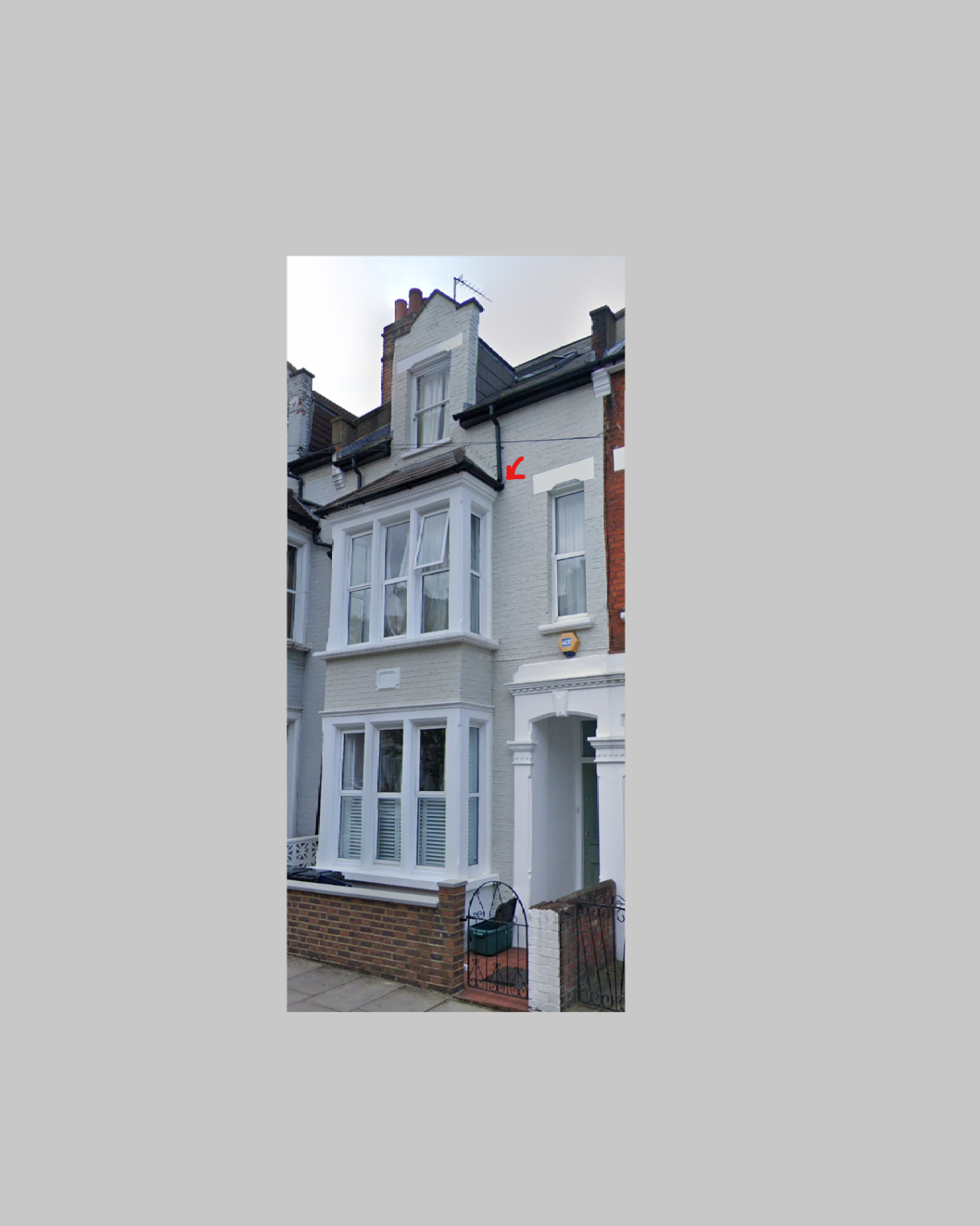

quick vent >> AAAAARGHs.... why do so many DIY projects on victorian properties start with opening a can of worms and discovering problems that need addressing first. Buy a victorian period property they say...it's got so much charme... don't worry the L3 survey will pickup on any issues.. HAH! Been at the property for only two years and have fixed/improved/DIYed +50 projects...most of them small stuff, but the bigger ones have always cost much more time and money as expected....

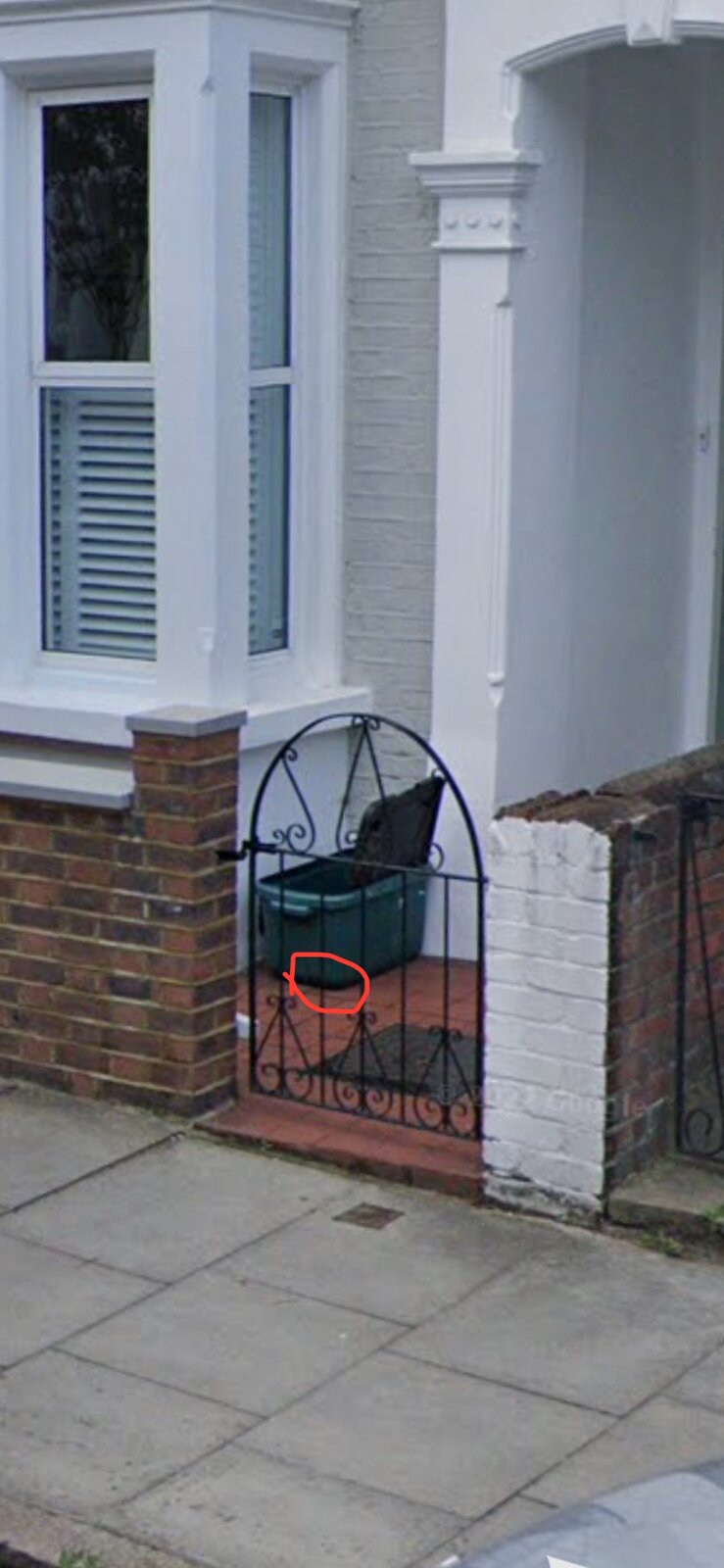

Yes agreed. The green line is where my hallway is. My front door is setback about 1m from the wall, which is aligned with the front wall of the house. So left of the green line will be part internal, and part external, which is the tiled area outside under the doorway.

This is an interesting point, coming to think about this. The bay roof actually drains towards the other side and runs into a shared downpipe with my neighbour. However(!), they bay roof drain also takes all the water from the main roof above on the same side. I have noticed during medium/heavy rainfall that the drain cannot cope with the amount of water bursting out of the top roof pipe where indicated in red. A good amount of water then splashes straight down onto the front garden on the tiled area exactly where arch in the cellar is. I did not think that this would sip through the tiles into the ground though... so never did anything about it, apparently nor the previous owners. I have pictures of the basement from 2 years ago when I moved in and it looks the same, i.e. this might have existed a long before I moved it.
Maybe this is the first point of action to increase the size of the gutters so they can cope with the amount of water appropriately. Another unexpected couple hundred quid out the door...
