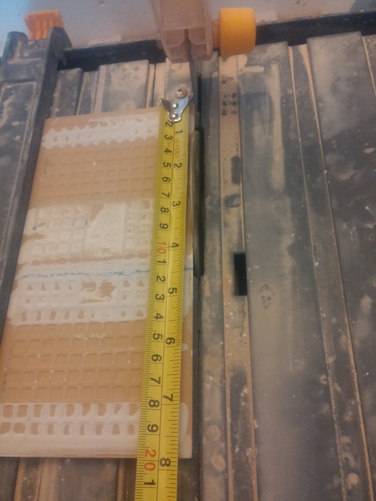

Hi,
Can anyone shed light on this issue, maybe it's me being stupid!
I basically can't cut the tile length ways without turning the tile over because the guard mount is in the way. The blue line is where it goes to and then I have to mess about turning it over and it's not great.
Any ideas??
Ta.

Thanks big-all for the reply.
I am not sure, tried both ways and it will not pass the guard absolutely no chance If I want the cut the tile in half down the middle as one side of the tile is left other over the right with the guard in the centre.
Very annoying, suppose that's why it costs £50.

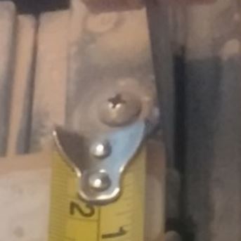

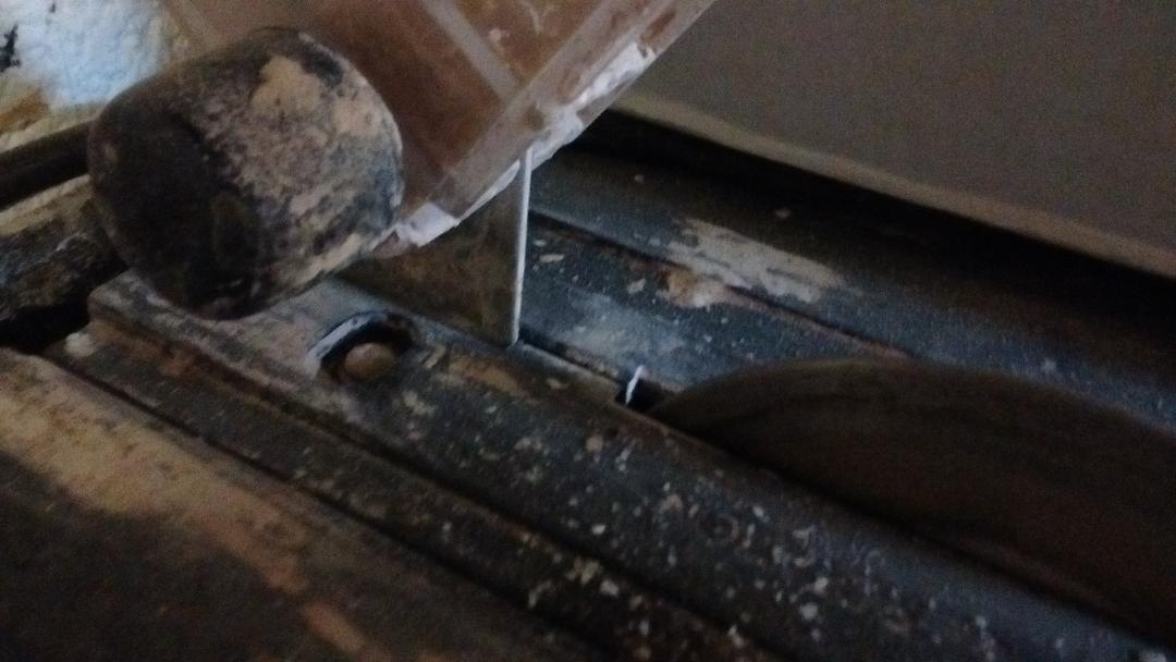

It is as in the pic really, splash guard and it's pretty much stuck in place.
The other thing that is fouling the tile as I try to push it through is the nut that holds the guard in place - top of tape measure, it protrudes so stops the tile going further than that! pretty poor really and it gets decent reviews!!

RVP,
That looks like a "PTC500" tile cutter.
From your image (below) I think it looks as if the screw head is above the flat table top. And the tile is then hitting it. Am I correct in this assumption??
That screw on mine is counter sunk and below the table top.
Below is images of my saw with screw head in a hole.
SFK
OR if you have attached the L bracket properly and the screw is flat, then I would say that the L bracket is not flat/level behind the Saw Blade.
So loosen the screw, and move the L bracket so it is directly behind the Saw Blade.
SFK

Thanks all.
I think I've sorted it. The screw had a washer on it preventing it from being countersunk into the table top, no idea why.
I have removed the washer, tightened the nut down so it now sits below the surface like SFK's pic seems ok now.

Washer is far too big to drop into the oblong type recess, would need a much smaller washer.
Guard is a little loose to be honest as the screw just spins and doesn't tighten fully although in a way it's a good thing as the tile slides past the guard now easier.
