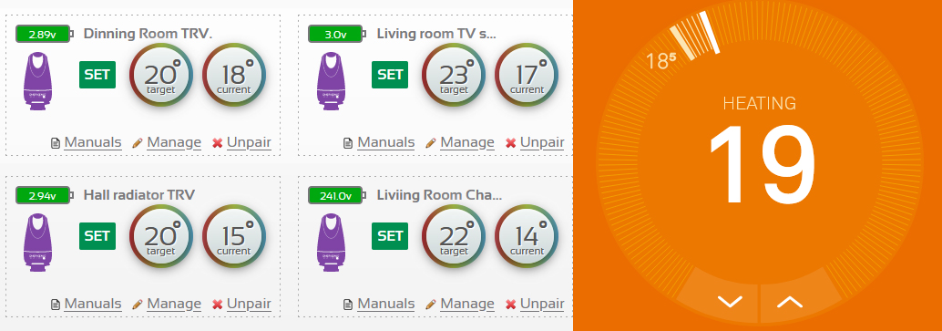

Moving to mothers house, which had doors, and bay window, the big problem was sun in the bay window, so the weather could entirely change the percentage of heat each room required, so Energenie TRV heads were used, the wall thermostat in the hall would only switch off the boiler on warm days, as the hall TRV would turn down first, it worked well, used the TRV read out to set the lock shield valve Heating not keeping up.jpg the current should never exceed target on a cold day, well maybe in theory, but in practice, the sun would cause living room to overheat, but nowhere near as bad as when using mechanical TRV heads. The boiler would modulate, so radiators would just remain warm, and all worked well.
This house, tried the same as worked with others, it failed, the main problem was: The hall cooled too slowly. So needed some thermostat in the main living room, but as with mothers house, sun through the windows was also a problem, so the only option was to have multi boiler activating thermostats, so went for three, a TRV in wife's bedroom, and wall thermostats in hall and living room.
Over temperature is stopped, with 10 electronic TRV heads. As to if this is "smart" control I don't know. Including the flat adds another 4 TRV's and a thermostat.
The whole idea for me, is not to heat unused rooms, or at least not as hot as rooms in use.

Heat raises, so we have found, once heating is turned off, upper rooms stay warmer longer, so my bedroom above the living room stays warm longer than wife's bedroom above the dinning room which is hardly used so set to 16°C.
This leaves me with a real problem, not helped by the radiator and so TRV being against the outside wall, so the TRV is actually colder than the room in general.
The question is, how far to go? I know if I fit a wall thermostat linked to the TRV in my wife's bedroom, it will stop the boiler being turned on prematurely, but if I fit one, will it save the cost of the wall thermostat?
OK, we all know now, putting radiators on an outside wall is not best practice, but to fit linked sensors/thermostats, or move radiators is expensive, so is it worth it?

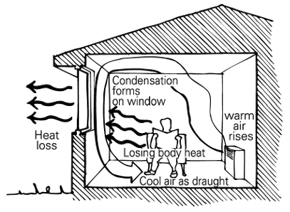

The diagram circulation.jpg looks good, but it takes no account of energy transferred room to room, it shows how the bottom of the radiator monitors temperature of return air, so the TRV is likely in the best place to monitor the whole room.

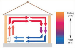

The textbook loves diagrams circulation2.jpgbut in real life, place thermometers around the room, and it quickly becomes clear, it is not that simple, we get a cool zone around the windows, if we don't circulate the air too much, specially with curtains drawn.
