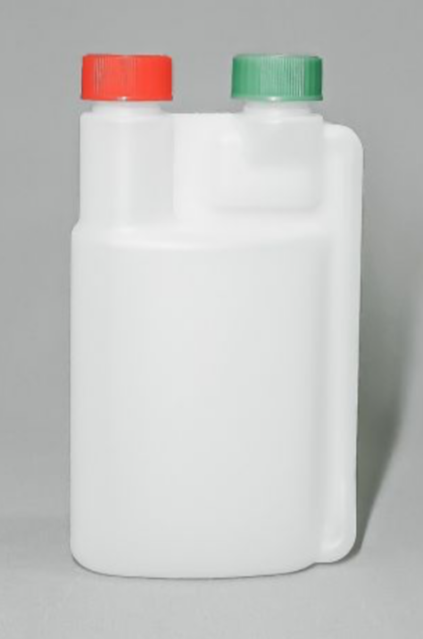

I used to have a dosing bottle, which was useful, but it wandered off..
Oil lives in the bottle and refilled via the red cap. Controlled amounts are dispensed by slackening the green cap and squeezing the bottle to force oil into the small green chamber, which has measurements on, then poured out of the green hole into the Jerry can..
