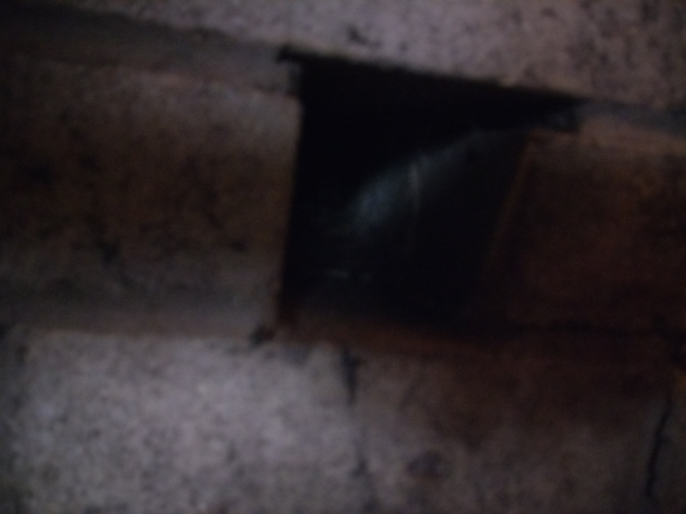

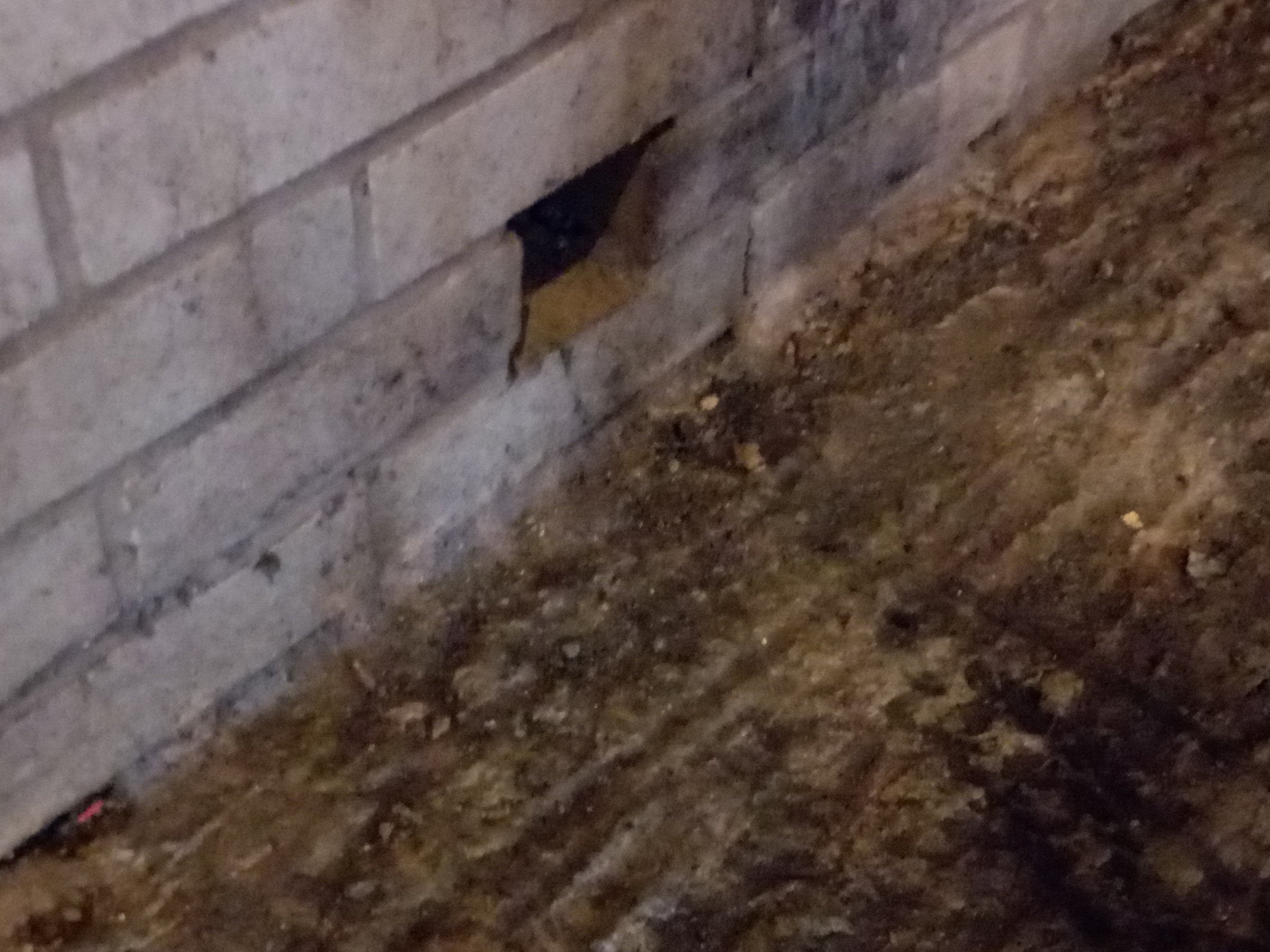

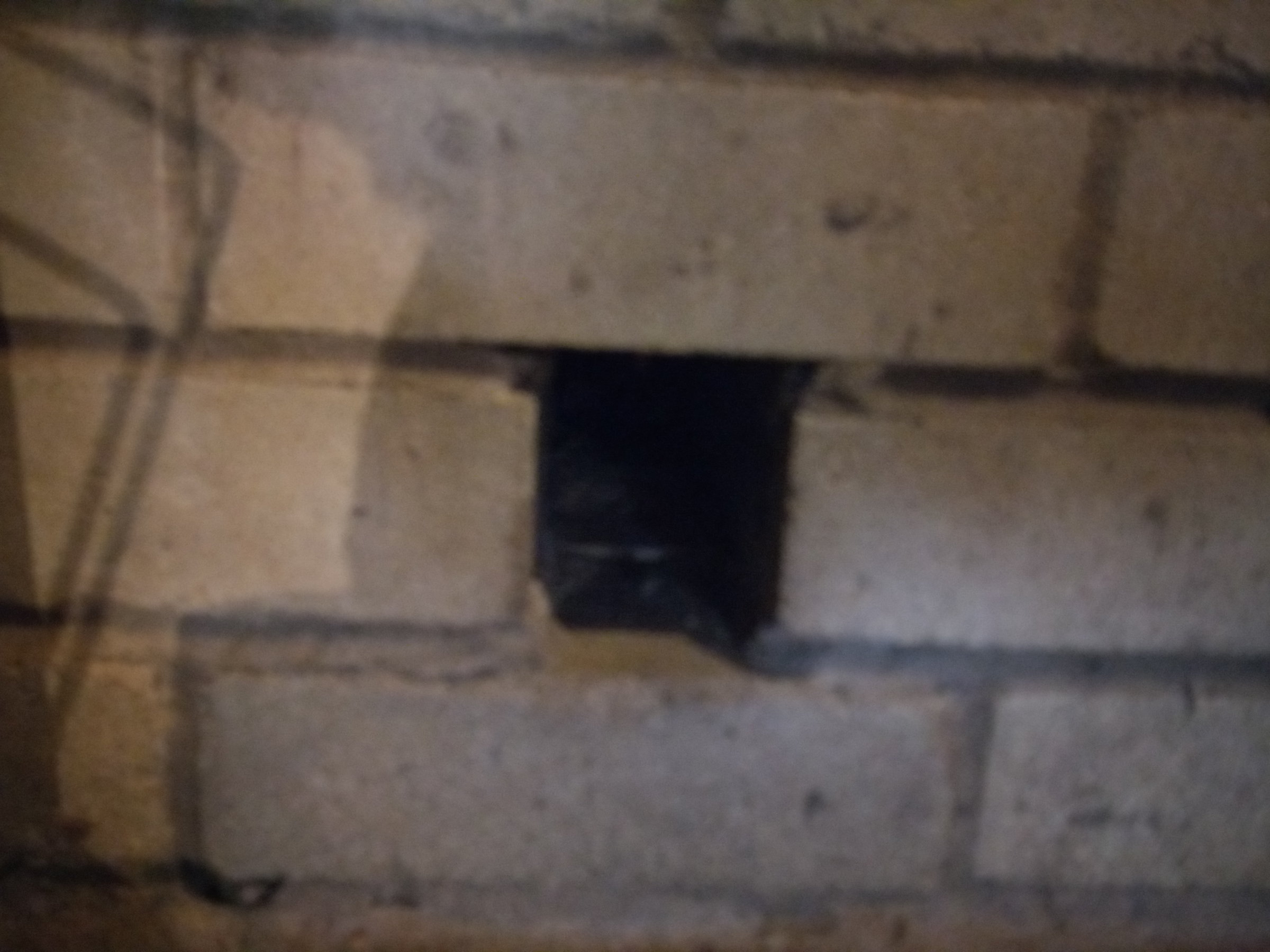

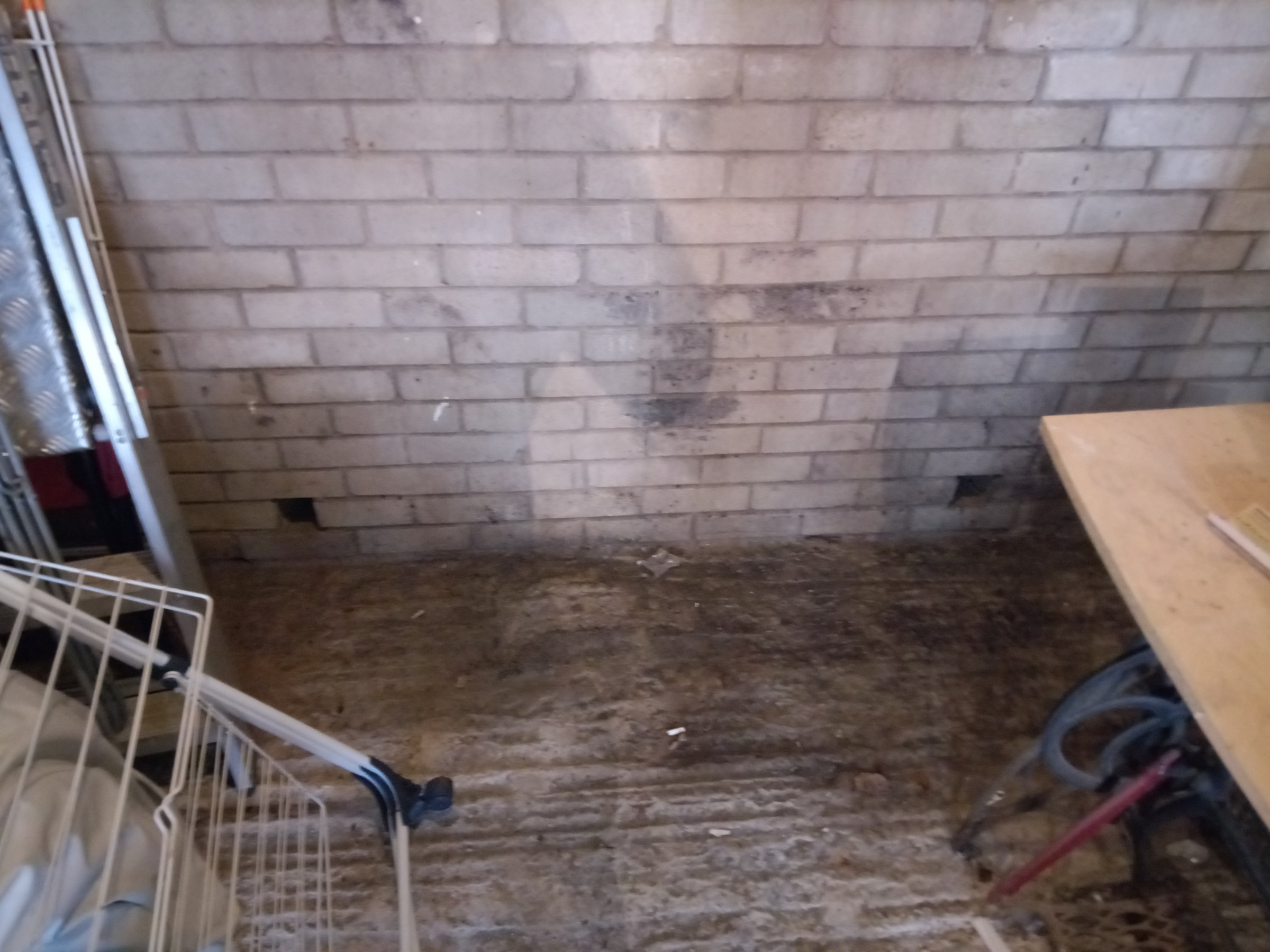

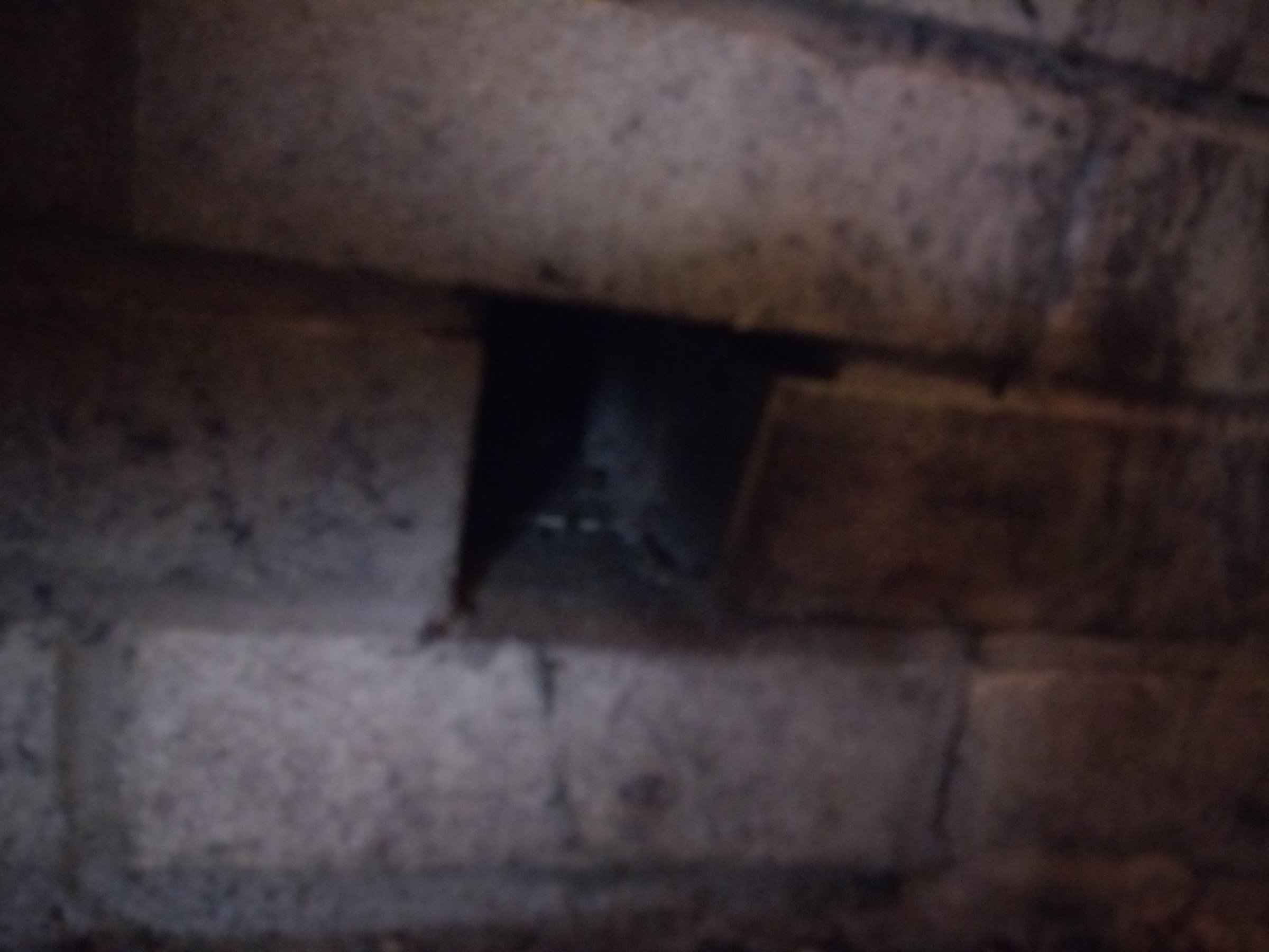

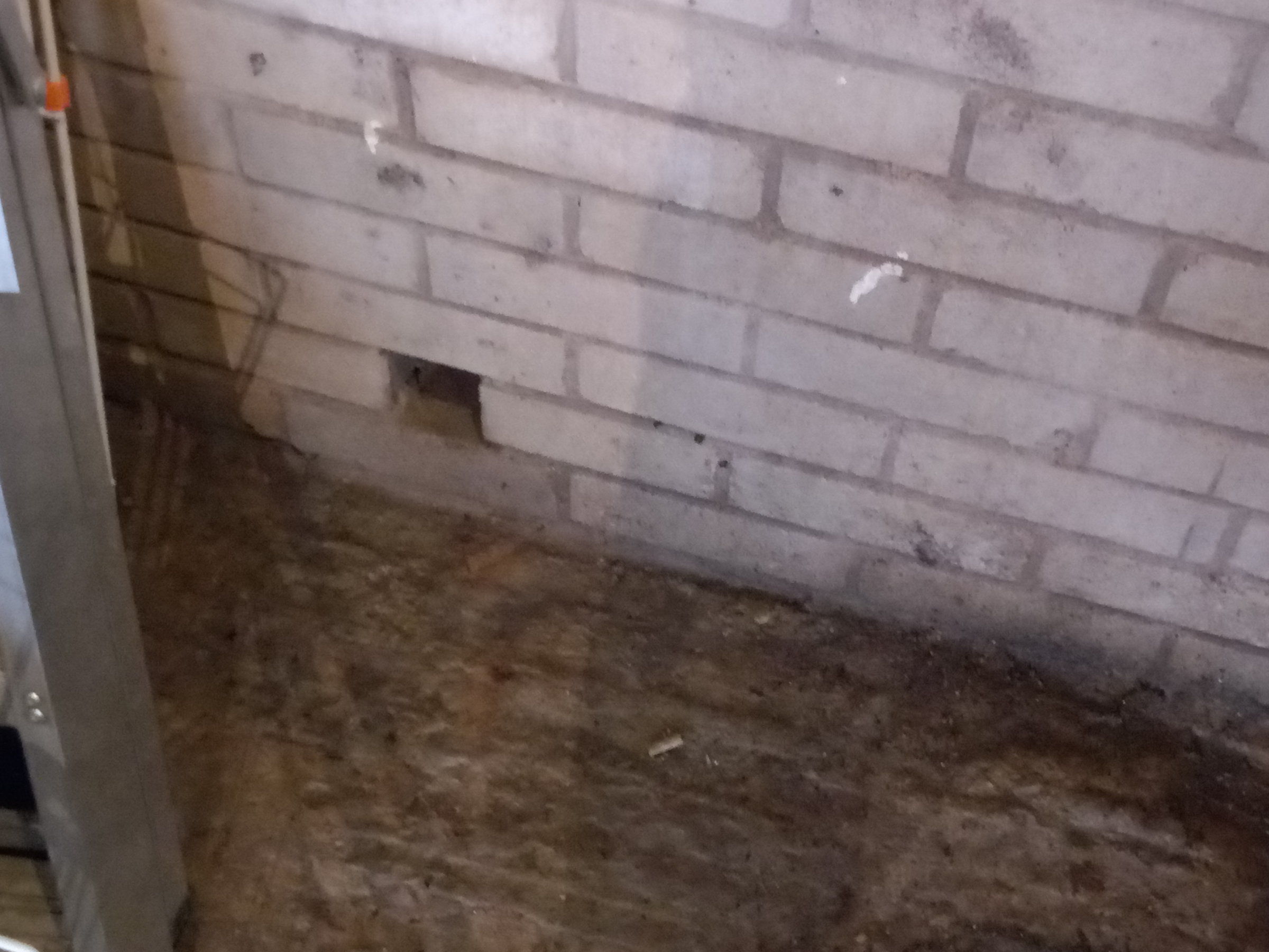

Hi all, I'm wondering if anyone can please shed some light on what these holes are for in my wall at the back of my garage?

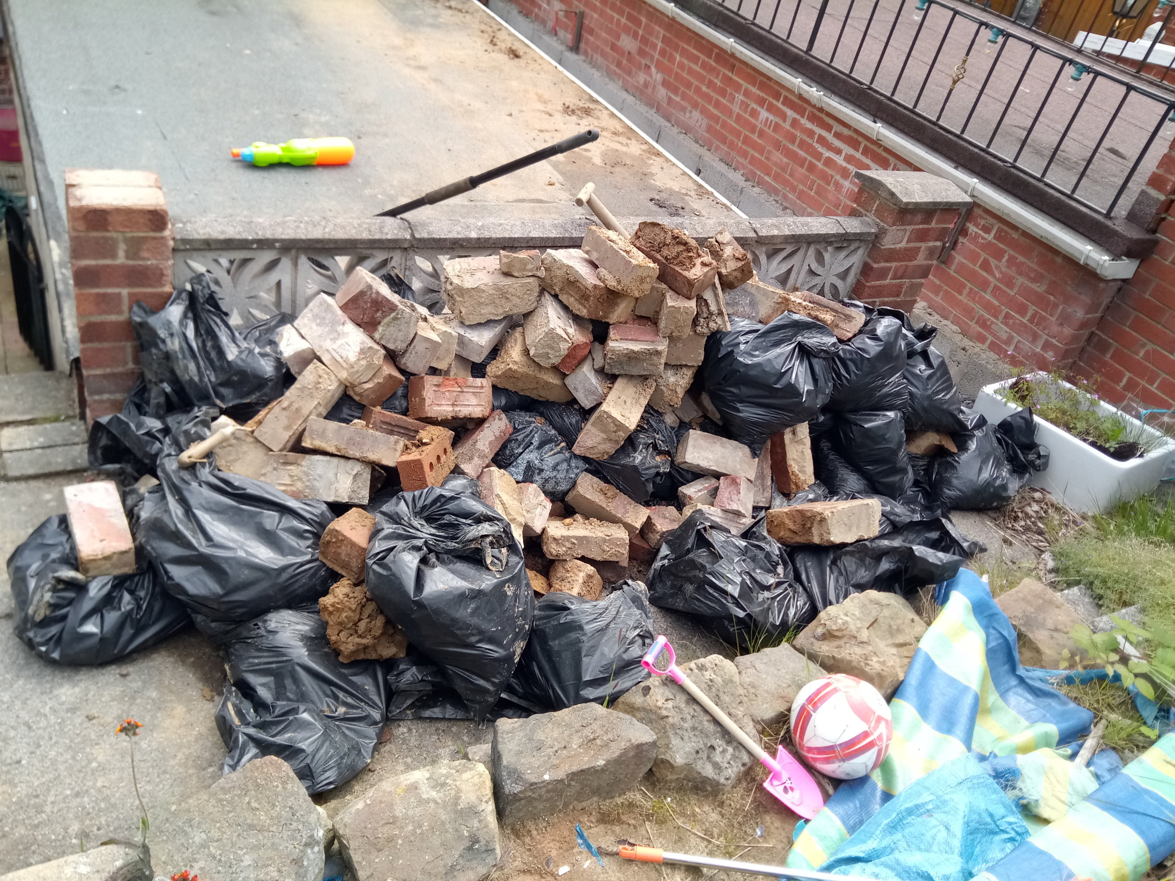

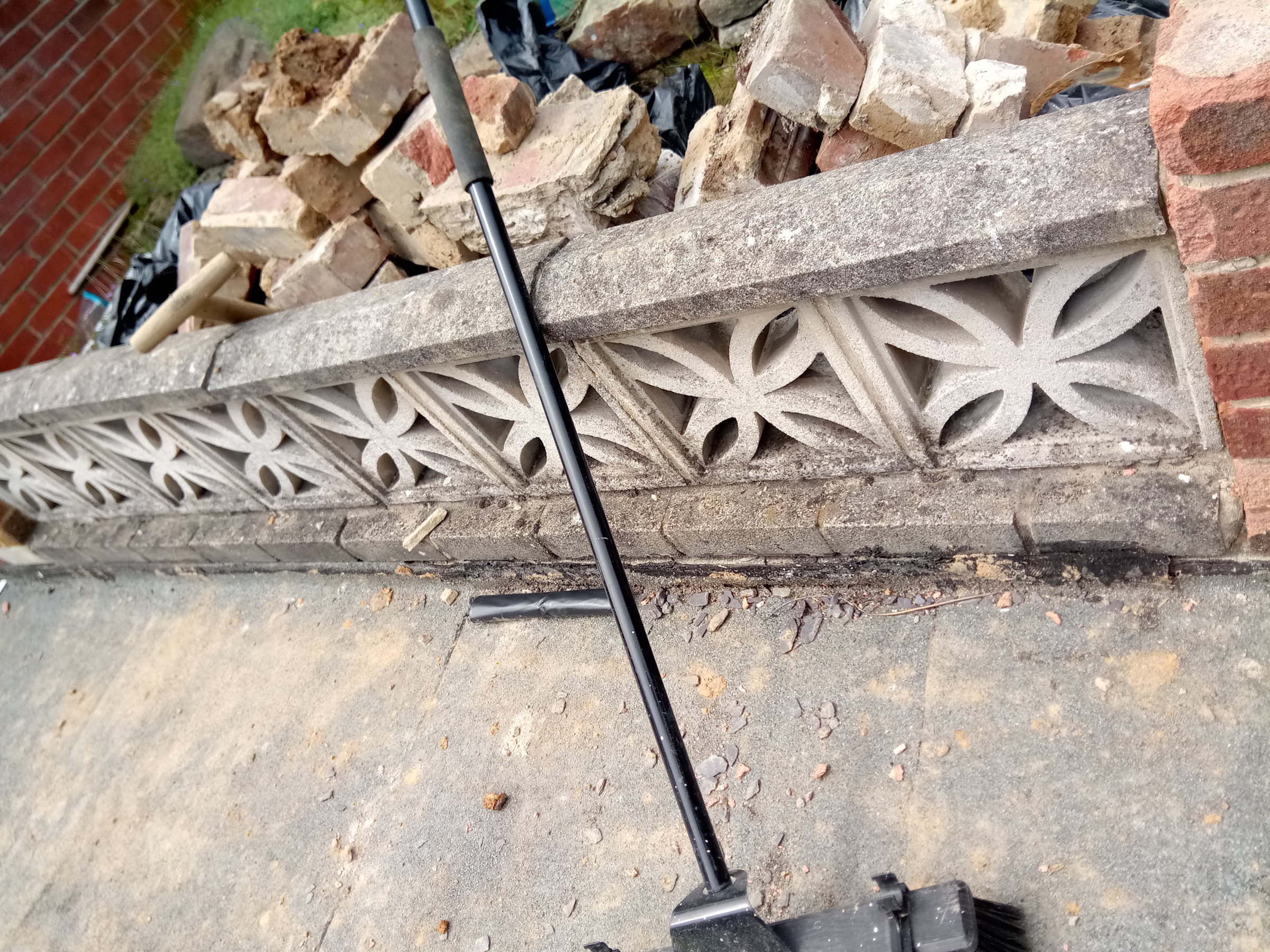

The wall is a retaining wall for a raised bit of the garden (there is concrete above it so I'm not exactly sure at what point the concrete ends and the earth begins.
I've posted pics of whats above the wall, all rubble is temporary as I've dug out a load of it that was left down the side which is another story.
I thought the holes could be weepholes, but they look pretty large and draining water into a garage seems like a bad idea? They look to be a brick and a half deep and then I can see what I think is rock/concrete. I'd like to make the garage into a gym or something but wanted to find out what these holes were before filling or attaching anything.
Bill
They will be weep holes because if water builds up behind a retaining wall, it increases the lateral pressure on the wall considerably.
As for them discharging into the garage, probably originally seen as the lesser of two evils...?
Thanks Tony, I'll leave them well alone it that case. If its the lesser of two evils I guess any other ways of rerouting the discharge would mean a lot of digging or running a pipe from the weephole?
