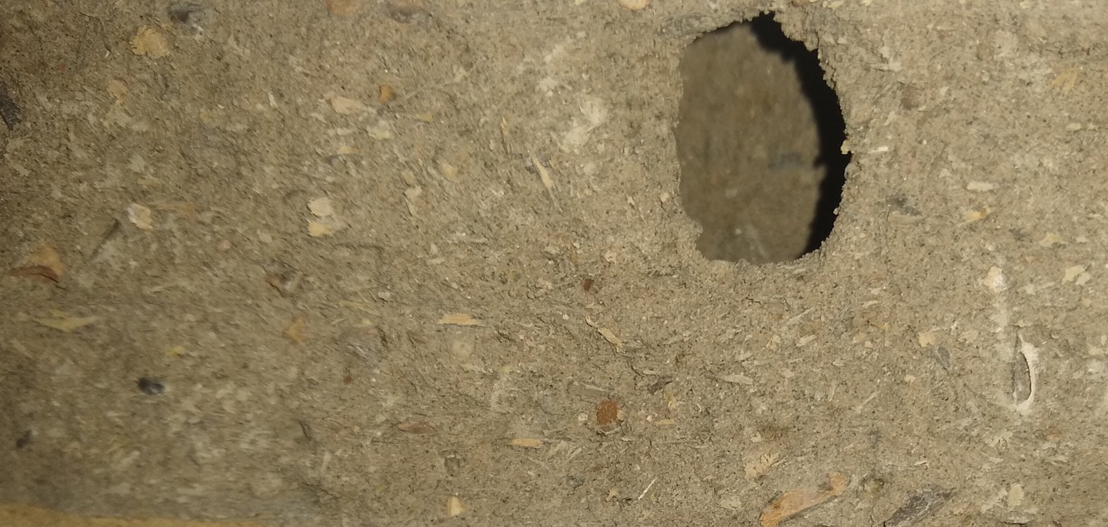

What building material is this?
27 Sep 2011
840
28
Anyone have any idea what material this is? Pic attached
Trying to fit backboxes in this material is a nightmare as it is crumbly, weak and at times, it feels like wheat.

I have to admit that i have never heard of this material before. Learning all the time.
However, I am stunned that this was used in the inner leaf of my cavity wall. It's absolute crap and it explains why i had some nasty cracks in my walls

Have you got an unusual construction house ? I recall steel framed houses with that on most inside walls - the outsides were originally tile hung with concrete mathematical tiles - maybe yours has had a brick skin outside ?

Outer leaf is constructed with brick
The inner leaf is where things get interesting
The wall is constructed using a mix of breeze block, solid concrete block and stramit board. I assume this was done to keep costs down. All of these materials are very thin. As a result, I have avoided using 32mm back boxes
The wall is also insulated with the use of polystyrene
Would this be considered an unusual construction?
Property built in 1990

Yes , Stramit should only have been used for internal partitions not the inner leaf of a cavity construction external wall. The inner leaf should have been blockwork .
How is the wall loadbearing, is there some sort of structural frame :?:

I cocked up
I went into the loft area and the party walls / internal partitions have the mix of stramit and concrete block
The inner leaf/external walls are not constructed with stramit. It is breeze block and the occassional brick
There is no structural frame such as steel or reinforced concrete etc
So i guess this is a traditional build?
The bricky did a shocking job. There are large gaps in the building material because they never filled the gaps properly with mortar. I will post a pic when i can
:confused: Are you saying the party walls are Stramit , they shouldn't be :?::!: Party walls are not the same as internal partition walls and there wouldn't normally be internal partitions in the loft :!::!::!:

I'm pretty sure there is a modern equivalent (to a masonry wall etc) used now between semis.

On the other side of that wall is another property
It's very weird but true.
Yes, a party wall can be in timber frame construction or metal stud construction but not Stramit construction.
