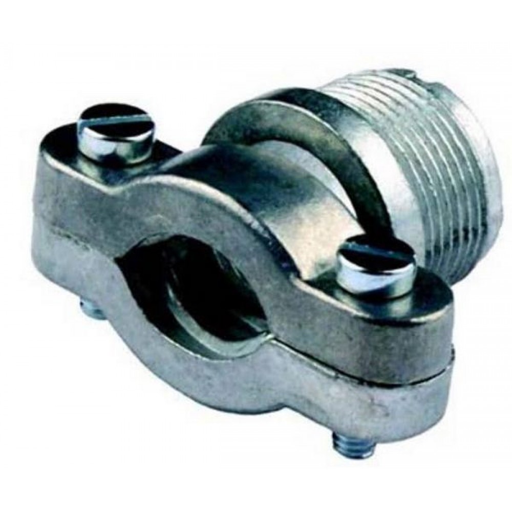

Best bit of advice as they cut the screen wiring as tightened. If your realy do want a brass fitting use SWA gland.I use it often at work, I have built equipment that uses upto 11 core SY cable, we stock upto 24 core.
Used as equipment wire it's OK, when some numpty then grabs some to power an external aircon unit then problems can arise and a proper electrician then has to step in and change it to SWA
At a previous workplace we used to use it for the foot pedal wire to a big bending machine etc. Worked well until a sheet of steel was dropped onto it and then you could easily see the damage.
I have seen (and used) those SY glands with the slot in, don't bother with them any more and just use a plastic gland and take the outer core direct to an earth bar instead.
In this instance the screen wasn't to be connected at this end. At the other end
