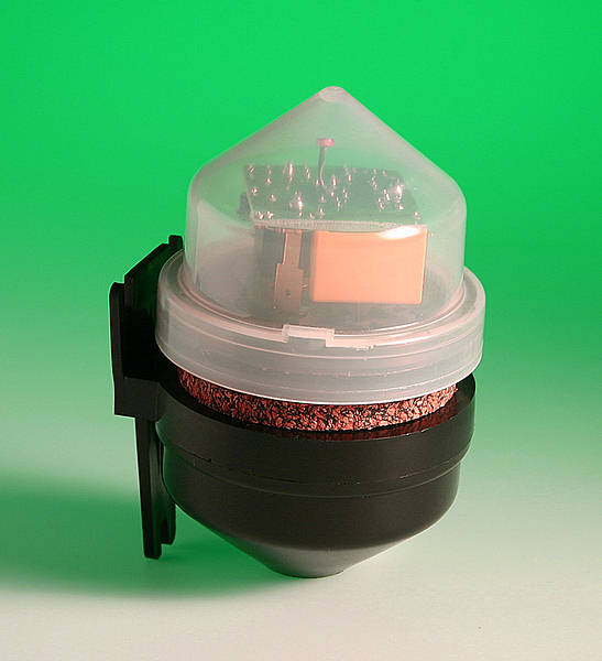

Any chance we could see a pic of the photocell, ive not seen this sort of setup before and im guessing the contactor is a combined contactor and photocell control unit?? If anyone can elaborate for my own knowledge id be grateful :)

If a standard nema socket cell has been used then i cant work out how the contactor side is wired. I have the same arrangement at home switching some garden lighting, and i really think this is all wired wrong. The white T&E is the main in from the mcb, ok so why isn't the black going to the top of the contactor and where does the newer T&E come from, someones been meddling somewhere and it looks like they didn't know what they were doing. Please can you provide a photo of the cell and its connections and the mini cu and its connections.

For those who can't understand what is in the picture:
This is a 3 phase contactor. When the coil of the contactor is energised, the top and bottom terminals are connected in pairs - L1/T1, L2/T2, L3/T3, 13/14.
When not energised, none of the terminals are connected to anything else.
In this example, only half of the terminals are needed since this is a single phase setup.
At the top of the enclosure there are 2 cables entering.
The Grey T+E is the supply - brown and blue cores.
The white T+E is the connection to the photocell - switched live and neutral.
At the bottom of the enclosure there are 2 SWA cables.
The red and blue cores connected to the contactor are the live and neutral.
The yellow cores are earth and connected to the separate block along with the sleeved earth wires from the other cables.
When the photocell is on, this energises the coil in the contactor so the incoming supply on the top terminals is connected to the load on the bottom terminals.
oh ffs...
the white T+E that has the red and black cores is a switched live and neutral from the photocell... it switches the contactor on...
the black goes to the bottom because it's going to the other side of the coil from the red at the top...
the grey T+E is the live and neutral feed from the CU.. they both go into the top because that's where they should go.. think of the top 3 terminals as the Com of 3 seperate one way switches..
the bottom 3 terminals are the L1's of those same 3 seperate one way switches..

The existing configuration is as follows:
White t&e red coming from the sensor and connected to the control of the contactor (top left), the black (neutral) is in the bottom right (behind no 14).
The supply to the sensor is from the 6A MCB, the red is from the MCB (white t&e)and it is really the L/S from the sensor (makes sense).
The Grey t&e is the supply to the light circuits, this is the in power. Brown in no L1 (could be any of the Ls) and blue in L3 (could be any of the Ls)
The 2 reds on the bottom (T1) are the Live for the circuits, and the blue of course are the neutrals.
When the sensor is activated the contactor makes the contact between L1 to T1 and L3 to T3. Light circuits are energized and if no problems, lights will come on.
But the contactor trips, this is because when day light and the power was turned on it will work for a short while and than go off until it becomes dark enough.
I bypassed the sensor and the MCB tripped, I think that this is the result of the snow and a lot of rain. one or more of the connections inside the light polls has a connection problem.
