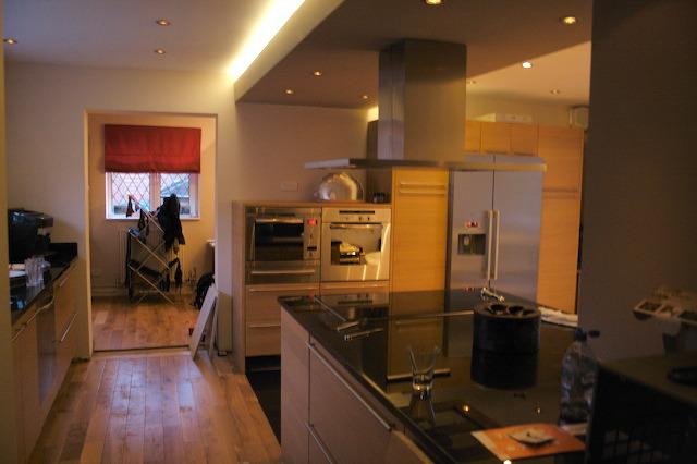

Think if you could use cold cathode neons:
here's an example of that in a domestic kitchen showing that it isn't only suitable for nightclubs and hotel foyers:
