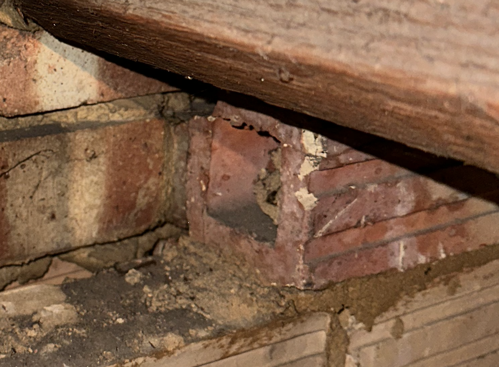

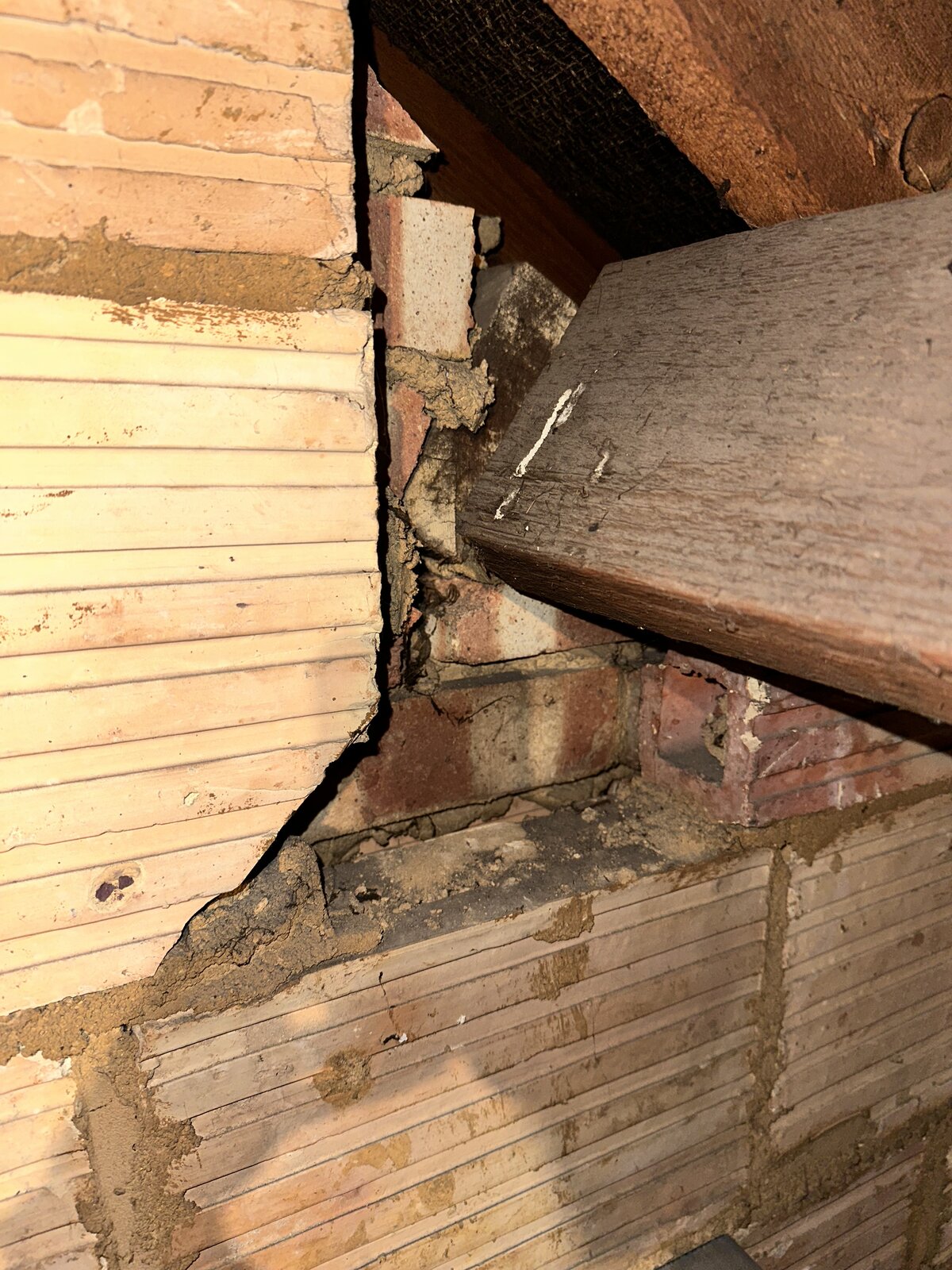

We've undertaken a DIY project to soundproof an upstairs bedroom party wall shared with our noisy neighbours. There's a window on the perpendicular wall so there's only approx 70mm before the party wall would hit the windowsill which limited options.
We decided on resilience bars, sbx boards (boards filled with sand) and a final layer of acoustic plasterboard (total depth 43mm). Unfortunately hit a problem when trying to attach the resilience bars to what we assumed was an aerated block wall but turns out to be some flimsy hollow blocks. Have been told by a friend they are 'pots' but not sure of the proper name. I can't find any further info from googling.
This is a picture of them in the loft and a close up of the middle of one of them where the hollowness can be seen.

European clay pots. Eeeeugh!
Fix into the bed joints.
Can’t see the joints in the bedroom where we’re fixing unfortunately unless we take all the plaster off.
If we were going to take all the old plaster off then would have gone for a glued system instead of fixings.
Extruded clay blocks - hard and brittle.
Is it possible to cut 50mm wide vertical chases in the plasterwork (marking the lines with an angle grinder) at - say - 500 spacings so that you can see the mortar joints, and then screw vertical 50 x 50 battens to the joints. Then fix your resilient bars horizontally to those?
(Though might be difficult if they use a cement-based plaster?).
