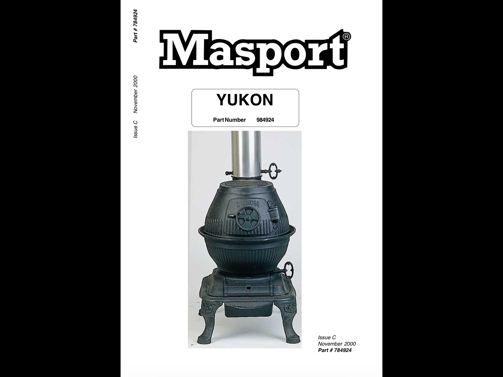

    If I’ve pressed the correct button there should be attached a photo of a small Yukon pot bellied wood burner to be install into a man cave.
    Question is should the flue which will go up through the roof and be circa 2m long be single rigid pipe or a twin walled flexi pipe.
    Thanks in advance of any help 8EE50433-3EF9-4E0F-A3A6-B317D8829ACD.png 8EE50433-3EF9-4E0F-A3A6-B317D8829ACD.png

    Page 7 of the installation instructions might be useful.
    The flue will get very hot and if not properly installed it may set fire to the roof

    Neither, it should be twin-walled rigid, assuming your man-cave's structure is timber. It should also be a minimum of 4.5m tall to ensure the correct flue draught.

    4.5 metres that would take it 2.5m above the roof. Presumably there is room for a pragmatic appraisal of what will be sufficient

    The pragmatic appraisal is that independent testing organisations have carried out many tests on a large number of flue systems, and determined that 4.5 meters is the minimum required to produce an acceptable flue draught. Any less than that risks downdraught and potential carbon monoxide poisoning. I'd suggest that "installing the stove in a manner least likely to cause severe illness or death" is a reasonably pragmatic approach

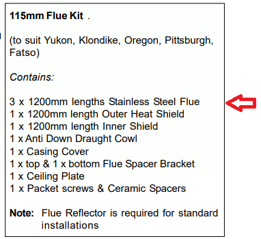

    Flue kit details HERE suggest at least 3.6 metres

    Although it is maybe worth noting that those instructions are 20 years old, but either way confirm that the proposed 2m is grossly insufficient

    And seemingly made in New Zealand quoting their standards, "Following these installation instructions and the instructions accompanying your flue kit will ensure that the heater complies with the requirements of the appropriate Safety Standard AS/NZS 2918."
