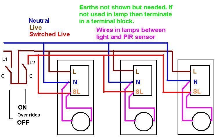

is there a way to fit these in series so when 1 pir detects, they all light up?????? maybe I need a different post for this question?
You ok on the same topic. As I mentioned before, the modern integrated lights with on board PIR often do not provide the facility to gang up additional lights and PIRs.
That’s why separate PIR(s) plus separate slave floodlights works better.
The PIRs and lights would be in PARALLEL, not in series. Here’s one way to do it.
