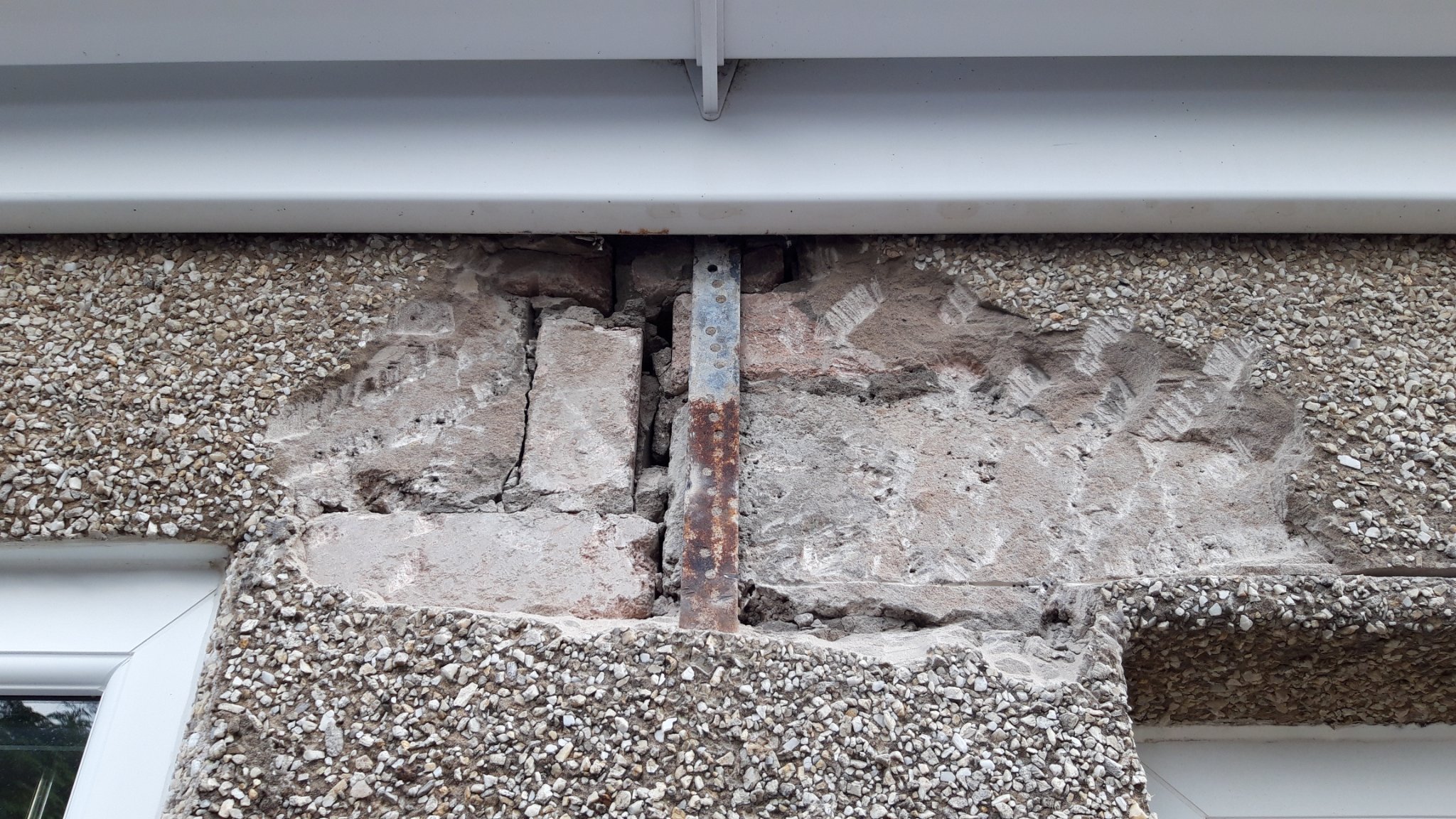

We moved into our house nearly 40 years ago and shortly before that, the previous owners had added a kitchen extension to help sell the house. Perhaps a year after we had moved in, I noticed a small vertical crack in the render above and between the new back door and window. I spoke to a local builder who said it was likely to be due to settling of the structure. He told me to monitor it for widening which would indicate a more serious problem. However, since then, the crack had not widened at all so I left it as I intended to get the outside of the house re rendered eventually.
A couple of years ago we had a new bathroom fitted and the fitters had to run a new drain outside across this area. I was told that when they drilled into the render for fitting pipe clips, the drill went straight through with seemingly no brick behind.
Now we are hoping to sell the house so I needed to get this investigated. I had a builder remove the render and the pictures show what was underneath!
He said he saw no major issues apart from the old loose mortar having to be raked out and new mortar put in. He then re rendered over the area.
I am now becoming a bit more uncomfortable with this as a Surveyer is going to see the patched area and want to know what this is. I can show him these pictures but have an awful feeling he may say that further investigation is required. Any advice very welcome.
I should add that I put some clear silicone over the crack shortly after discovering it.

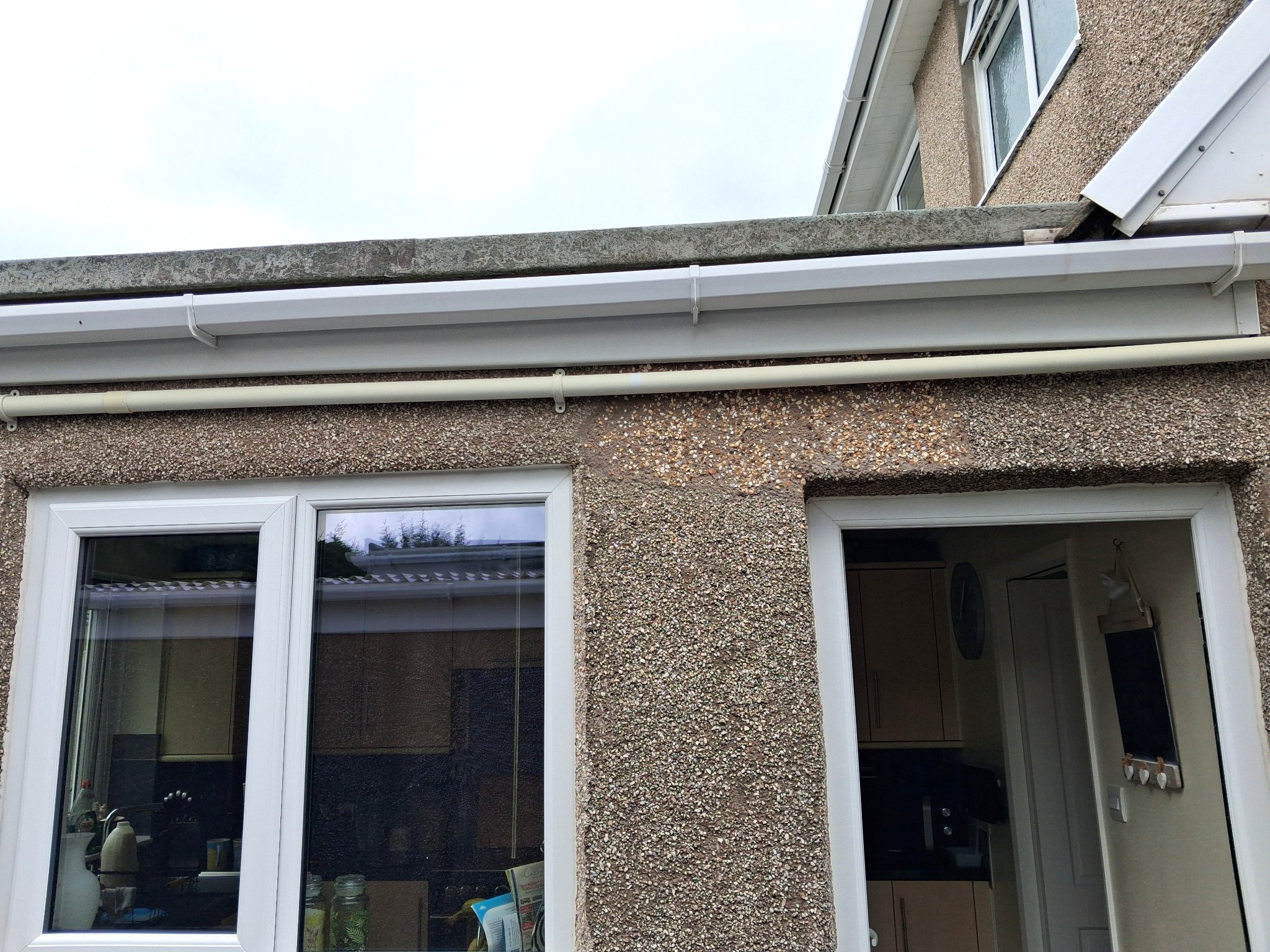

Take a picture from further away showing the repair and the rest of the area

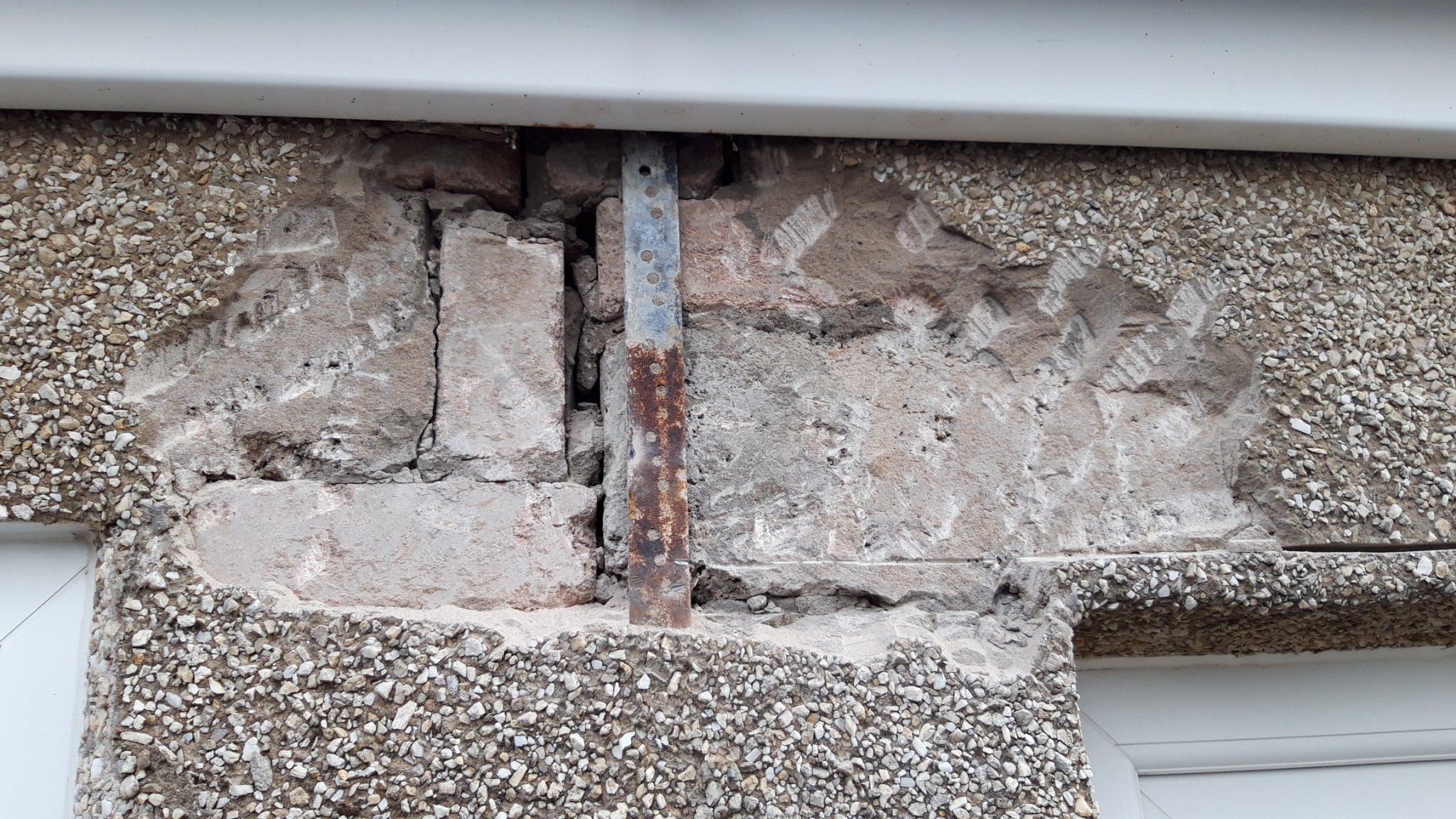

View attachment 423193View attachment 423194
Busy pier that. :oops:
I see two concrete lintel end bearings onto a slender pier, with what looks like a holding down strap down the centre.

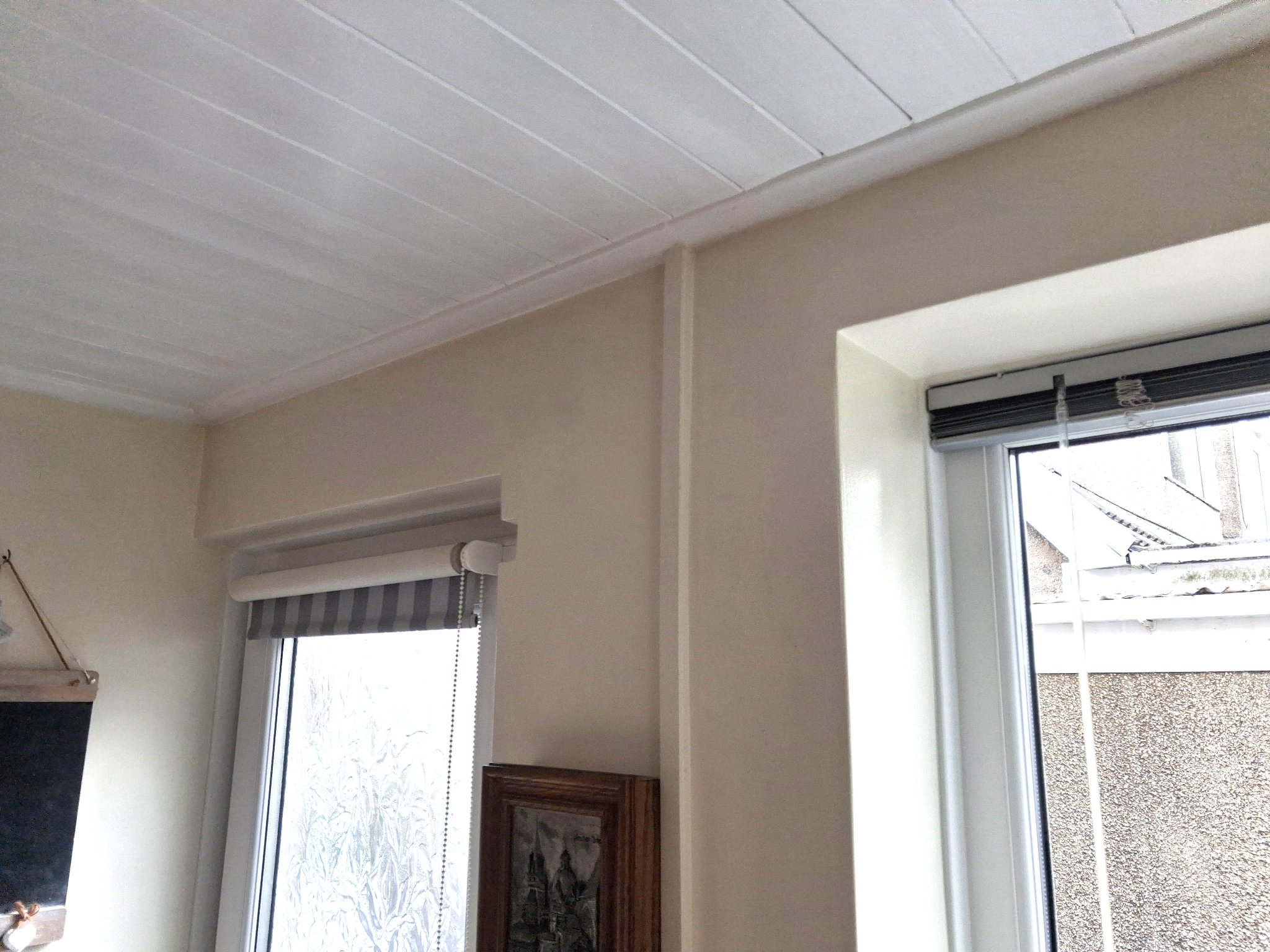

Is that column of masonry (pier) a stand alone structure, i.e. there is no masonry going perpendicular, into the room?
See attached pictures inside and outside of the area concerned.
The slender pier is not ideal, but seems to be holding up. Looks like a bit of movement on an already busy junction has caused the render to crack. Needs meshing over before the scratch coat is laid on.

Galvanised ties shouldn't be used on external walls. Portland cement mortars and renders eventually turn very slightly acidic, which then attacks the galvanising, hence the rust.
If left and just rendered over, the ongoing rust will continue, expand and crack the new render.
You need to coat it with something protective before re-rendering.
Strange place for them to put a tie in the first place.
It's a routine repair as far as any surveyor will be concerned. These occur to every house for many reasons and whilst this one will have a specific reason, the repair is not a reason to suspect anything out of the ordinary.
Yes, any buyer may well employ a completely anal surveyor, but that's a risk for any seller with any repair on a 60 year old house.
Thanks for the replies. I have since found out that the extension was actually built in 1980 so it has stood up for 46 years. I may get the repair tidied up by another builder at some point as I am not happy with the way it looks at the moment.
It looks absolutely fine. Nobody can invisibly repair pebbledash, even if you still had the same gravel and sand as used back then it would still be a different colour.

As others have said, that lump of metal is the issue. No idea what its purpose is, but it's not your problem.
I assume the tie is holding the roof down. It should have been fitted inside, but I guess the builder thought it was OK to put outside as it was going to be rendered. If so then there are probably another ten patches waiting to blow off.
The only guaranteed fix would be to move them all inside, which would be a mammoth job.
