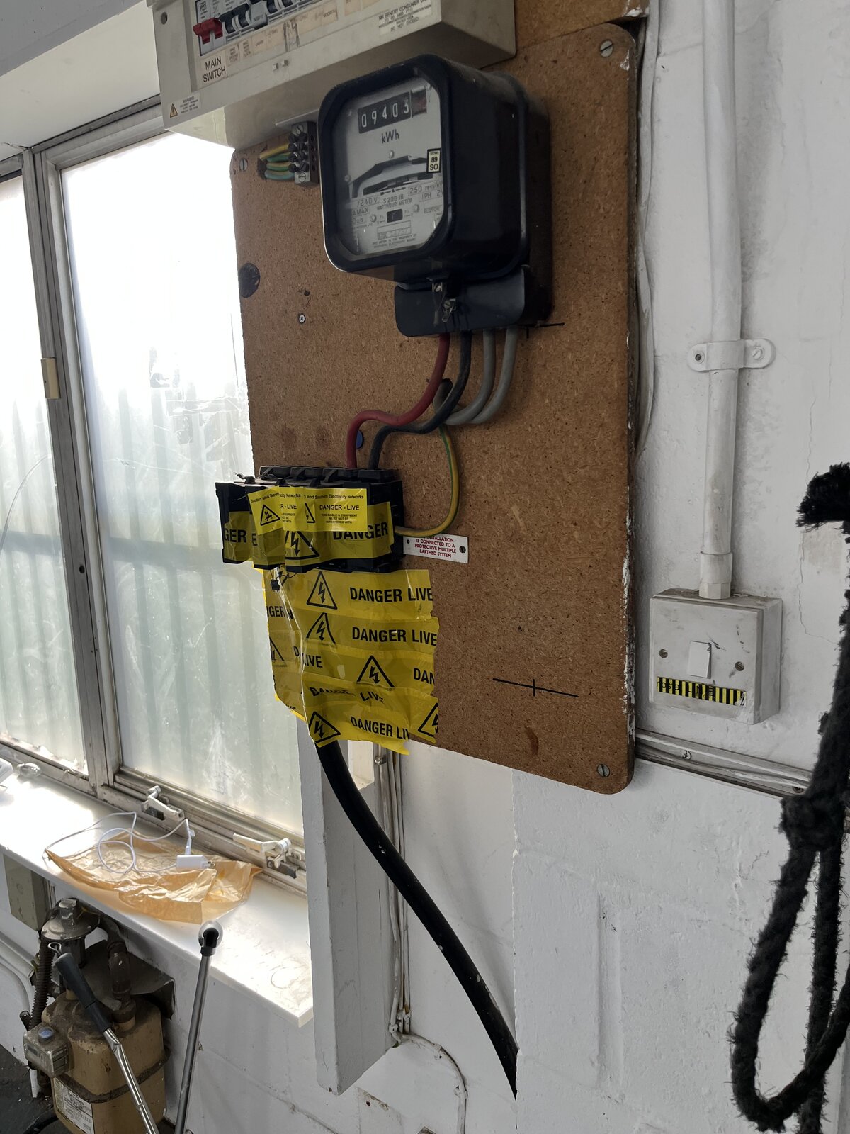

What has tenant done to the electrics?
Status
Not open for further replies.

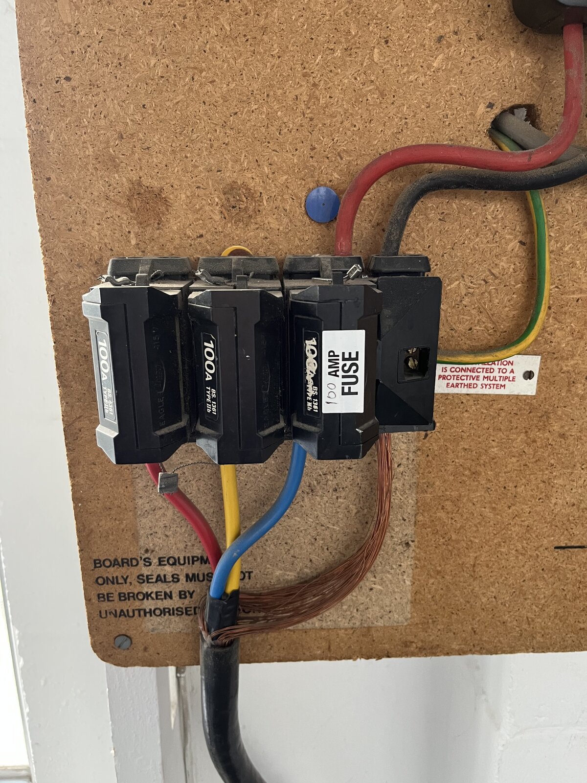

I went to the property this morning, was chatting to a neighbor who happened to be electrician, had a look and pulled the black wire. People here were saying it’s dangerous. Arcs, explosions and flipping PPEs. Obviously no power now , SSE will be here soon.
If it was done under load there would of been an arc , it doesn't make people unprofessional to advise you safely.
So was it just poked in there?
I was going to 'mention' that possible approach. With the main switch of the single CU 'off', there would be no curerent through that link, and hence no risk of arcing, so all that really would be needed would be appropriate PPE (gloves), or ('extreme care/caution'!) to avoid any risk of contact with live conductors.
At least this confirms the reason the link was there - and I imagine that there is now actually little/nothing left for SSE to do, other than replace the fuse.

All sorted Fuse changed
Another booking next week to put cover on.
So what did they say- and no, I am not a professional electrician, but I am intrigued to find out what they said.
Given that the 'link' wire had seeming been 'pulled out' before they arrived,there was presumably little for them to 'say about', other than to wonder what it was that caused the fuse tio blow (and, unless the previous tenants reveals that, we will presumably never know).
