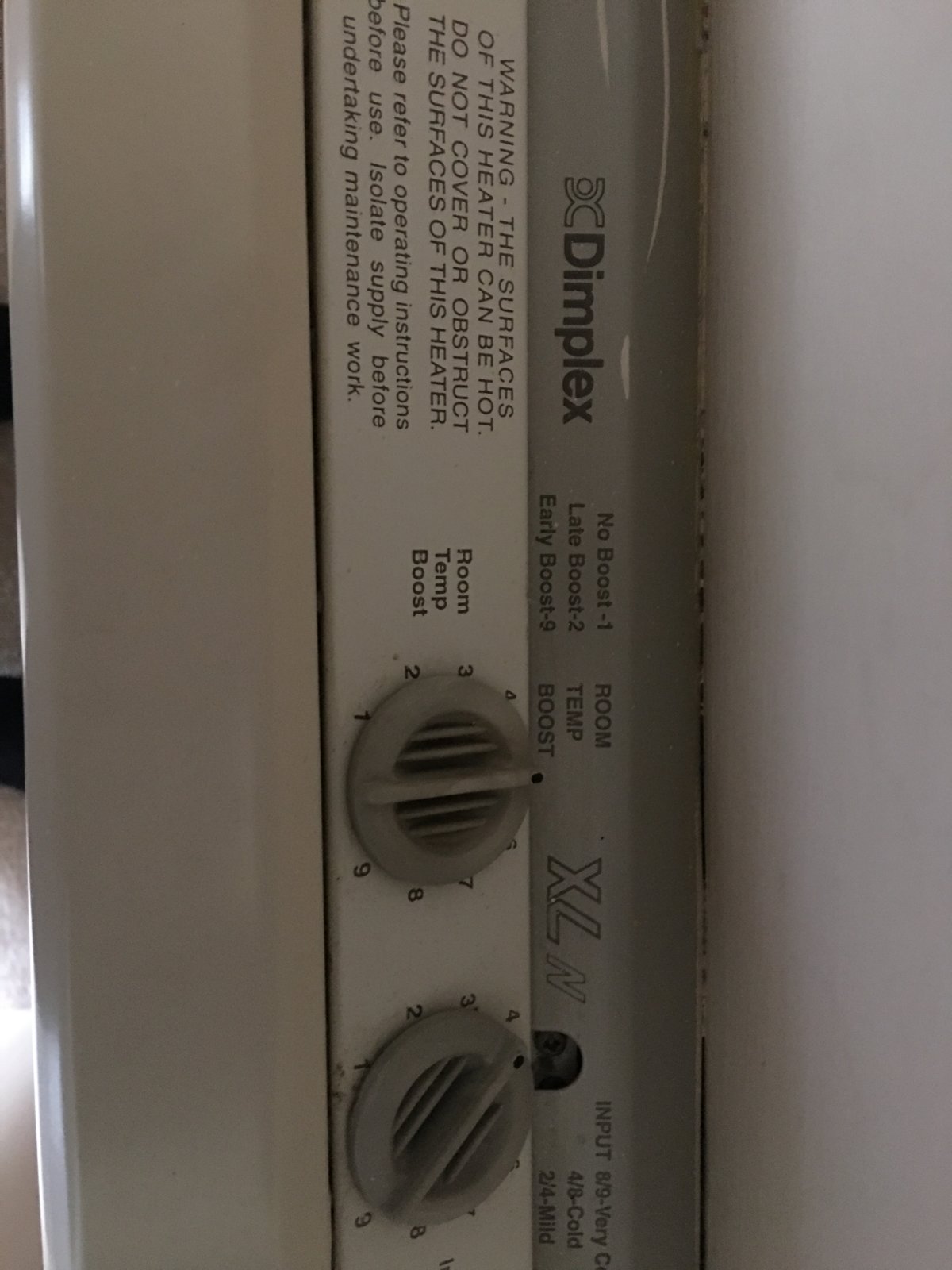

A storage heater in the flat I rent out has stopped working. The tenant left today and didn’t mention it. It was fine 2 weeks ago when I did an inspection but I noticed there was bedding etc drying over the top of it - could that have made it overheat and blow a fuse? The other heaters in the flat are fine and are on the same ring.
They do have thermal fuses that trip if the heater overheats, and need to be reset, but it varies from model to model. What is the make & model of the storage heater?
It would be unusual for storage heaters to be 'on a ring'. They are normally fed individually from a separate consumer unit that is only powered during the 'off peak tariff'. [If the other heaters are not storage heaters they would be on a separate circuit that is not subject to the off peak time restrictions.]
Maybe the isolator has been turned 'off' at some point and not switched back on before a charge period.
Storage heaters do fail, and as you point out, it shouldn't have been covered up. Normally words to this effect are written on the top somewhere. But I would be inclined to check first by leaving it on overnight to make sure that it hasn't just missed an overnight charge.

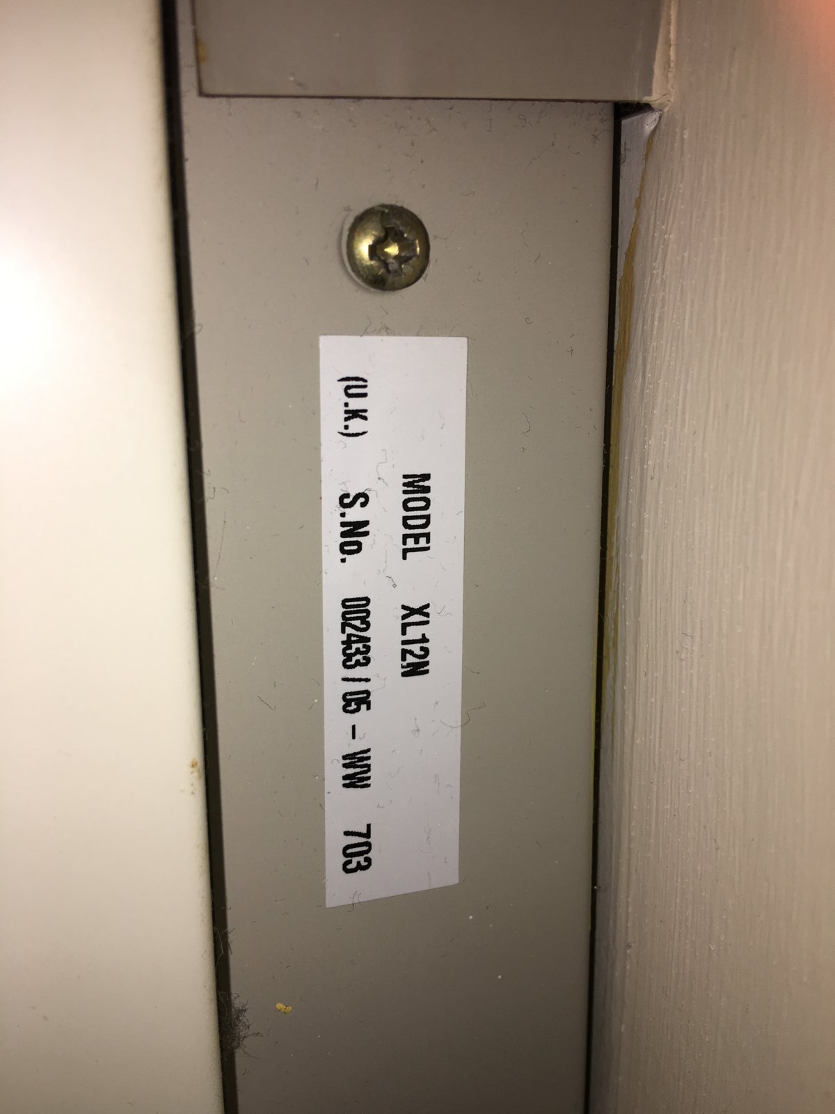

7A7AC53E-48C3-458F-9F44-91B2DB51E1FC.jpeg F4B154BC-CBE8-4EB5-A850-4BF44E651004.jpeg

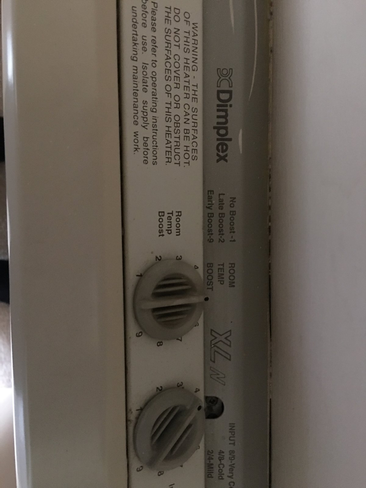

I’m attaching 2 pics of make & model.

Thanks. It didn’t look quite how I expected when I took the cover off but I clicked something and it heated up :)
