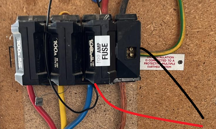

I went to the property this morning, was chatting to a neighbor who happened to be electrician, had a look and pulled the black wire. People here were saying it’s dangerous. Arcs, explosions and flipping PPEs. Obviously no power now , SSE will be here soon.
How much did the advice you received on here, actually cost you?
Being on site, is a thousand times better, than making a diagnosis from descriptions and photographs.
Must have been a solid short to cause that fuse to 'blow'!
Or were the tenants growing lots of something?
Must have been a solid short to cause that fuse to 'blow'! .... Or were the tenants growing lots of something?
If they were, they must have stopped growing it after the fuse blew, since they would not have got much current 'for groing' through that puny little bit or wire :-)
As I wrote earlier, one of the easiest ways to blow a cutout fuse is by injudicious 'fiddling' with the live system resulting in a L-N or L-E 'short circuit'

Not only was the advice correct, but it was diagnosed correctly too, in that the fuse had failed, and been botched with a random bit of wire.

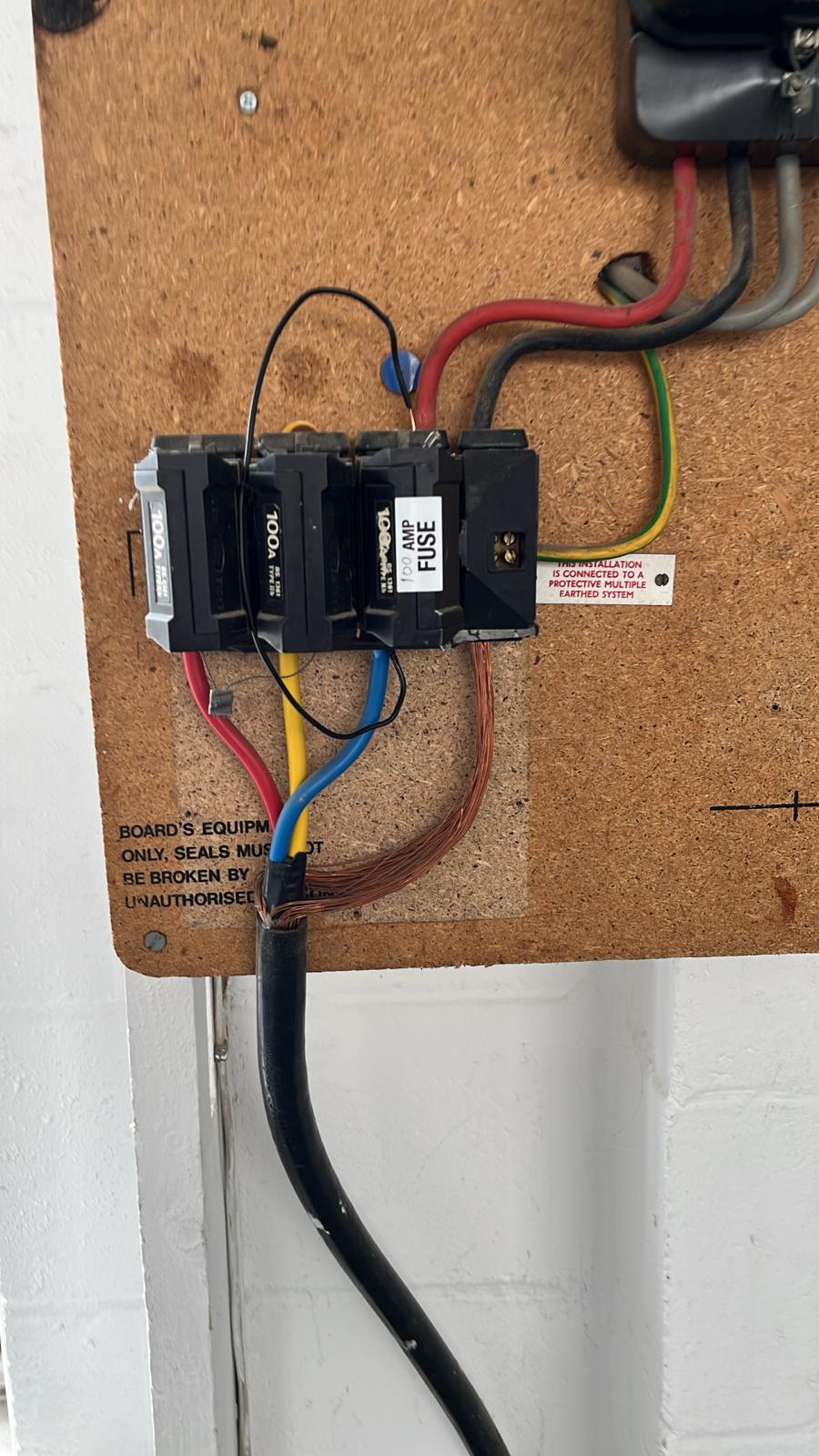

Now the OP thread has basically finished. There are 2 things here that strike me:
1, the before pictures does not have a fuse lable, so DNO/Energy provider have attended inbetween times, and
2, both halves of the cover have been removed, whereas only the front would have been necessary.
The more I think about this, the more I wonder if if something like this was taking place
To steal electricity and some arcing evidence was left behind
