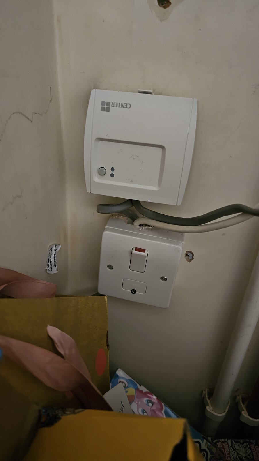

I look after a rented house for my Dad, long story short: we had been using a plumber who has since been found to have ripped us off. He fitted this receiver and room thermostat around 6 months ago. Its blown up already and id imagine its because of how cheap it was - plumb center is like happy shopper id guess? sounds like it blew last week, tripped the electrics and the heating hasnt been working since.
Anyway, we need a new one, can anyone suggest a brand that should be a straight swap? one that will last 5 minutes preferably
and is there anyway to override this for such instances? theyve currently got hot water but no heating so it needs fixing ASAP
its for a baxi duo tech but im not sure of model, its 12 years old
thanks

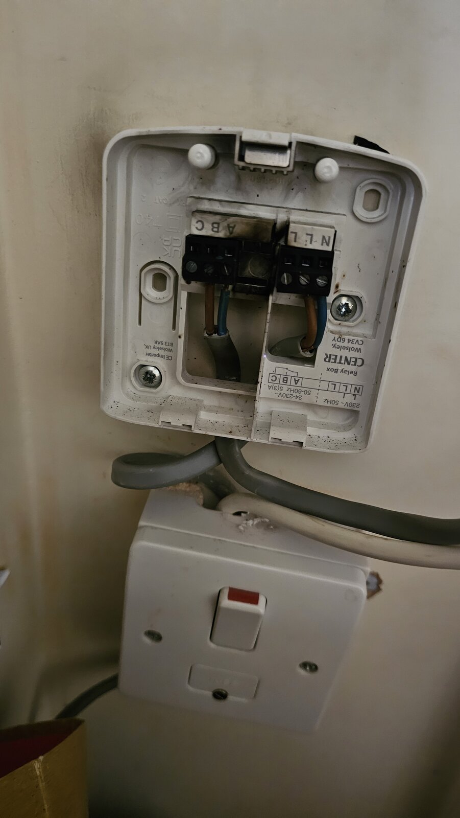

I'm afraid this may need some further testing.
To me, the charring around the relay outputs of the thermostat, suggests it switched a dead short - blowing up may not be the fault of the stat or the wiring; but something further down the line, like the zone valve.
Do you know what sort of C/H system you have?
And you mention it tripped the electrics - what exactly tripped, an MCB, or an RCD?
Center brand aren’t too bad tbh and that one is made by Honeywell. I’ve had the same problem with some of our properties so unfortunately the plumber can’t be blamed for this one. I did send 2 of ours off to Honeywell for investigation but they couldn’t really provide an answer. Maybe get him back if you want as it should last a reasonable amount of time, he shouldn’t charge you extra and claim his money back from Wolseley. Definitely worth getting a different brand, although I think it could have been a faulty batch as we’ve got loads of Honeywell/Pro brand thermostats fitted and only around 4 failures that i know of.
The Baxi Duotec - you should be able to use a link at the boiler or join the 2 switch wires from that receiver into a connector block and use the selector switch on the boiler for heating - turning to hot water only to turn off, unless you have a time switch/clock?
Thanks mate, what do you mean by type of CH? it's not a combi i don't think, do you mean sealed? It tripped something on the board, the tenant flucked the MCB back I'd guess

connections have been arcing from not being tight enough

That fault has got nothing at all to do with the boiler it definitely a stat fault and i would say connection A as the screw doesnt look like its been screwed in enough
