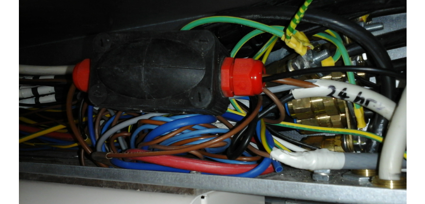

What is this - an external isolator?
That's an easy one to answer, just go back 4 posts to #68

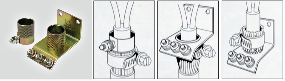

All of a sudden I've found the link to this sensible alternative to the brass gland, these are zinc passivated brass fittings and can form the MET in an enclosure depending on the quantity of earth wires required.
I'm not trying to say these are suitable for pics in OP, in fact just the opposite.
All of a sudden I've found the link to this sensible alternative to the brass gland, these are zinc passivated brass fittings and can form the MET in an enclosure depending on the quantity of earth wires required. ....
Interesting. I've certainly never seen anything like that, although I have seen some (I imagined you would call 'botched') jobs that have done ad-hoc things (with earth clamps, jubilee clips etc.) that attempt a similar concept.
However, other than for the three termination points, what advantages do you see this offering over a 'proper gland'? On the downside, it seems that they will take up a fair bit of space within an enclosure, probably usually/often requiring a much larger enclosure than would be needed with regular glands (e.g. in the example that Rocky posted in the other thread)?

My apologies, I forgot this is not Rockys thread, It's those boxes I meant to say they would not be suitable for. However in the case of the SWAs where the armour has been terminated in the trunking these would be far more suitable and a fraction of the cost.
Interestingly you mention enclosure size, this arrangement is very commonly used in street furniture where space, or more correctly access, may be limited.
Unless I'm misunderstanding, the whole of one of those things has to be accommodated within the enclosure, whereas with a standard SWA gland, only a tiny bit of it is within the enclosure - which surely means that the SWA glands are more suitable if space within the enclosure is limited?

The CET devices are not designed to be correct for every job, just as brass SWA glands are not.
think about this one of Rocky's: .... And that big ol' lump of brass glands/banjos filling up the trunking.
Sure - in that situation (with the entirety of the glands within the enclosure' {trunking}), the alternative approach might well take up a bit less space.
However, I was obviously talking about the 'normal' situation in which ~95% of the gland is outside of the enclosure, in which case it's fairly obvious which requires the least space within the enclosure.
