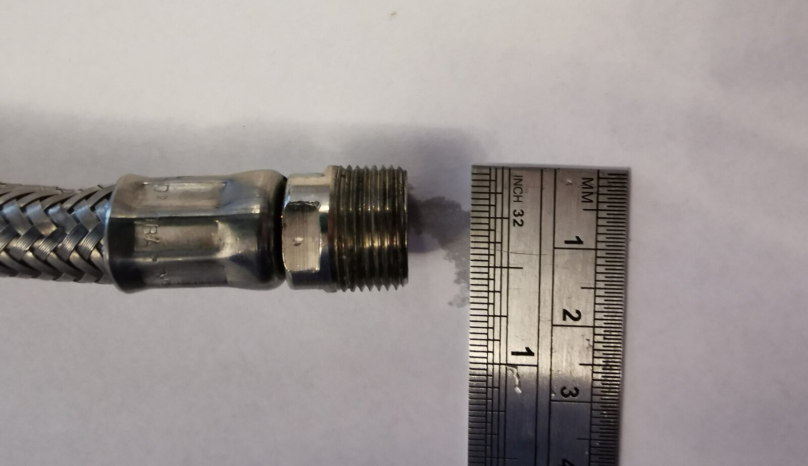

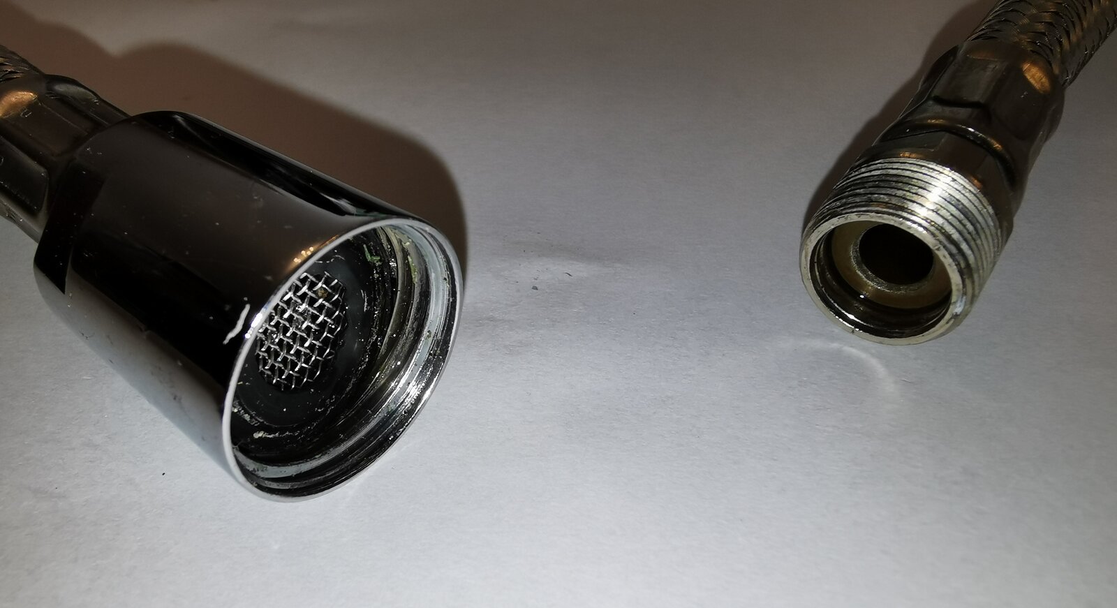

I've got an overly complicated tap, which has a flexible hose that has started leaking.
One end is a simple 15mm (or more probably 1/2" now I think about it (n)) female screw connection the other is a male thread, I think it's an M14 based on the measurement (it is around 14mm, or a hair over .5") but this seems odd, unusual and I couldn't find any, let alone one long enough (approx 82cm). Can anyone help me in my hour of need?

plumbing threads are often BSP
the name of a BSP thread is not the same as its actual measurement.
for example, a 1/2 Inch BSP thread measures 20.99 mm / 0.825" diameter and has 14 threads per inch.
1/4 Inch BSP measures 13.16 mm / 0.518" diameter and has 19 threads per inch.
The thread is often tapered so it measures smaller at the end and gets bigger, so it gets tighter as you screw it in.
please measure yours (precisely) and count the number of threads per inch.

14.7mm outer diameter for the male thread.
19.22mm internal diameter for the female thread, but i probably got that completely wrong, measuring internal diameters is trickier. I'm confident it's standard 1/2" BSP as it's the same as another tap connector (for a different tap).
Thread count per inch is beyond me, I'm a metric system person, inches and verniers is two leaps too far. :(
Yup, standard sizes for 'pull-out tap replacement hose' are male M15 and female 1/2" BSP.
