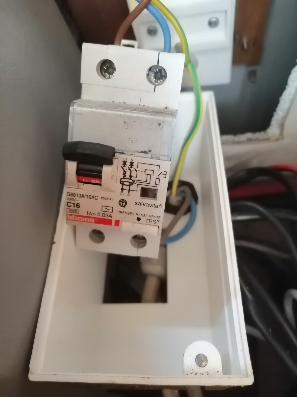

what is this in my campervan?
26 Feb 2005
2,817
145
Gwynedd
sorry for the thicko question....I don't do electrics if I can help it. is it an rcbo? in other words does my campervan have rcd protection?
I think it is a RCBO but it's hard to be 100% certain because when I google the part number all the results seem to be in Italian.
I found a page on the Manufacturers website for what looks like a newer version of the same device and google translates the description to "Differential magnetothermal switch BTDIN60 1P+N type A - In= 16A - Idn= 0.03A" That sounds like a RCBO to me.

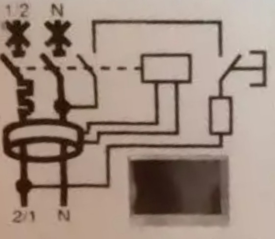

The numbers and diagrams on the front of the unit also seem consistent with a RCBO.
The RCD component seems to be type AC, which is not compliant to the latest amendment of BS7671.
I think its an RCBO too.
For me, the giveaway is the C16 - suggesting a 16A over current trip rating device with a type 'C' tripping curve.
If it were just an RCD , there would be no need for the C in front of the 16
Yes its on the incoming mains hookup. Yes its an italian campervan. Is it safe, though, or should I replace it with a more modern one (the van is 18 years old and fitted out in Italy)
Thanks to all
Safe, if it has been tested to confirm that it works to the required specification.
The test button, on the front, is a very basic function that just checks that the RCD mechanically operates. Get it tested by an electrician if you are at all concerned.
I think its an RCBO too. For me, the giveaway is the C16 - suggesting a 16A over current trip rating device with a type 'C' tripping curve. If it were juts an RCD , there would be no need for the C in front of the 16
True - but, more to the point, it would not say "IΔn = 0.03A" !
It's clearly a 16A RCBO with a 'C' over-current curve and a 30mA residual current tripping threshold.
It's a Type AC, which has been obsolete since last year as far as the UK is concerned, and a couple of decades for most other countries.
Replacement with a Type A should be considered.

I think I was mainly questioning the uncertainty, when the pictogram shows the overload protection on the live, and the differential detection around live and neutral.
Aaah, missed that. Sorry Plugwash.
No problem - we all miss lots of things!
Quite so. As should have been apparent from what I wrote, I, for one, never had any 'uncertainty' for you to question. As plugwash said, either the markings or the 'pictogram' were enough to create 'certainty'- at least in my mind!
