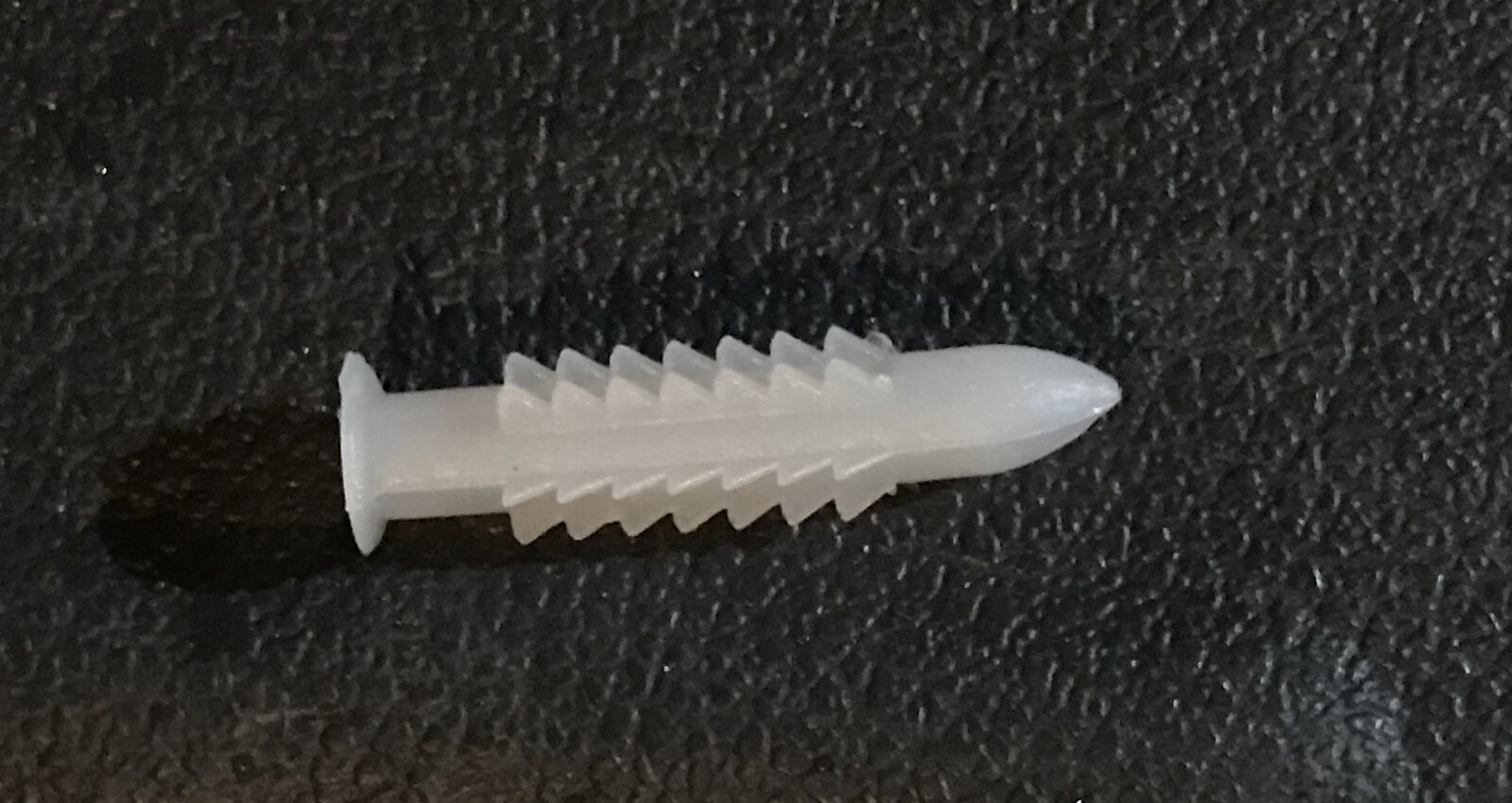

What is this type of rawl plug called

Trying to find a supplier for this type of rawl plug with the serrated edges as had a stash from something I must have bought but cannot find the same type to buy... anyone any idea what it's called, I'm Googled out!

Try googling "white nylon expansion pipe" or "white plastic expansion pipe".

Uno's and duopowers are superb plugs
I've been fitting shutters and blinds for 20 years - old houses have crumbly walls and often the hole becomes larger than the bit size so the serrated teeth type are brilliant as they hammer in nice and tight whereas the proper sized normal style will not grip.... simple as that!

Just use a smaller bit - simple as that
If I am drilling into a suspected problem wall I use a drill size down from the one I want to use and I see if the plug will fit , that way hopefully I don't screw myself over by drilling the hole too large and having to bodge the plug in
if you have crumbly walls, here is how to get a good fixing with plasplugs:

Surely if you've glued the plug into the wall there won't be any expansion force as the plug won't be able to move

All I do on ratty brickwork is to drill a hole 0.5 or even 1mm smaller diameter the insert the plug. Helps if you don't use cheap drill bits which "helicopter". Simples!
