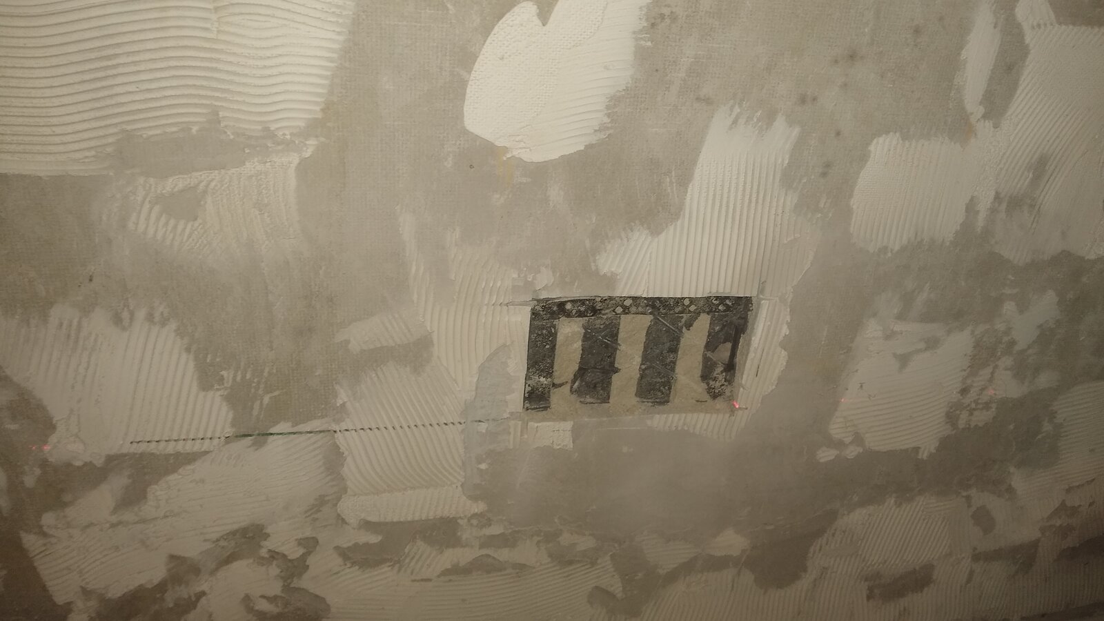

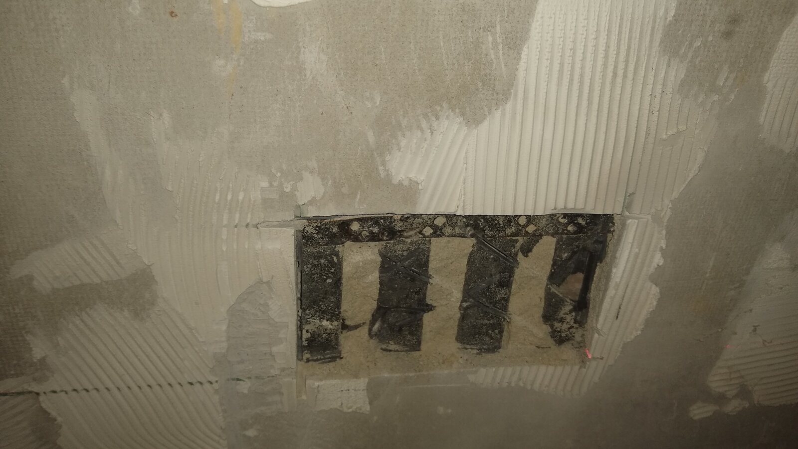

Was chiseling some new sockets in a Victorian house
And i came across this unusual (well at least to me) black thingymajig in the wall
It appears to sit between the brickwork and internal lime plaster
What is it? Perhaps some sort of damp proof/resisting material?
If so, should i avoid chiseling a socket in this area?

I wonder what size it is
and how far above the floor.
It's Newtonite lath - a damp proofing/tanking system. Yes, avoid puncturing it !

Unfortunately, having no idea it was there, I've already punctured it with my grinder
Is there a way to repair this?
Also, i need to fit a new radiator on a wall which contains this newtonite lath. Is there some sort of recommendation.
It's interesting how tanking is not advised on Victorian solid walls with lime mortar. The advice is to let the walls breathe and not tank
However this newtonite lath system actually works because the wall is bone dry. Contrastingly, the wall without newtonite lath is damp

The company are still going **** newtonwaterproofing.co.uk **** and you can get mastic and special screw fixings
