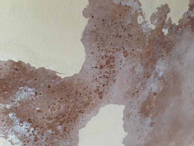

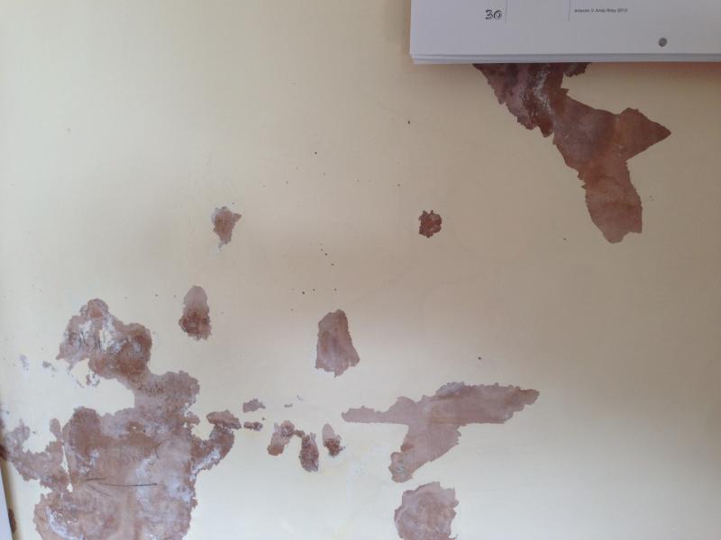

Hi,
I'm not sure if I am posting this in the right section, so I am sorry if I am wrong!

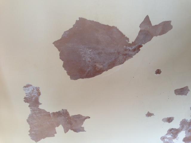

The paint on my living room wall is all bubbly and coming off the walls. In some spots underneath the plaster is rough and looks a bit motheaten, some it is really smooth, and some there is a white bloom to it. It also smells a bit like cat wee! I have put some pictures on to show what it looks like
The wall backs onto the bathroom, which is fully tiled and was redone about 6 years ago. The shower used to sit against this wall, and had leaked quite badly, the wall was replastered, and tiled, and now there is a wash hand basin unit and a wall cupboard on that wall.
I am guessing that somehow we have damp penetrating the wall from the bathroom? The bathroom itself seems fine, and the plaster isn't crumbling in the living room. I can't access behind the units in the bathroom but the back of them feels dry.
Is there anything I can paint on over this that would allow the paint to stick and not bubble off? It looks REALLY bad now I have scraped all the loose paint off...
Can anyone help please? Is it damp? Would a damp-paint/undercoat stop it bubbling? There isn't anything to leak on the other side of the wall, but it is a bathroom with fully tiled walls so could it be condensation coming through the wall?
I am guessing that the wall pictured above was not given an original mist coat or was painted over using PVA.
If you are worried about damp, get yourself a cheap DIY moisture meter and check the patches.
White colouring, bubbling and bad smell - yes I would say that this is damp. How old is your house btw? Some older houses and the plaster can smell a bit urine-like when they get wet for a long time. Thing is, now you've got to try and find the cause..! Check for any leaks with the basin, if your pipes have been laid into the wall, you may have a leak that you can't see. I wouldn't have thought after 6 years that it was due to the original problem, esp if it had been allowed to dry before replastering and tiling.

Now you need to either remove the damp plaster and patch up the wall or ensure the existing plaster has dried out completely before starting redecoration. If you opt for the latter, when it is dry, remove all the loose paint and efflorescence (salts in the plaster which causes the bubbling/blooming as the moisture in the plaster dries out) without wetting the wall. Any moisture added to the dry plaster will cause more blooming in no time at all. Apply a coat of alkali resistant primer to the bare plaster before filling and sanding the defects. You can then start the redecoration. This isn't guaranteed to work as efflorescence can sometimes be a nightmare to completely cure (even re-plastering doesn't always work) so you may always get the odd spot popping up. :(

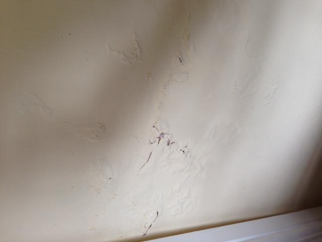

BTW, is it just me or can anyone else see Billy the Fish from Viz in the third image? :LOL:

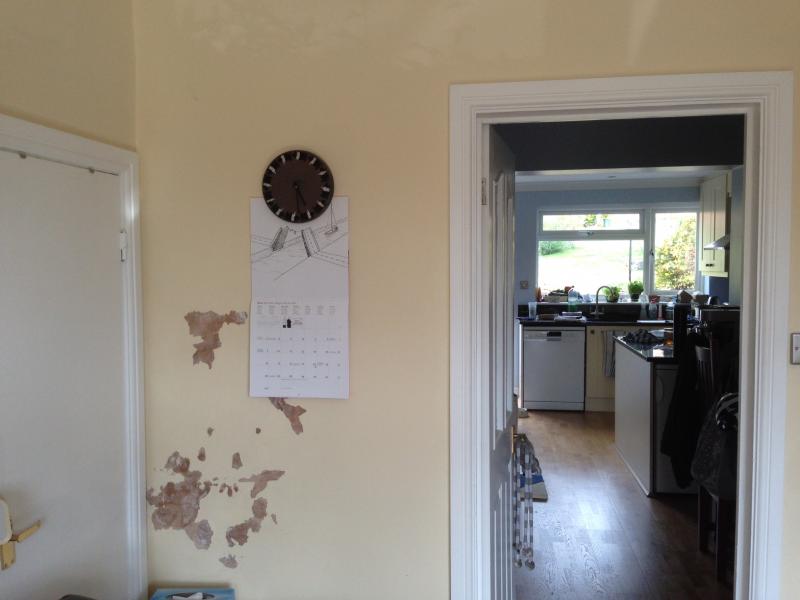

stand back and take a wide view of the whole wall (upright please) with something in it to show scale, such as a hand or a book touching the wall.
Pencil or chalk on the wall where the bath or shower or mixer are on the other side so we can relate them to the damp.
Your previous pics came out on their side.
Thank you all,
am attaching a wider view of the patch, for scale the calendar is 30cm wide. The wall behind the basin unit was fully tiled before the cabinet was fitted, so am not sure if we would see anything behind it. It sits roughly in the middle of lower patch. The shower isn't against this part of the wall-it is to the left beyond the door, approx 1m away. My pencil marks aren't showing up very well.
I had a look at the bath panel and I don't know if I can get it off without destroying it-the screws are all rusted (bathroom gets pretty steamy despite extractor fan and opening window...)

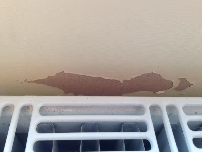

I also don't know if this makes any difference, but we have a small patch of peeling paint, on the other side of the living room behind the radiator, the plaster here doesn't seem rough though...
and to give you an idea of what the bathroom looks like from the other side
The wall in the living room probably has at least 45cm before it is properly backing onto the bathroom
