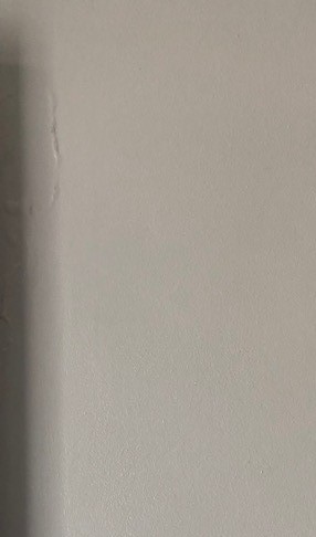

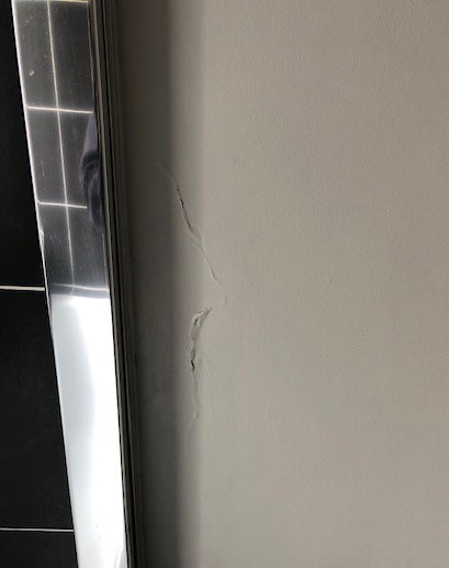

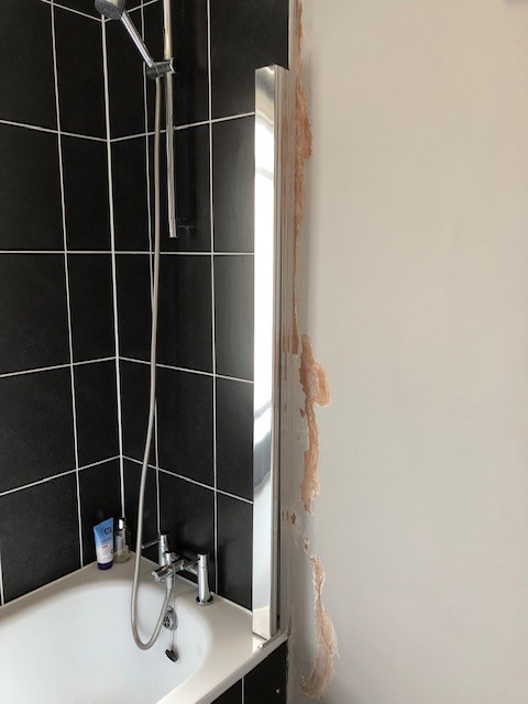

I feel like I've written about this a million times, but here goes....
When I moved in my property 8 years ago, I had tha bathroom retiled and the bathroom wall replastered. It's an exterior brick wall in a victorian house.
It then transpired the tiles were fixed directly to the plaster, with no membrane or waterproofing (it's a bath shower), so the tiles were leaking water.
I've since had the wall tiled again, with a water proof membrane (sheet, not painted), and that problem is now fixed.
However, over the past few years, I've had a persistent problem with the wall next to tthe shower, not holding paint, and bubbling/cracking shortly after it's painted. It just peels off with a scraper.
Nothing seem to adhere to it. I've had a tile removed and the tiling checked to to make sure its not letting water through, and it's been checked for damp. I've redone and redone and redone the paint work over and over again, filled it, primed it, and painted it. I was using Matt emulsion, but even with bathroom paint, the same thing happens.
Someone said to me it could be the salt in the plaster.
There are no pipes in the wall, the shower comes from the bath taps which come up from the floor, I've had it damp checked, I've had the tiles installed with a membrane and rechecked. I've left it days and days before repainting again. Each time the paint cracks and buddles, and just chips off with a scraper.

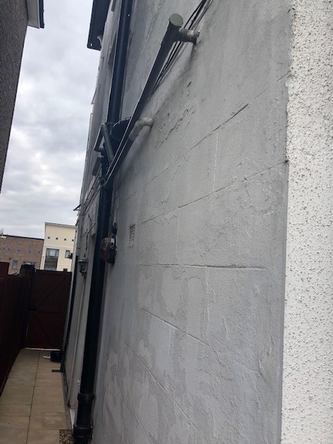

I'm at a lost, but need a solution. The only thing I haven't checked are waster pipes from the flat upstairs, that go through that wall at the top (pictured)
Any ideas?

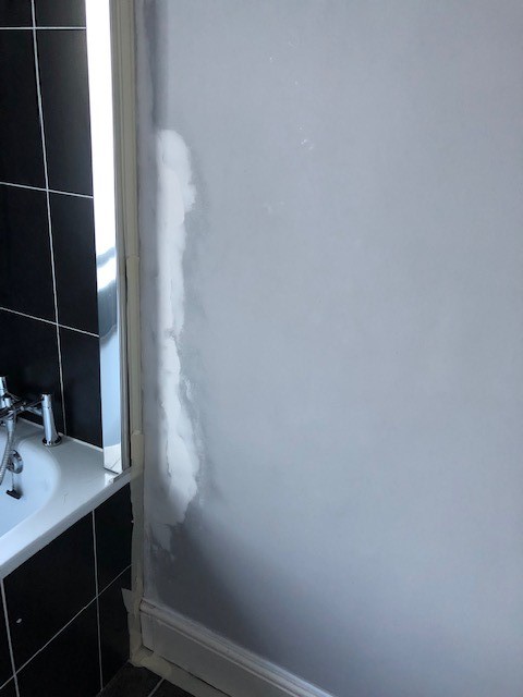

Its seems its just up the edge of the shower screen, are you sure the sealant up the inside and outside of shower screen frame is siliconed ?
When you say you have primed it before what did you use ?

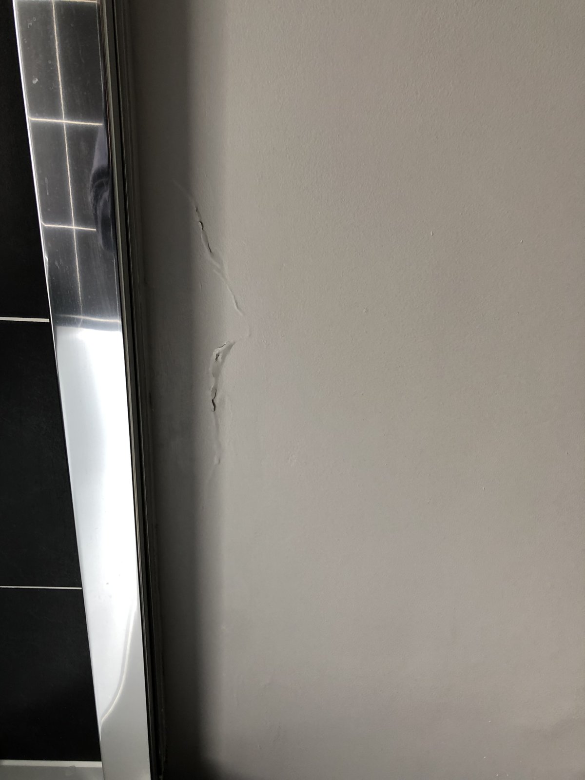

The silicon is sound both sides of the screen. This is also the 3rd different screen I’ve had, and the problem has remained the same.
I’ve tried a few different things when repairing... I’ve filled it first (so it looks smooth, as there’s several layers of paint), then primed with with Zinsser stain block primer, then painted it.
I’ve also tried putting the Zinsser onto the wall first, then filled it, then painted it. Leaving over a day in between each stage. The cracking starts around the edges of filled area/where there’s no paint.
If you look at the image of the wall with the plaster showing, where I’ve scraped the paint off, once I’ve repaired it one of the above methods, the cracking follows that outline each time.

Scraping down, priming with Zinserr, then filling, sand down and touch in all filler with Zinserr before apply top coats. To me looks like damp is affecting the paint.
That’s exactly what I did last time
