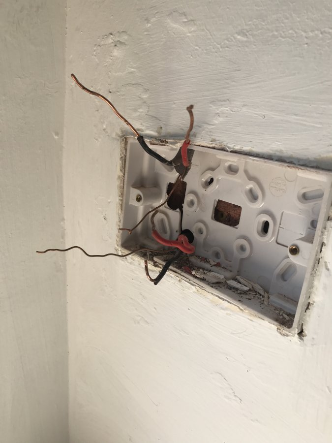

What?! Just, what?
8 Sep 2011
4,637
590
Warwickshire

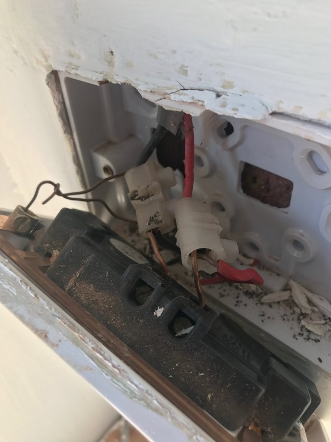

Not sure there's anything good about this socket. The bare copper actually continued on to the top entry cable, and the bottom entry was long enough to reach the socket terminals, so I'm not really sure how they got it so, so wrong
Should we give them points for using the same CSA cores into the socket? :ROFLMAO: But on a serious note what the F*%$ was that person thinking? or was it lack of a thinking that managed to give birth to such an atrocity!
It's only the same CSA because it is still that same piece of 2.5 from the top, not cut, just stripped back a boatload
It's this sort of work that disproves Darwins theory of survival of the fitest. If he was right, the installer would have killed himself by now.
Is it that the joins are not classed a maintenance free. I know the earth wires wrapped together aren't :D
Only reason that one got opened because the Megger said no earth path. So the wrap around method clearly didn't work, at all
The CPC and neutral are separate. I'm confused?
