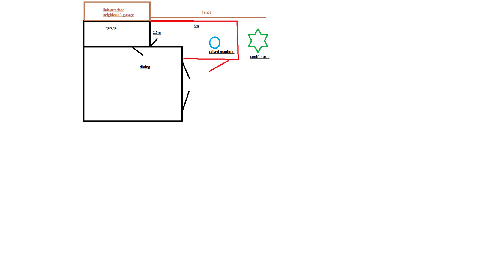

Need a (partly) insulated room as an extension at the back of a link-attached single garage.
The area is currently covered with not very even garden tiles (ants and old hedge roots are to blame).
No building DIY skills.
Does not have to be same temperature as the house, just protected from the elements, dry and having 10+ degrees without spending a fortune on heating.
The purpose: home gym (squat rack/bench/barbell) / tumble dryer (needs 6+ degrees) or laundry sorting/drying area with added dehumidifier / dry storage for things that might get mouldy in sheds.
Ideally lower budget as we are not sure that we will be staying in this house long term.
Not sure about raised manhole (~5 inches high) - assume it is possible to make it lower, don't really want to move it, OK to have floor access cover inside the room.
And also about regulations for the distance from the neighbour's fence, not much information in the internet for link-detached houses.
Options:
- I really like the addroom idea from dunster house, but they don't have this size/configuration or even close that could be modified - where depth would be higher than width and windows/door in the right places. - less than £10K + assembly.
- conservatory - known temperature issues would probably be fine here, but all glass does not sound like a good combination with free gym weights and also need solid walls for storage. And there also won't be any ready made in this configuration. Costs are similar to addroom (?).
- proper brick extension - can be built in bespoke configuration, but is overkill for my needs given the costs ~3K per sqm = ~30K+ ?
- some kind of garden room or shed with modifications to allow access though the garage door and to wrap around the corner (or give up on that extra space 1mx3m and keep it as 2.5x5m rectangle) , is it feasible ? Costs for an insulated one will probably be similar or higher than addroom.
- just give up and get a standard addroom added at the back of dining room. That area will be hard to access and wasted due to it being surrounded on all sides and will make garden layout awkward. No good place for a garden room elsewhere and need to have it accessible from the house.
What approach makes sense here? Thanks

If you might be moving in the future, would you wish to take this shed with you? (At the end of the day it is just that)
Making something modular, held together with bolts rather than nails means you could potentially take it with you.
For your budget/non permanent requirements, then a timber frame made up in sections would be easiest.
If you make a base frame from treated 6x2, then you only need rake over the site and cover with membrane, sit the structure on concrete blocks on well tamped soil.
4x2 stud walls, bolted down to the base and to each other. Make them the width of a sheet of 11mm OSB, for ease of erection and future transportation.
Get a second hand door and double glazed window. FB marketplace/ebay or ask local D/G firms for mismeasures.
Once you've got that up you can think about cladding, roof covering and internal insulation.
Thanks, would I need a planning permission for something like this given it is next to the neighbour's fence (few inches gap) if keeping below 2.5m height? Not planning to remove if moving
Keep it under 15m² and under 2.5m and you've no worries.
A few inches from the fence might irk the neighbour if a) it's their fence and they can't maintain it. b) rainwater runs off the roof onto their side or into the fence.
Slope the roof away or fit a gutter in that side, that doesn't overhang the fence.
It's worth leaving more than a few inches gap for ventilation. Future maintenance for you will be an issue, maybe consider using plastic or metal cladding on the back wall, even if just beneath the fence.
Also, if going contractor route, should I be considering SIP panels or the job would be too small to find anyone willing to take it ?
A half decent builder/jobbing chippie would be ok working with SIPs, it's not exactly rocket science.
