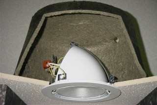

I think maxwell10 was referring to this stuff. No hole of any magnitude apparent in this partial cut-away view of safety hood :-
See To install FH DC300 or FH DC350 Covers. end of this page :-
http://www.tlc-direct.co.uk/Technical/DataSheets/Fire_Hoods/Downlighter_Covers.htm
Was wondering at time of posting about fire blocking versus heat dissipation, pot of course would not block anything but would indicate the presence of the light fitting and provide a block to inadvertently shifted insulation material.
