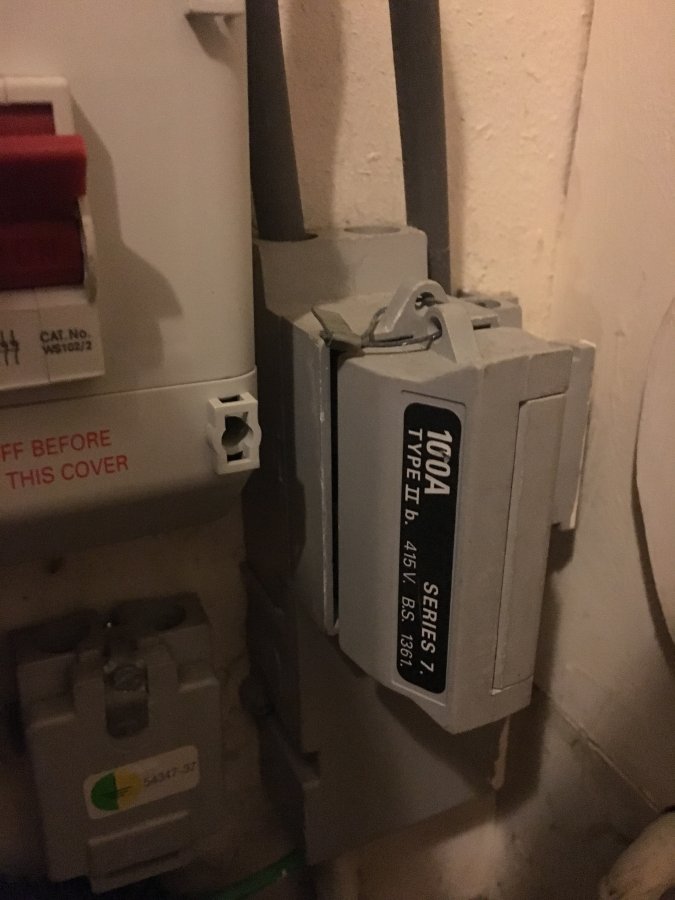

Apologies for the basic question but my lights and sockets have started to flicker and have narrowed it down to a wobbly part next to my electricity metre.
Not sure if it needs replaced but would first like to know what it's called and does! Have attached a photo - the part says series 7 on it.
Anyone had a similar issue?
And do it first thing tomorrow morning - today's flickering because of a flaky cutout is tomorrows fire.
