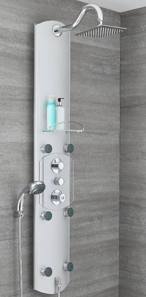

You can get power showers with the pump remote to the shower controls, and with a reservoir of hot water you can get showers with side jets,
these will not work with a combi boiler it can't deliver enough hot water, although since you are worried about running out of hot water maybe not best option for you, but some thing I fancy, and possible here as shower is down stairs so loads of pressure without a pump.But the power shower is really for when the header tank is too low to get enough pressure without it.
