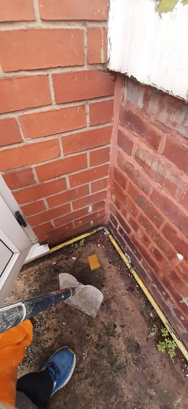

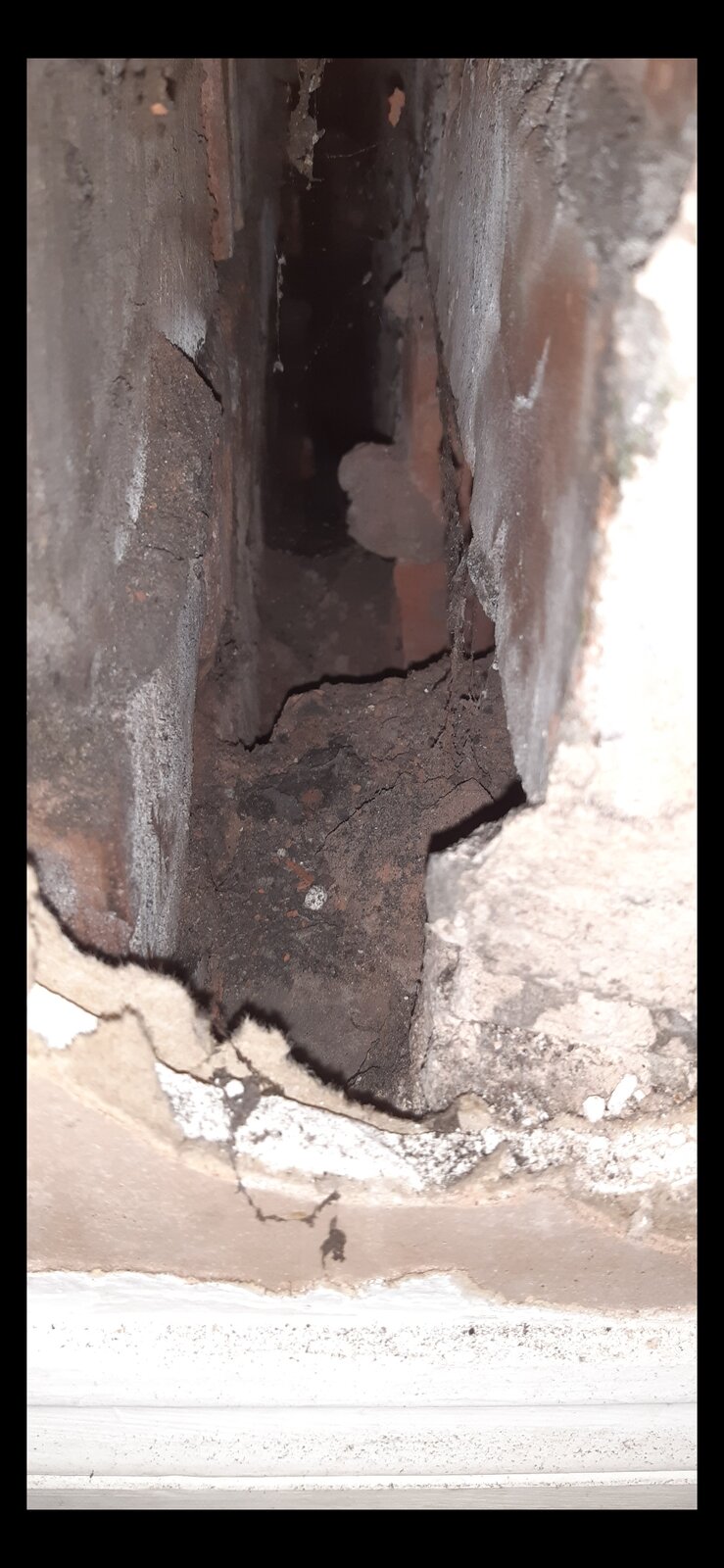

What should I do with a small damp patch? The paint has been flaky but not black or mouldy
It's at the bottom of a wall where the old wall meets the extension.
It's a concrete floor.
On this picture I can see a brick at the bottom of the wall that appears to bridge the cavity.
might be dripping or spilling from the gutter. The watermark looks quite high on the inside.

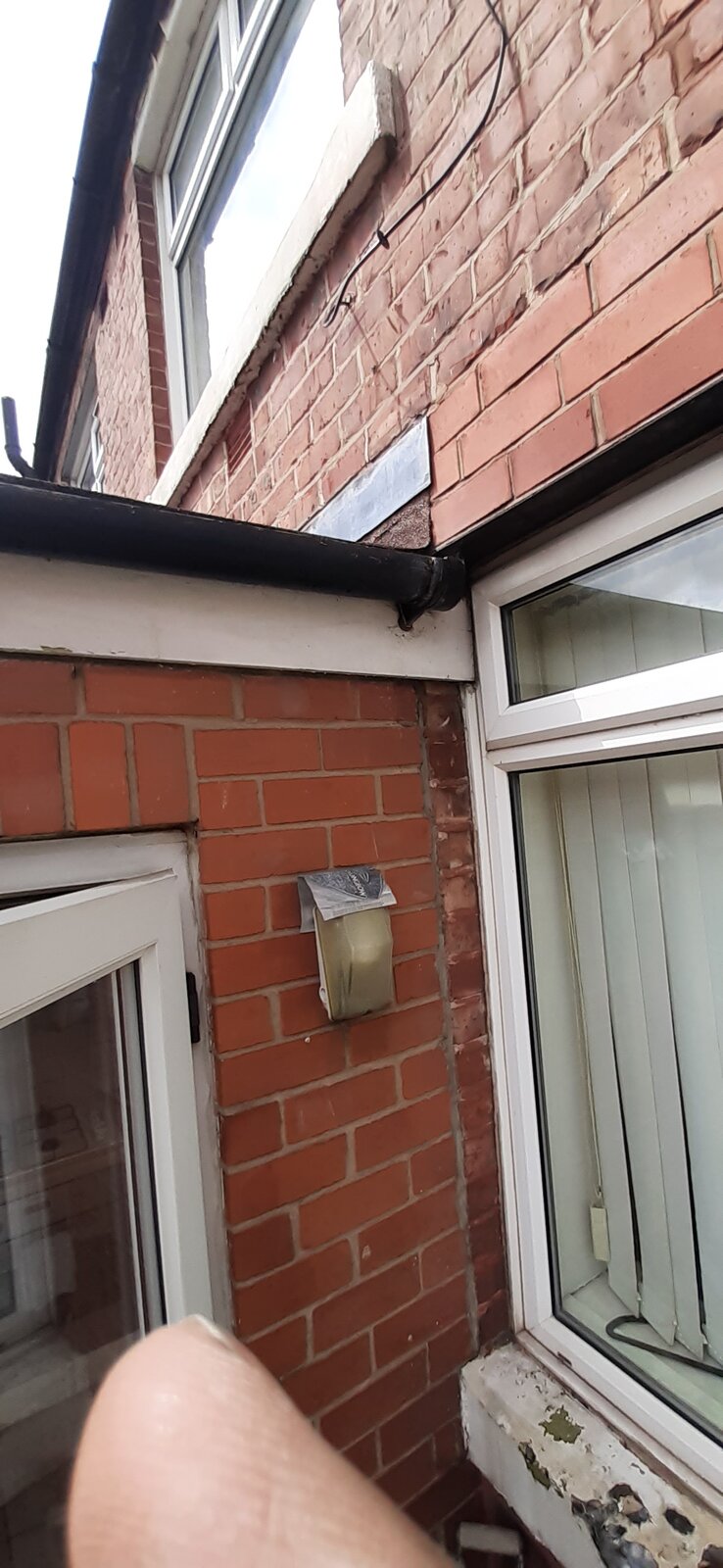

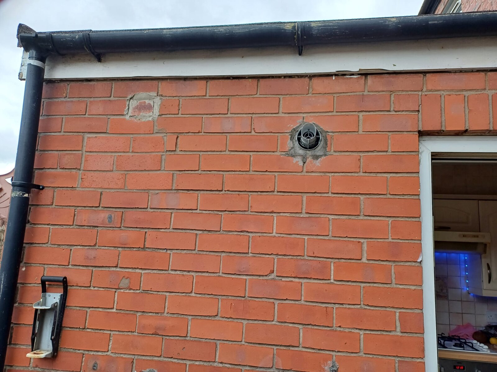

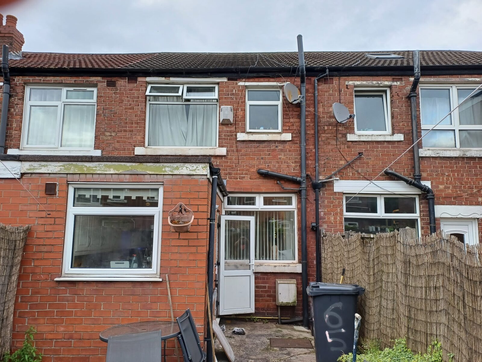

Outside, the corner looks like it has persistent damp. Stand back and take wide pictures of the entire wall, all the way up to the roof and showing gutters, downpipes, plumbing and boiler vent. Is there a bathroom above?

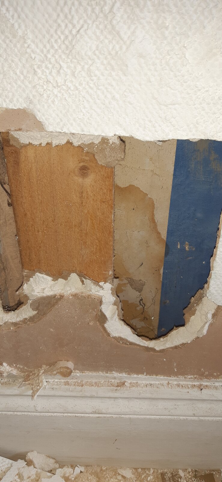

what is that bit of wood in the inside wall?
Thanks John, I'll take those when I'm next there.
It seems like the wood is a batten to attach the plasterboard?

A few feet of the cement seems to slope towards the back of the house, there is a drain there though.
Looking at the first picture, the brickwork seems darker around the soil pipe and downpipe, starting near the top and running all the way down to the ground. Soil pipes do not leak from the top so more likely there is a leaking gutter connection or blocked downpipe.

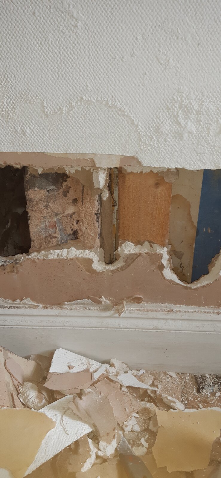

Hi, I'm wondering if part of the problem is condensation from a cold patch caused by it just being plasterboard covering the end of the cavity?
Would it do any harm to push a bit of rockwool in there? Before putting the plasterboard back.
Possibly put the rockwool in a strong bin liner so it stays dry?
