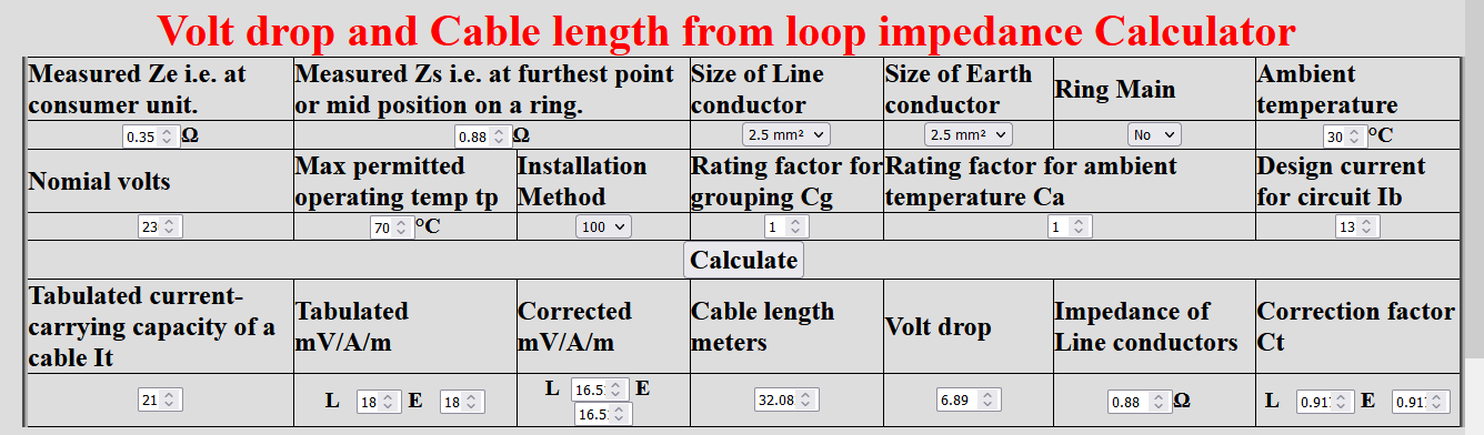

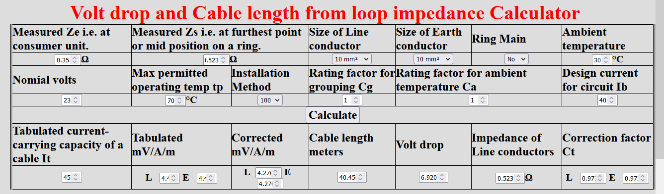

Kettle 3kW heaters 2 x 3 kW so looking at 9 kW so around 40 amp, so bang it into my software.
So it would in theory need 10 mm² to ensure the volt drop was within the limits for the lights in the shed. Would I use 10 mm² no I would not, I would use a 32 amp MCB not 40 amp, and I would use 6 mm² cable, as in the main LED lights can stand a bit of volt drop, but rules say lighting allowed 3% volt drop, so "Hypothetically speaking" it needs 10 mm².
In fact since I don't want to pay the LABC their fee, either I would use a scheme member electrician to do it for me, or if in England would use a 13 amp FCU for the supply and cross my fingers it does not rupture the fuse. At 13 amp we get
So 2.5 mm² cable, and use a 13 amp fuse, remember to turn off heater before using kettle, since a caravan seems to work with a 16 amp supply with 2.5 mm² cable at 25 meters long, I would say 2.5² cable is ample, and the heater in the caravan could be set seem to remember starting at 750 watt and highest setting was 3 kW, and the central heating even with snow on the ground was ample on the 750 watt setting.

So it would in theory need 10 mm² to ensure the volt drop was within the limits for the lights in the shed ... but rules say lighting allowed 3% volt drop,...
As you know, there are no 'rules' - the 3% figure is just a guideline, so 'allowed' does not come into it. I'm sure that all incandescent bulbs, and probably most/all LED ones will work fine (with somewhat reduced light output) with voltage drops' considerably greater than 3% (although we know that you, but no-one else I'm aware of, has had problems with fluorescent tubes fed with 'low' voltage). Indeed, when I did the experiment a while ago, all of the types of LED light I had available to test worked fine (with reduced light output) at 110 V - equivalent to a 'voltage drop' in excess of 50%.
I thought that outside wiring was notifiable in Wales, no matter how supplied? In any event, I suspect that the OP is probably thinking of a 'new circuit', which would still be notifiable even in England.
At 13 amp we get .... So 2.5 mm² cable, and use a 13 amp fuse, remember to turn off heater before using kettle ....
I would have thought that a 13A supply would be pushing one's luck given the long list of possible high-powered loads (including two 'heaters') that the OP mentioned. It could also probably be argued that such a setup would be non-compliant with regs, since I don't think that the designed could seriously claim that the 'design current' of the circuit (which, per regs, must be less than the rating of the OPD) was no more than 13A.
