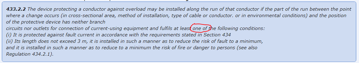

I personally don't really see a problem where there is a fuse at the destination which there is with a double socket and the cable is of a size where a short circuit would operate a protection device at the origin. However the BS7671:2008 has a 3 meter rule.
433.2.2 The device protecting a conductor against overload may be installed along the run of that conductor if the part of the run between the point where a change occurs (in cross-sectional area, method of installation, type of cable or conductor. or in environmental conditions) and the position of the protective device has neither branch
circuits nor outlets for connection of current-using equipment and fulfils at least one of the following conditions:
(i) It is protected against fault current in accordance with the requirements stated in Section 434
(ii) Its length does not exceed 3 m, it is installed in such a manner as to reduce the risk of fault to a minimum,
and it is installed in such a manner as to reduce to a minimum the risk of fire or danger to persons (see also
Regulation 434.2.1).
However if that applies it also applies to any other spur from a radial or ring.
For the umpteenth time:
The three metre rule only applies where there is inadequate fault protection and then protection against fire is required.
... BS7671:2008 has a 3 meter rule.
No. As the reg you posted says, one only has to satisfy (i) or (ii) - so, if there is adequate fault protection (which there will be), then there is no '3 metre rule'.
