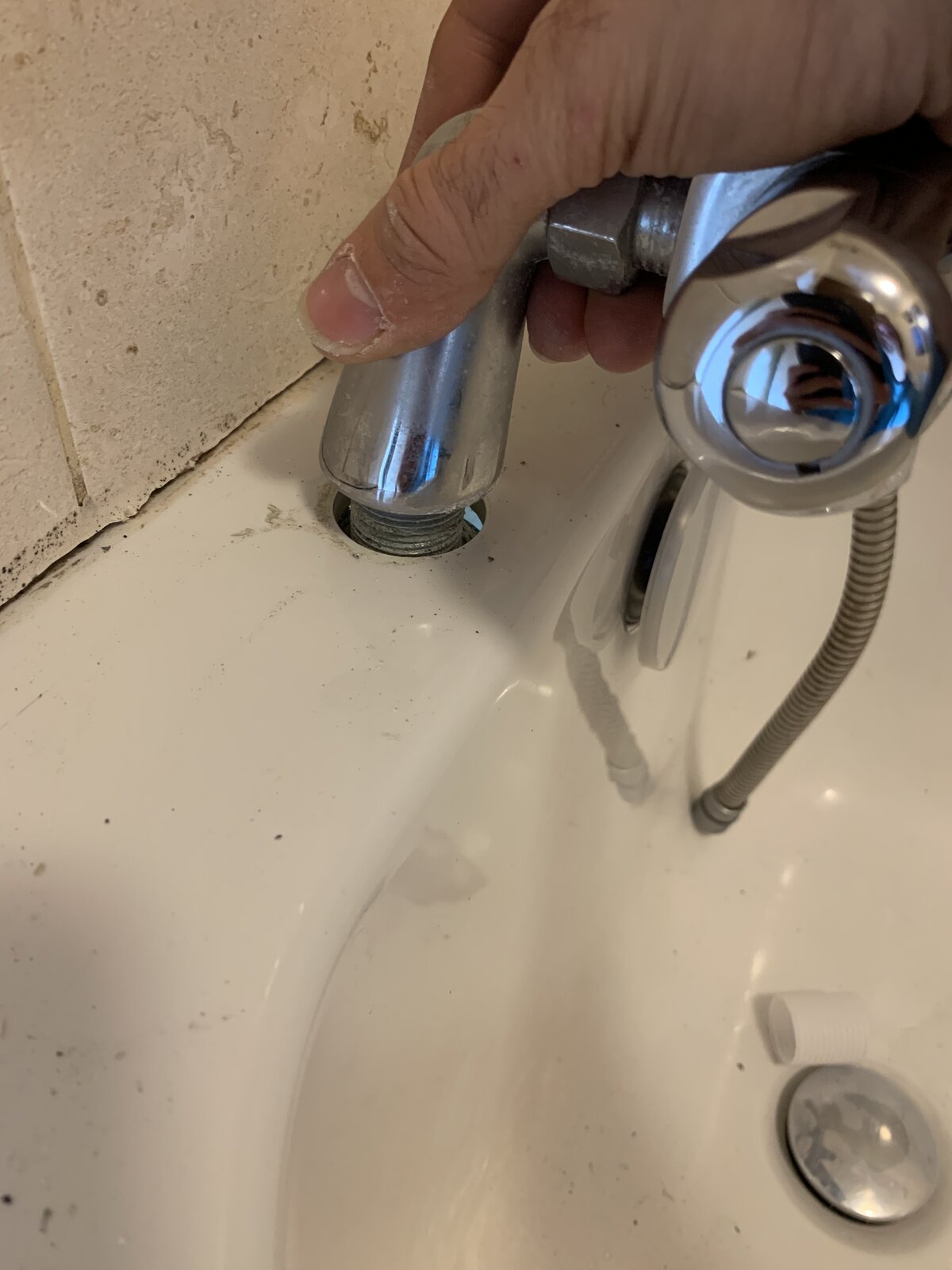

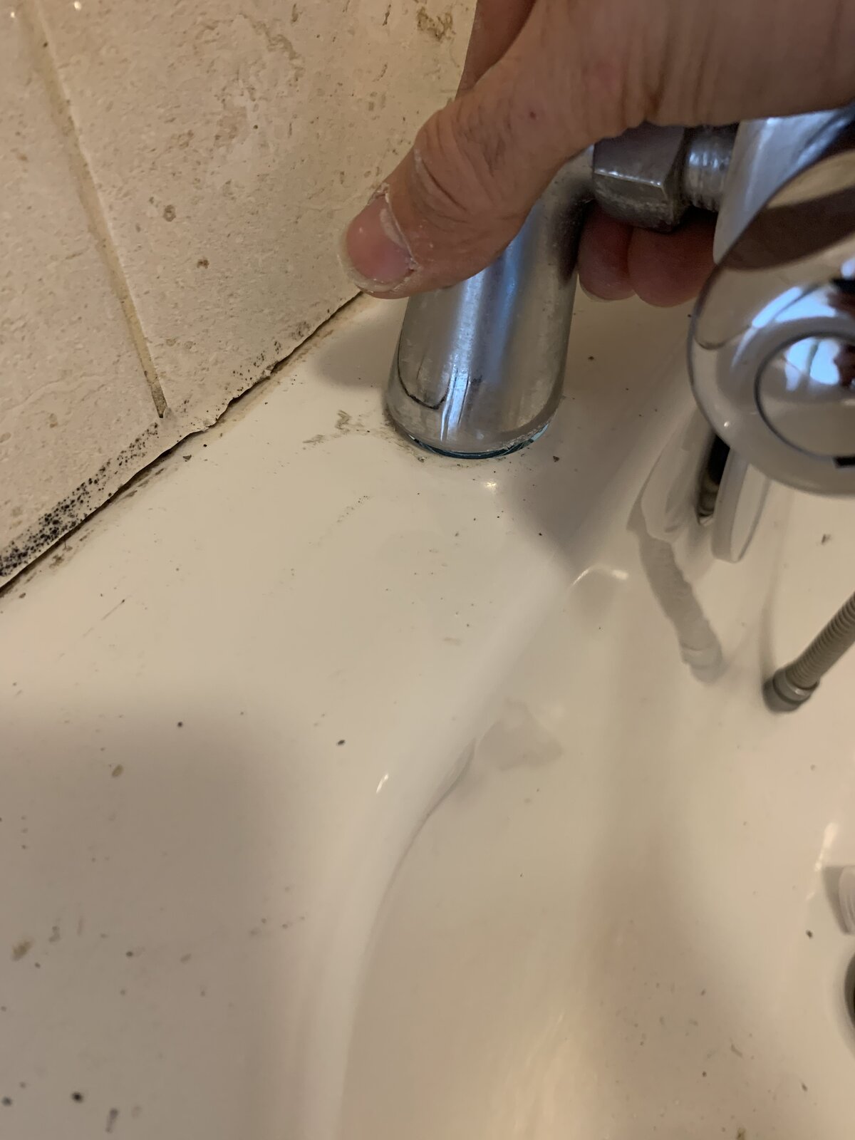

What size is the hole for the bathroom pillars.
I’ve got the feeling my plumber is been drilling these too big. The hole is just shy of the size of the pillar!
Oops. Is there enough meat left for the pillars to clamp firmly to the bath? Is the underside flat enough to get a bit of ply in (with correct sized holes) for the nuts to lock to?
