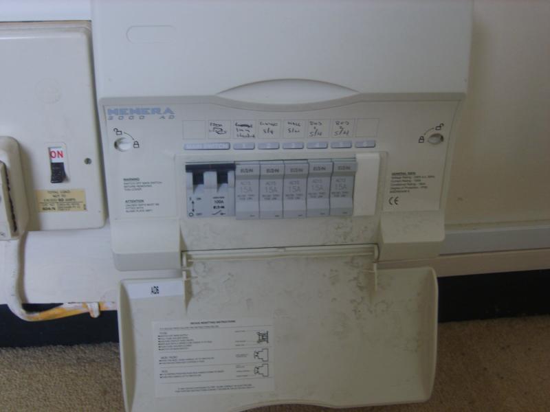

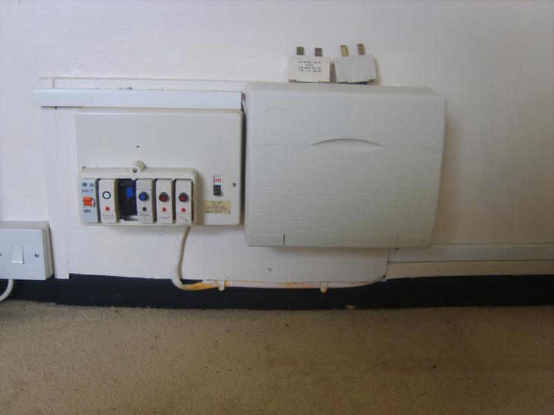

I also have a consumer unit that needs replacing and could do with some advice - I don't intend to tackle this myself, as it is beyond my scope.
Here are some pics :
The unit on the left feeds the sockets, lights and electric shower, and the one on the right feeds each individual electric heater in neach of the rooms.
4. Do I ask spark to replace the whole lot with one unit, or just the one on the left, and leave the one on the right?

Are the electric heaters on an off peak supply - if so it will usually remain as a seperate board.

< Are the electric heaters on an off peak supply - if so it will usually remain as a seperate board. >
OK - I think the immersion heater is on OFF Peak - not sure about the heaters.

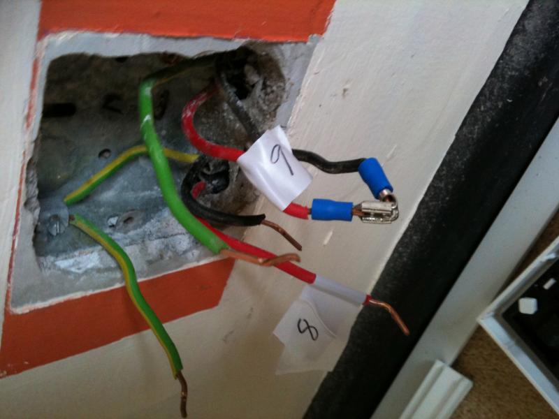

Thanks BAS for pointing me to a continuity test on the wires, and I thought I'd just update fully what you meant, as this was very useful for me to identify everything that is happening on the ring main.
Anyone who wants to know how their sockets feed one another might wish to know this also.
ALL POWER POWER OFF
Essentially I disconnected and exposed all the wires from every socket.
1. I started on one of the sockets, and chose one of the cables. I connected the live and neutral of this cable together (using an e.g. crocodile clip) and mark this cable with the number "1" (indicating the first cable), leaving the other live/ neutral feed alone.

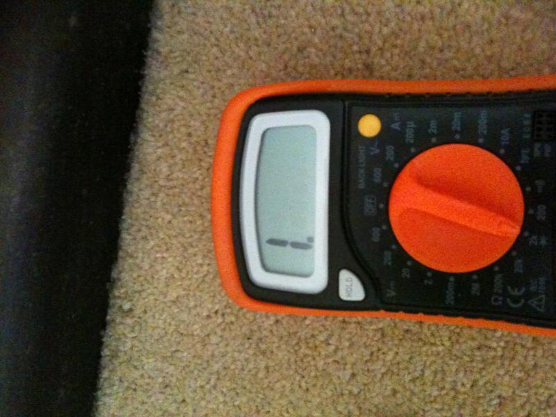

2. I then get my multimeter, and set it to resisitance mode (ohms), and go to another socket. Assuming no spurs, there will be two cables feeding each of the sockets. I check each pair in turn, by connecting the multimeter to the live and neutral of that cable. If there is high resistance it means that that cable is not being fed from the socket where I connected the live and neutral together, and so I move on to the next socket. Once I find a live/neutral with zero resistance, I know that cable is being fed from the socket where I connected the live/neutral together. So I also mark this cable with the number "1". I stay at that socket, and move on to the other cable feeding the socket. I mark this cable with the number "2" and connect its live/neutral together (having disconnected the crocodile clip from live/neutral from cable numbered "1").
3. I then move on to another socket to find which cable shows zero resistance. Once I find that cable, I number it "2", stay at that socket and label the other cable "3", and continue.
I have almost identified my whole ring main, which will help me identify what I need to do to progress the project with BC.
This is an image from a socket where I have already identified cable "8", I have just labelled cable "9", connected its live/neutral together, in order to move to another socket to find the cable that has zero resistance on the multimeter.
Multimeter shows zero resistance once you have found the cable which feeds that socket.
... or high resistance if you have not closed the circuit.
Spurs aren't a problem, because while there are three cable, one of them will feed a socket with only one cable, and you can identify this in the same manner.
... CARE
Make sure you have disconnected all of the cables to all of the sockets, otherwise you will have more than one socket which looks like it feeds the socket you are interested in. You may also have shaving sockets etc to think about ...
Now all you have to do is learn how to do the figure of 8, Ring Final Continuity testing - for when you connect all those sockets back on and want to confirm continuity and polarity :LOL:
