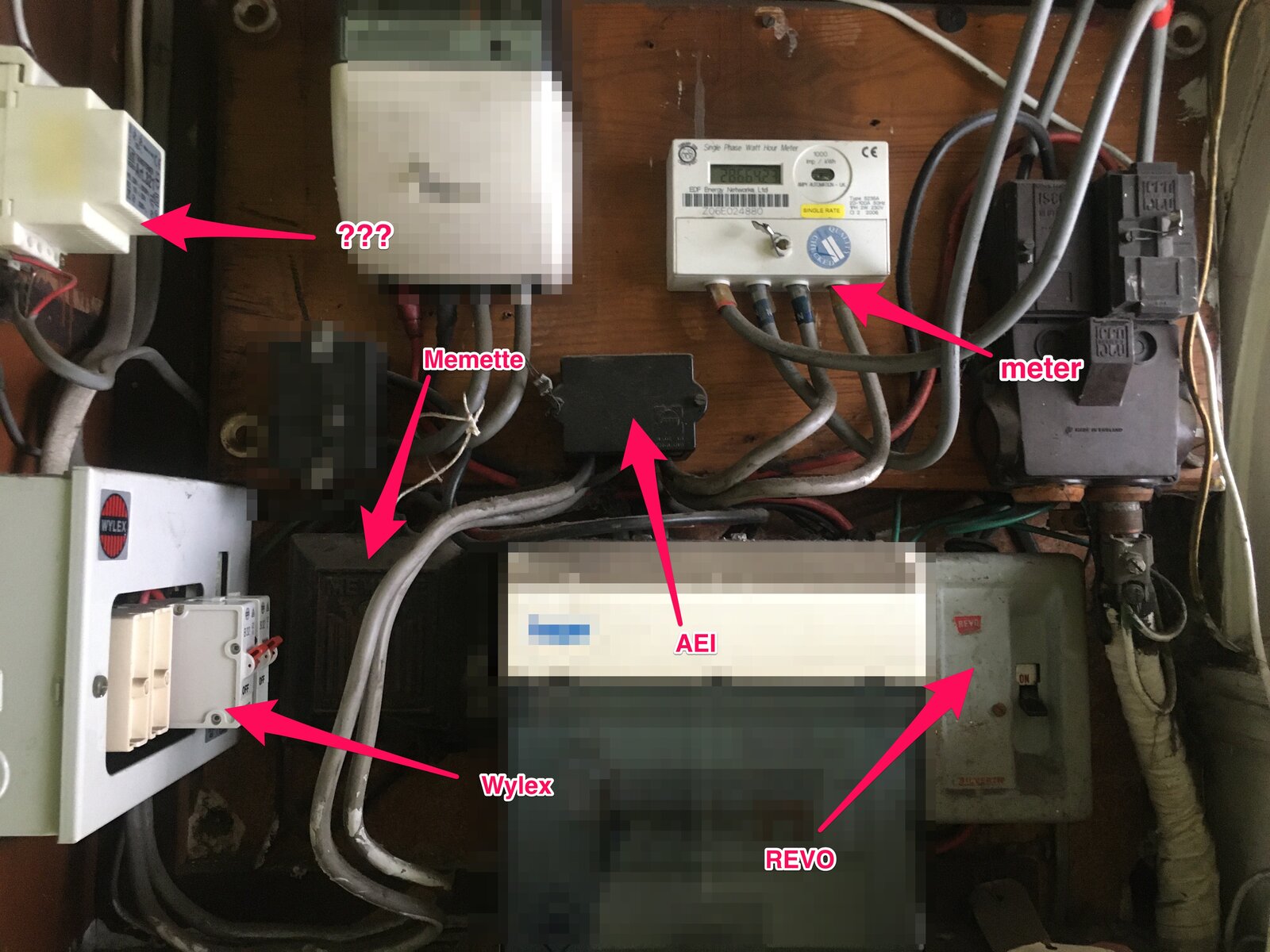

Hi everyone,
I’m just starting to make sense of the electrical system in my new place. The flat is 1900 and it has been upgraded bits by bits over the years. While most of the cables seems to be okay (PVC insulated, with a mixture of old red/black wires and blue/blown wires), the fuse box is a huge mess.
Please see the photos (ignore the pilxated bits, those are my neigbhour’s).
From what I can make out of, the main power supply goes through the meter then into an AEI splitter (?) (what is the right word for this). From the AEI there are 3 pairs of cables going into 3 different fuse switches/consumer units. First one is a REVO fuse switch, there are two cables coming out of this, so probably one ring main, controlling the majority of the sockets. Second one is a Wylex consumer unit, probably a more recent addition. There are two 32A MCBs, one for the oven, and the other for the boiler. Third one is a 15A Memette (switchgear?, why do we need this one?). This one strangely goes into another MEM fuse switch located on an upperfloor. This MEM fuse switch splits to 2 5A radial circuit running on the loft, one supplies lighting for living room, bedrooms and the other for kitchen and bathroom.
Questions,

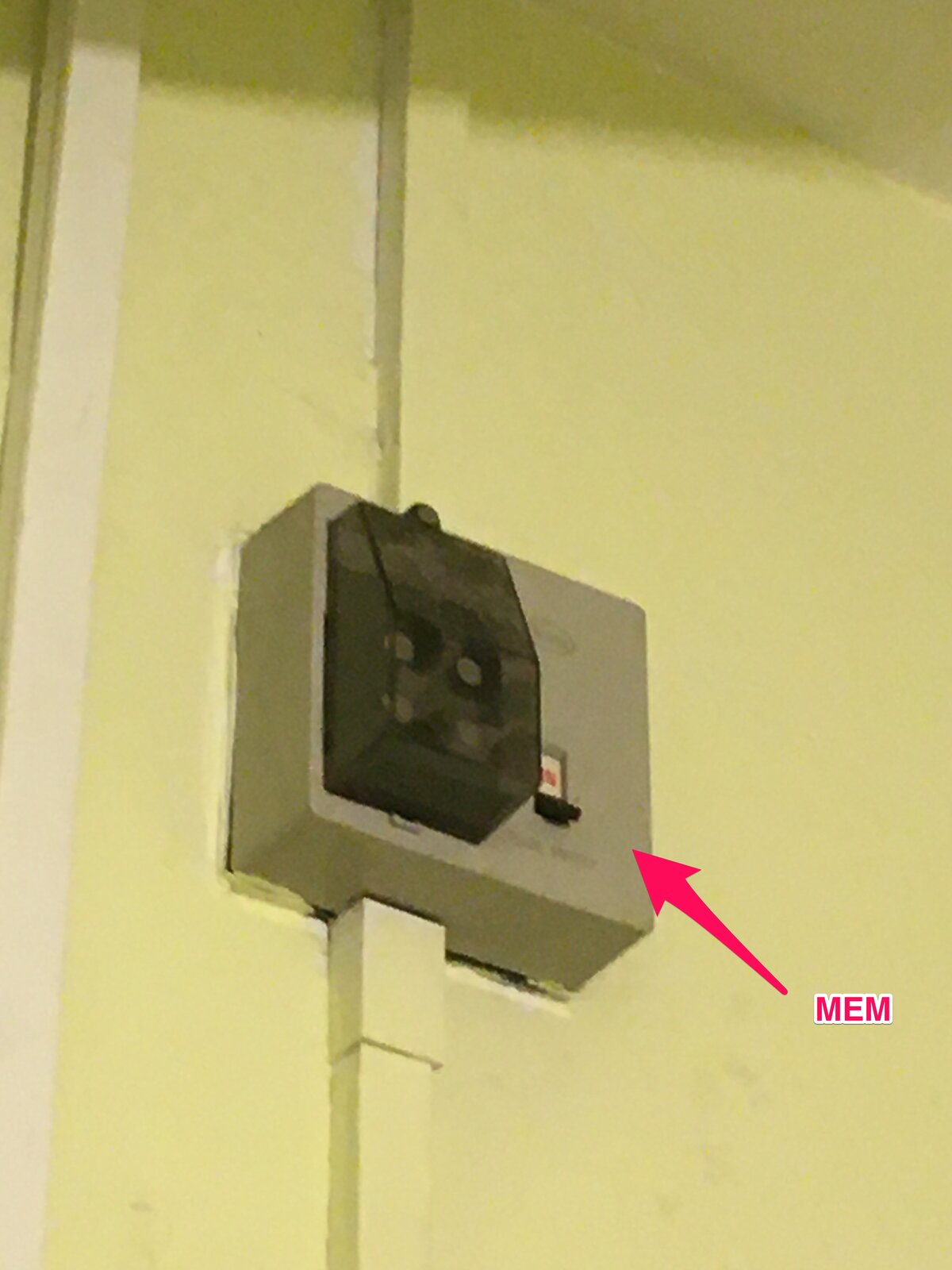

1. Is there any huge problem you can see with the current set up that needs immediate attention?
2. I want to replace all these 3,4 (REVO, Wylex, Memette and MEM) units with a single modern consumer unit. Anything to watch out for?
3. Ideally, I would not want to rewire what has been there (they look ok), but just adding a few more circuits. How many circuits do you consider as minimum in a property (3 bed flat, 90m2)? I’m thinking just splitting the ring main into 3 separate ones, one for living room/bedroom/hallway, one for kitchen ground sockets (so fridge, washing machine, dishwasher) and one for kitchen counter sockets (kettle, microwave etc). (there is a seperate circuit for oven already)
Many thanks!

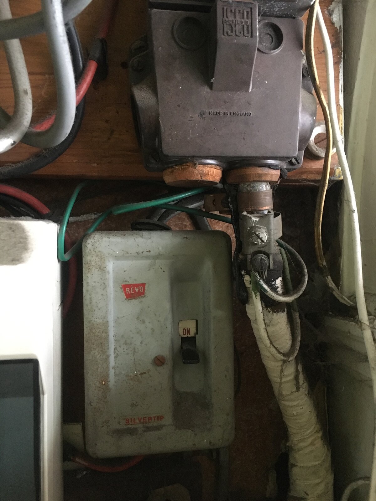

Everything in the photos is scrap, and should have been replaced decades ago. The Memette is 1950s, the Revo might be 1960s, the others perhaps 1980s.
The item with ??? is a power supply, probably for a door entry system.
It may be possible to retain the cables, but it depends on what type they are, their condition, where/how they are installed and whether there are enough of them - older properties typically had very few socket outlets, and if it gets to having to install a substantial amount of new cabling for new outlets it's likely to be easier and cheaper to do all of it in new.
Unless you intend wiring it in the style of the 1940s, rings are neither necessary or desirable.

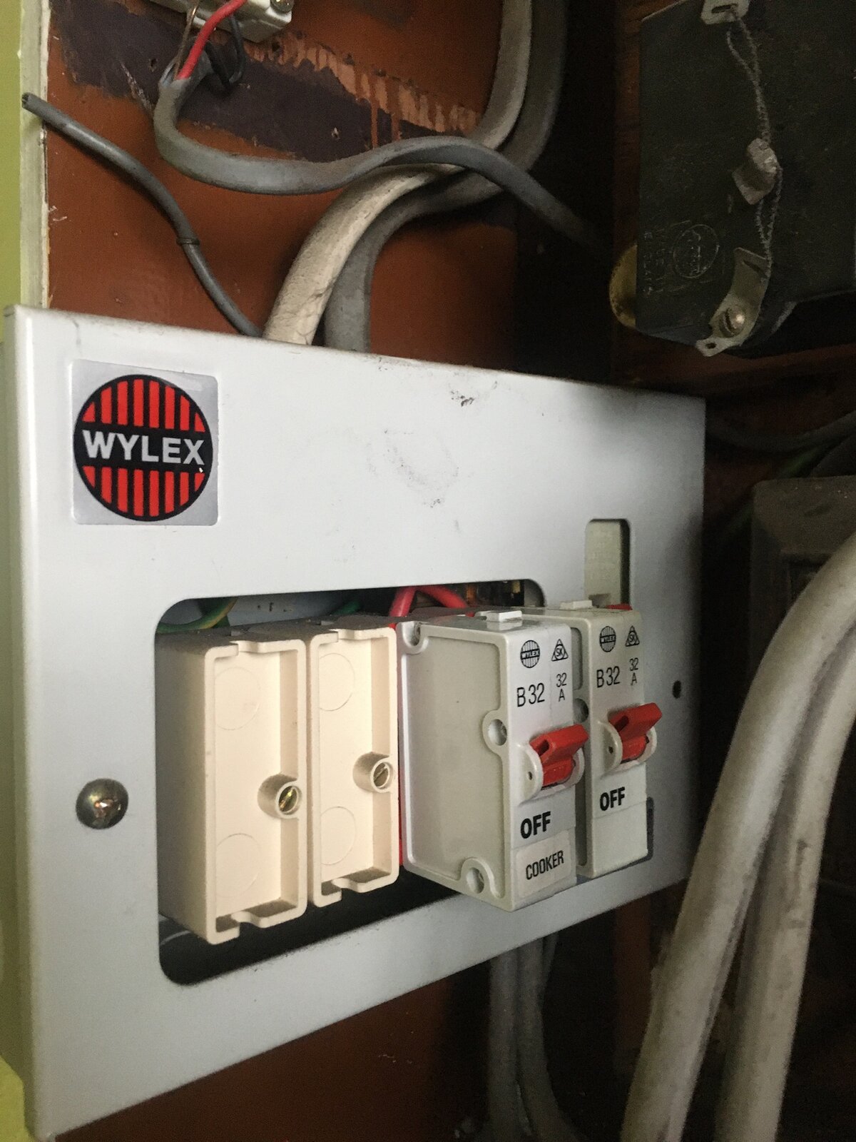

Mothers house, my old house, and this house all had the Wylex fuse box with the fuses replaced with MCB's until a few years ago.
Mothers house was a mixture of 1954 wiring to few years before my fathers death, and there was a problem installing a RCD, and it clearly needed a part re-wire to replace all the rubber insulated cables and cables which had been overloaded it was found 2.5 mm² had been used and the original 7/0.029 the latter seems OK but signs of melting on the 2.5 mm² where dad had fitted spur off spur through the live of the house. So only wiring done after 2004 was retained.
My old house also found some problems, but did not need a rewire, I had fitted RCD protection in around 1992 so any problems since then would have tripped the RCD as the problem arose, but mothers house there were so many faults, as said gave up and a re-wire was done.
This house after loosing two freezers full of food before moving the fuse box and consumer unit replaced with an all RCBO consumer unit so one circuit would not take out another one. I was lucky only 2 circuits with a problem, borrowed neutral, but when a RCD/RCBO is added it can find faults you didn't know existed, so before it is done need to do an EICR to find faults first.

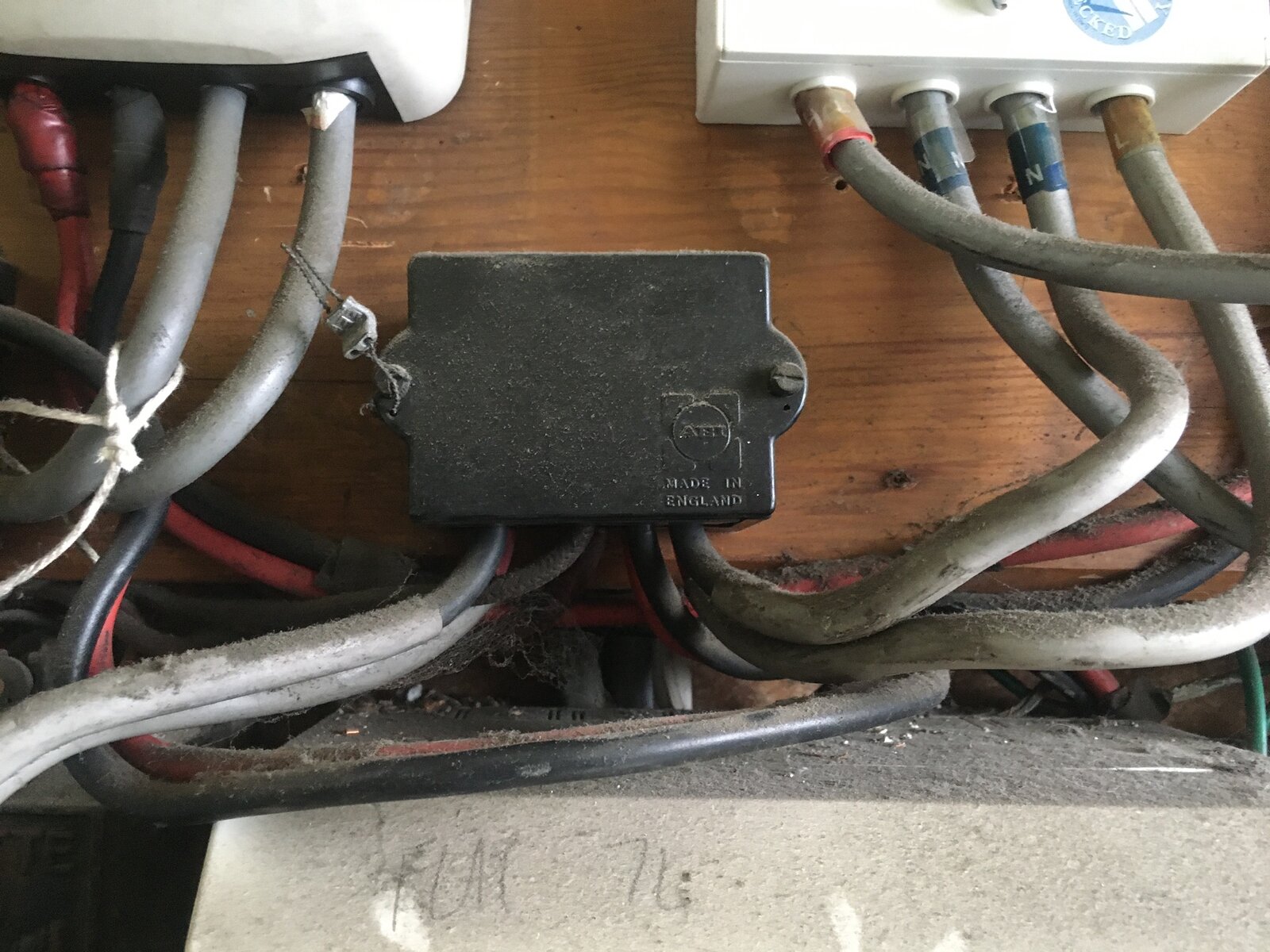

The AEI splitter, do not know why, but most people still call them a Double pole Henley block even though as in your case most nowadays are not made by Henley, they also make single pole versions.
Think the proper name nowadays is just a 100amp Single or Double pole connecter block.
I'd be seriously considering at least fairly significant rewiring, to be totally honest. If you've just bought, now is the best time to do it, rather than when you've decorated, had carpets put down etc.

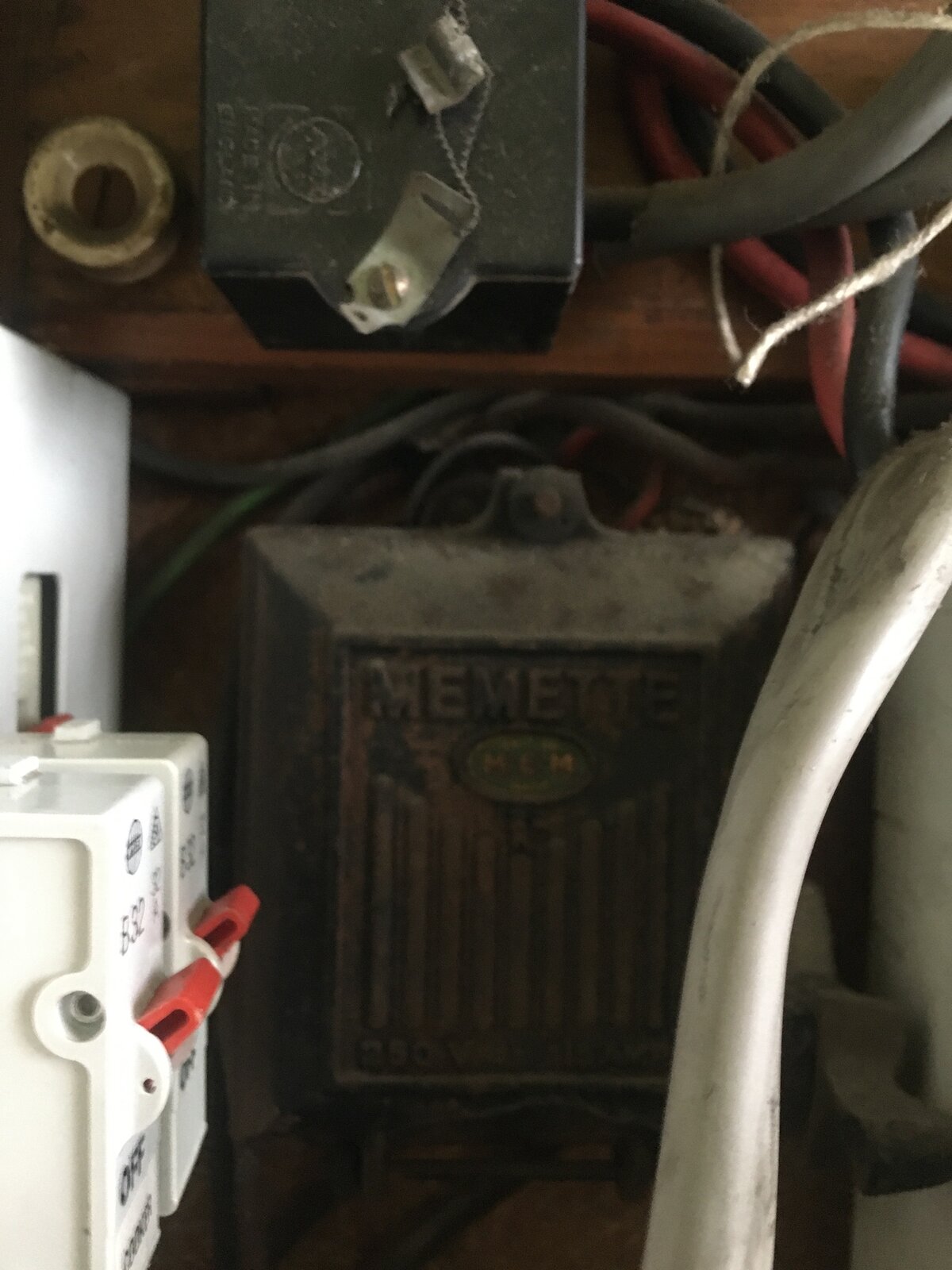

That Memette unit looks to be 1930s/40s, to me, connected to rubber covered cabling and is long, long overdue for retirement.
Hate to be the bearer of band news, but if a job's worth doing, do it just once, and get it over with.
It looks like an ancient setup that has had a bunch of peicemeal additions over the years.
The wiring is a tangled mess, which is difficult to make out and it can be hard to distinguish a grubby black from a dark grey in photos (much easier in person), but i'm pretty sure I see a mixture of old rubber and more-modern plastic in those pictures. Modern plastic has a very long life, but old rubber should have been replaced a long time ago. The general advice I've see with old rubber-insulated cables is to replace them as soon as possible, and not to touch them until you are ready to rip them out. Old rubber can harden and crack with age and this problem is greatly exacerbated by any movement of the cables.
As a rule of thumb, plastic twin and earth cables are generally white or grey, old rubber cables were more likely to be black. Braided insulation is strongly indicative of old rubber.
One thing I would be tempted to do is start turning things off one at a time, and trying to figure out what if-anything is actually supplied from each fusebox. I'm not 100% sure, but I think the oldest "memette" box may already be turned off (I wouldn't expect a handle to be sticking out like that in normal operating configuration), suggesting it may be redundant.

I think you will struggle to find an electrician who is prepared to connect a new consumer unit to old rubber cables. Certainly the electrical safety council advise against doing it. So the question becomes do any of the old rubber cables form a critical part of the installation?
And you also have the problem that the cables may well not reach a suitable location for the new consumer unit without being extended, indeed one of the consumer units you have pictured seems to be in a totally seperate location from the others.
Sticking out/up is on for those old fuseboxes, hanging straight down is off. In the on position, the lid is interlocked so it cannot be opened until turned to off, in order to access the fuses.
