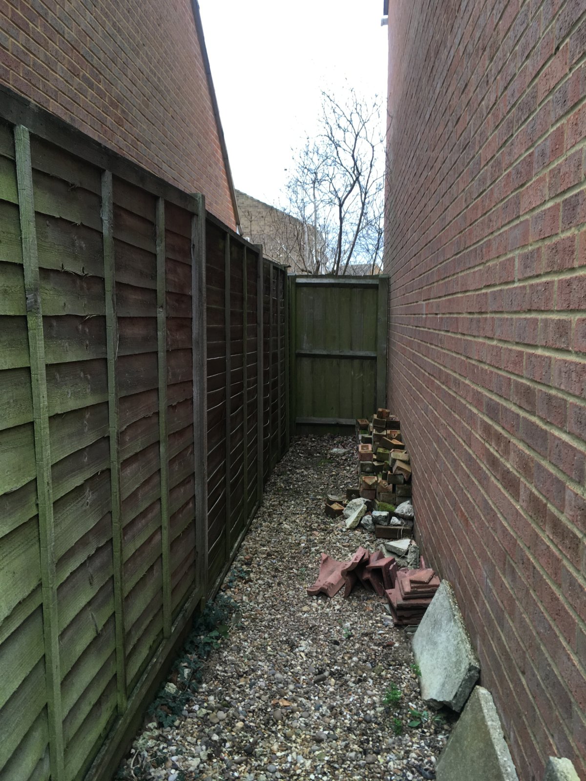

Hello all,
We have pretty pathetic storage options for our garden paraphernalia and am looking at the idea of converting our spare side passageway (we have two) into some sort of storage area. Please see attached image.
The gap is roughly 1.1m.
Does anyone have any suggestions on what is possible? Could I erect a brick lean to with a door?

I have a similar space but twice the width so it can still be used as a passage. The original owner put in a lean to but with the corrugated roof lengthwise so water does not drain over the fence. Short bit of gutter at low end.
from a neigbourly point off view
you roof needs to terminate on your side and also catch any water and direct to your side
so the easiest option off up to and over the fence is out
is the fence yours or theres ??
The fence belongs to my neighbour.
officially you cannot connect to it so would need a separate structure that can touch but not be connected to assuming the face is the boundary

As stated above, you need to have a run off in line with your house wall.
A batten fixed to your house running at an angle no more than one brick course would be sufficient. Next build a wooden framework for the opposite side with a same angled batten at the top. It may be prudent to board the outer side before lifting the frame into position or you can board it from the inside if you are against a neighbours fence/wall. Depending on the length you will need cross braces to the batten on the house wall and at ground level, thereby creating box like structure. Fit your cross braces at set distances to give the polycarbonate roof good support. If you are making it long enough to need two or more sheets lengthwise then start at the lower end and overlap the next sheets by at least 150mm Work up the side nearest the house first, installing flashing tape to the house wall and poly surface to prevent rain ingress, and then complete by fitting the left hand, (outer), sheets by working from outside the structure, asking your neighbour for permission to set your ladders on his land whilst you do so.
If you neighbour refuse simply use shorter lengths of poly so you can secure it from both ends finally finishing the last sheet from inside your own property at the high end. Fit a frame each end to mount your doors/windows and also fit a short length of guttering/downspout to the lower end.
