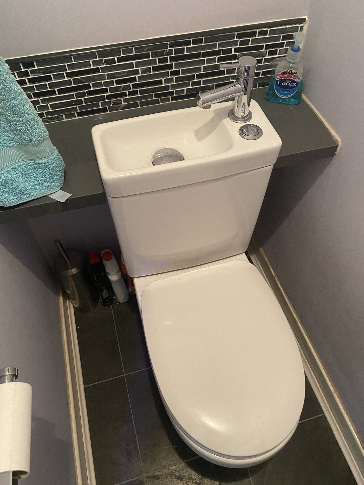

we have a sink in the top of the cistern in our downstairs toilet as there was limited room for a sink. Cold water only, but fine for a secondary loo

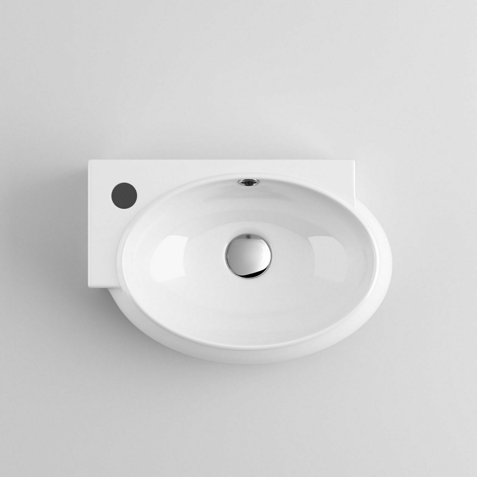

you can get a teeny cloakroom basin. I have one. I think it's about 450mm x 250mm
can go in a corner. something like this though there are rectangular ones
though the door is on the long side, not the end, leaving a bit of dead space.
Does the waste from the sink drain into the cistern?
Good idea, no reason why it shouldn't. Mine had H&C to it, so I fitted an inline temperature controlled mixer, did away with one tap, so it comes out of the one tap at 45C. The toilet is adjacent to the outside back door, so it's handy for hand washing when I pop in from the garden/garage/workshop.
