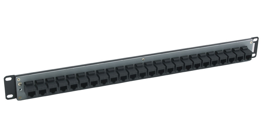

No, use patch leads. The ends should be terminated to sockets at one end & the panel at the other. The ping command is pretty pointless, a continuity test will be no better.
I wouldn't use Ping. I can't recall the name of the utility I have, but you run it in server mode in a CMD prompt on one machine, and client mode in a CMD prompt on the other. When on PC I will see what it's called.
If you have two laptops, you can use them to do a simple speed test, with some small command line software on each. It won't do the full detailed tests that a network analyzer would do, but you really don't need that for a home.
Indeed - but wouldn't one have to put plugs on all the cables to that reasonably?

You want to use something like iPerf to test the link. However this isn't going to be anywhere near as good as a proper test using something like fluke test kit.

I realise that - but I thought it had already been agreed that there's no point in putting plugs on the ends of the cables if they are to be connected to a patch panel? Maybe I misunderstood.

Unless it is the coupler type patch panel.
Cheers all. So I found my punch down tool and repunched all the sockets on the wall plate that had 3 of the 4 sockets failing with the continuity tool and now all cores connect, and I have tested streaming 1080P HD down 2 of them. I think I am going to wire the patch panel myself and use jperf to get an initial basic idea of what I am dealing with, ie are transfer rates 50, 200, 500 Mbps. I could also get a professional to test if there are discrepancies with the different cables in each room.

What has plugs got to do with testing?
Most laptops have 8P8C sockets for accessing their NICs, so cables with 8P8C plugs on are dead handy.
I believe that's also why they manufacturer those pre terminated patch leads for use with those patch panels.
