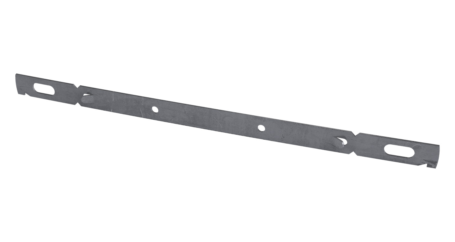

    New to the UK, and I am pouring a grade beam for a workshop that I am building. In Canada (the land of basements), concrete forms are made of 3/4 plywood held together with snap ties, that have slots in them that you slide flat metal bars (waler bars) that hold the forms at a fixed distance. After the concrete sets, you slide the bars out and snap off the ends of the ties.

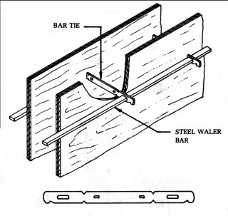

    A grade beam is a small concrete wall. In my case it will be 60cm high 25cm thick, with about half under ground (grade), sitting on a footing. Not sure what they are called here.
    Here is a pic of how the snap ties are placed.

    A retaining wall then? Or just a concrete wall.
    I've never come across those ties. We tend to just shutter concrete with bracing externally and not through the wall.
    Won't those ties end up rusting due to the exposed ends?

    It is for a short concrete wall that will be the foundation for the workshop.
    The snap ties break off just below the surface, and the holes are normally just filled, but you can also get stainless ones.

    there is a method of using threaded studding, with screw-on plates that clamp against the shuttering on both sides, and sometimes people use wire.

    It just seems like a waste of time. I can't see any advantage in it at all.

    If you have ever seen forms put up with snap ties and whaler bar, it is hard to imagine a quicker way to do it. Plus it is mostly just plywood, and you do not need so much additional bracing, just enough to keep the forms in place.
    Without any anchors through the wall, there is a lot of outward pressure on the forms, especially at the bottom. Adding all that bracing externally seems like it would take a lot of time, and material.
