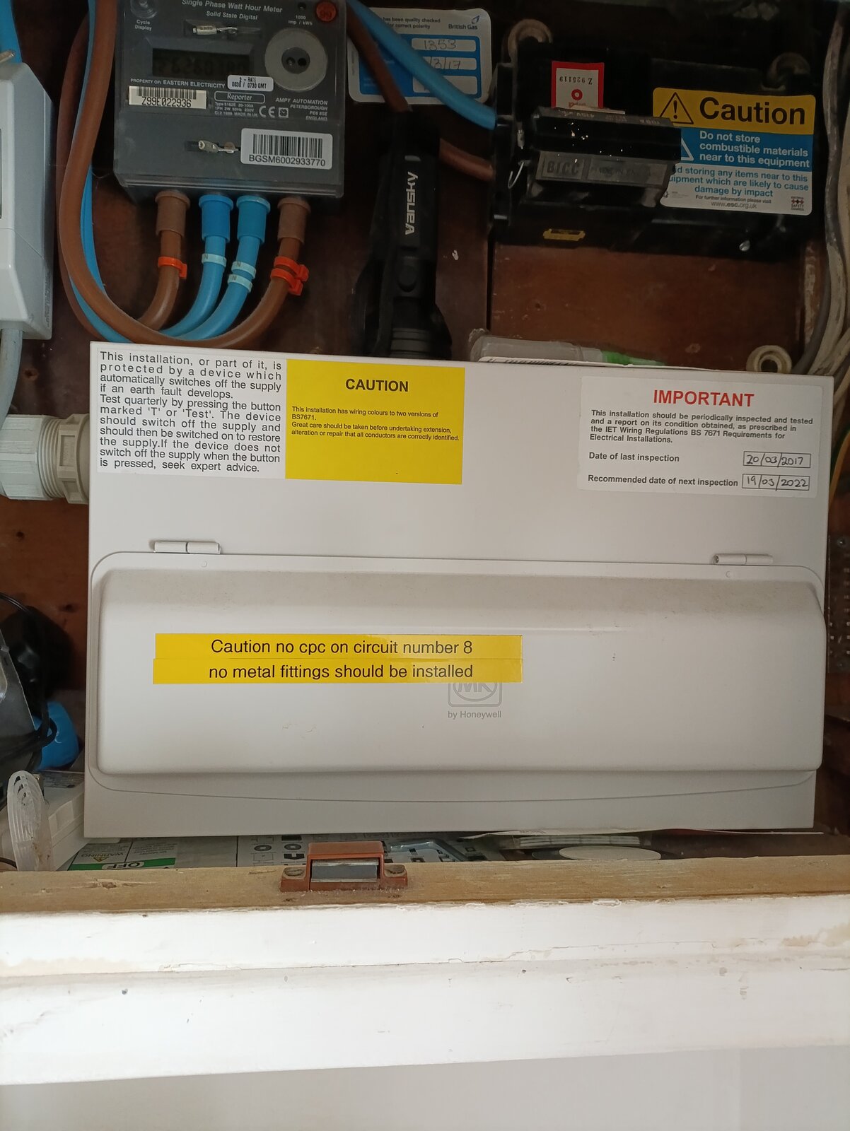

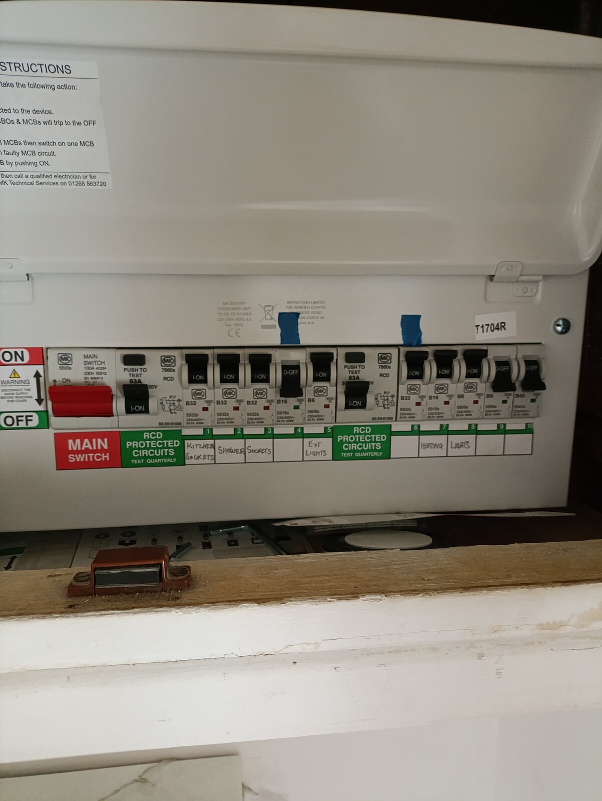

Just uploading a pic of my consumer unit as suggested. Interestingly, all three circuits are protected by 32A breakers.
