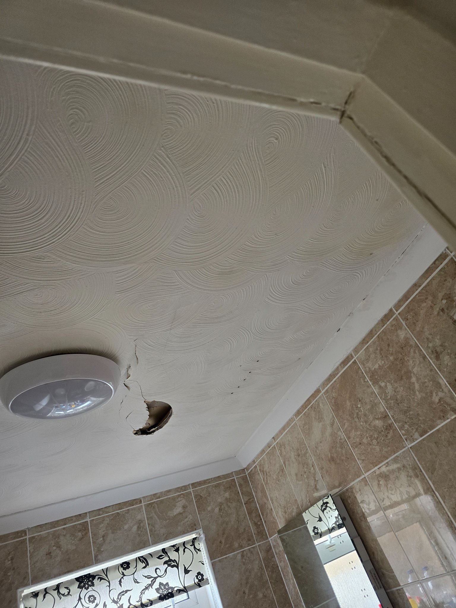

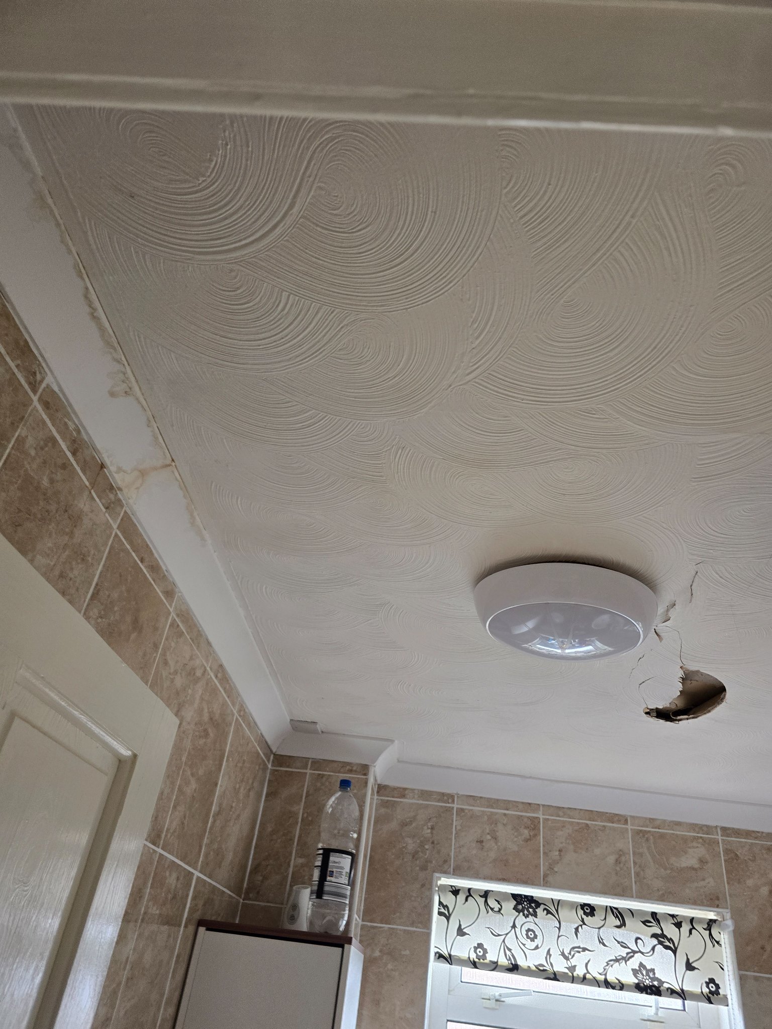

my bathroom celing got a leak and its sagged it . so i have bought new plasterboard , 1.5 sheets should cover it long ways , or 1 sheet halved for short ways .
I have enclosed a few photos of the damage .
should I pull down all the celing , or replace damaged part , celing is artexed, so it would be hard to match it in new side or flatten it off.
the plasterboard was put up before the walls were installed , so it goes into the other rooms .
I was thinking of cutting all around the sides using a plasterboard saw , pull it all down then measure and offer up new piece , the joints run longways .
If it's saggaed remove plasterboard.
Fit new plasterboard.
Skim ceiling.
Fit new coving.

I probably will need to fit battons to celing.
is it worth getting a drywall screw holder for drill ? the thing that puts the screw.in enough it doesnt puncture the paper
