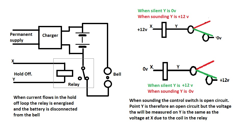

0 volts and open circuit are NOT the same thing and measurements of voltage can be confusing.
Hold off which stops the bell sounding is in most designs a current operated function. The results shown for the voltage at Y ( relative to 0v in the panel ) are for a high impedance volt meter. Using a low impedance volt meter which will draw some current through the relay coil the voltage at Y will be slightly less than that at X due to voltage drop across the coil.
Not all bell boxes use a mechanical relay but the basic principle is the same.
