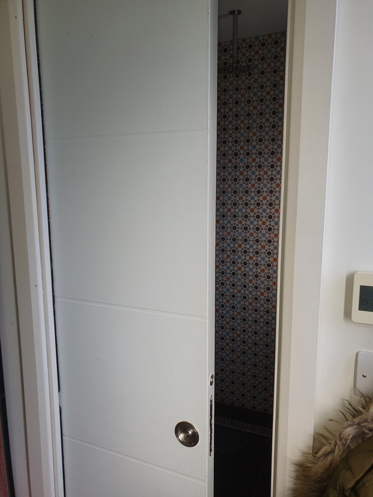

Pocket door. Swinging doors take up so much room

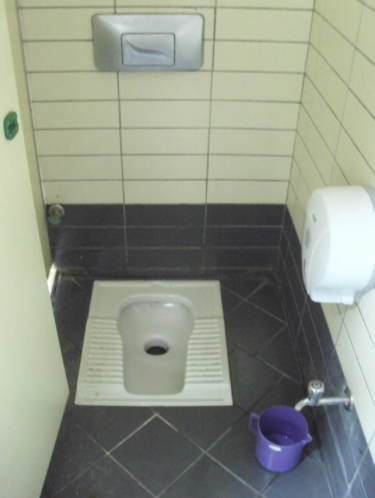

You could use a squatting toilet in a wet room floor with a rain shower fitted above it.
Not the most comfortable shower experience
No hand held shower hose permitted

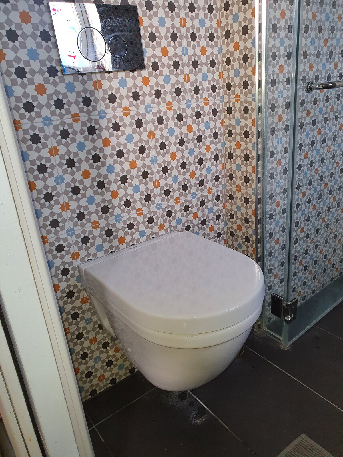

Floating compact toilet pan 480mm depth
Hidden toilet cistern ,(frame) that sits withing the wall cavity

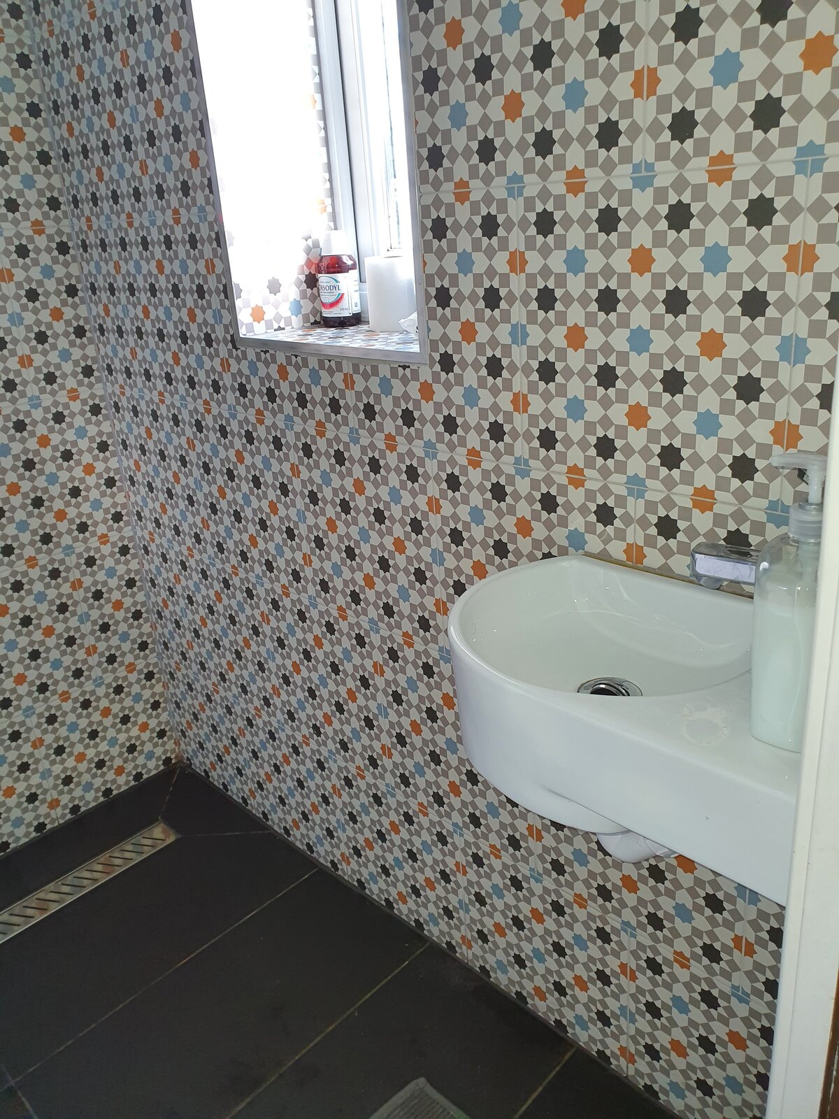

Folding shower screen opens room up when folded in. At the time I could only find 1 folding shower screen. That was really expensive. So I had this screen made for me.
Shower space 900mm x 680mm
10 kw Electric shower control sits flush on the wall instead of bulky shower valve taking up room.
