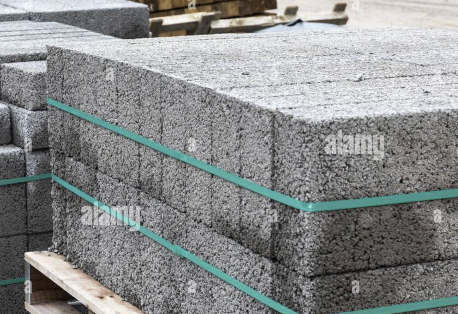

The dust was nothing compared to when I decided to widen the cupboard door in our bedroom with a 9" grinder into the 3" cinder block wall (1960s ex council).
Taped up the door, opened the window and set to it.
I finished the cut, looked down and realised I couldn't see my feet. Turned round and there was just a dim glow from the direction of the window.
I stood there for 5 minutes waiting for the dust to clear and my wife came to check on me as I had stopped moving.
Pushed open the door, quickly closed it again and said "what the hell did you expect"
