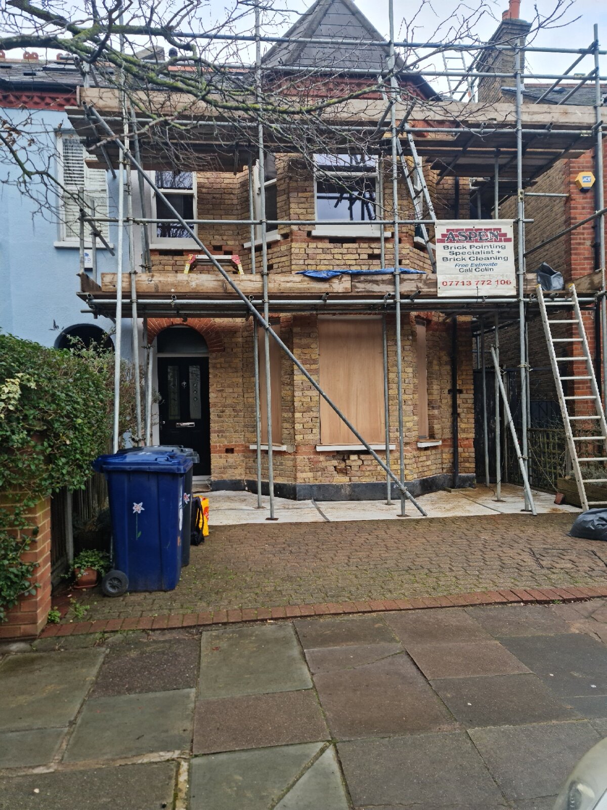

As an aside, last year my mate, Colin the pointer, asked me to cut a line in render between two semi detached properties (he had to remove the render. I had previously purchased a Festool angle grinder which runs on their tracks. The job it was previously purchased for was cancelled. I had to screw the guide rail to the wall and pull it down rather than push it up. It worked very well, and connected to the dust extractor, there was little in the way of dust.
