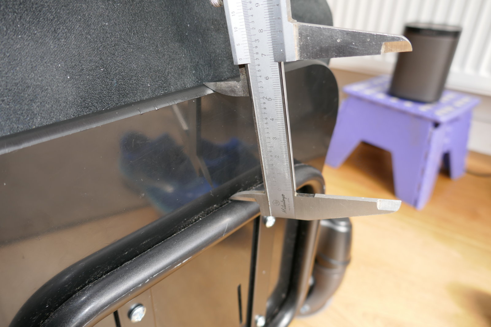

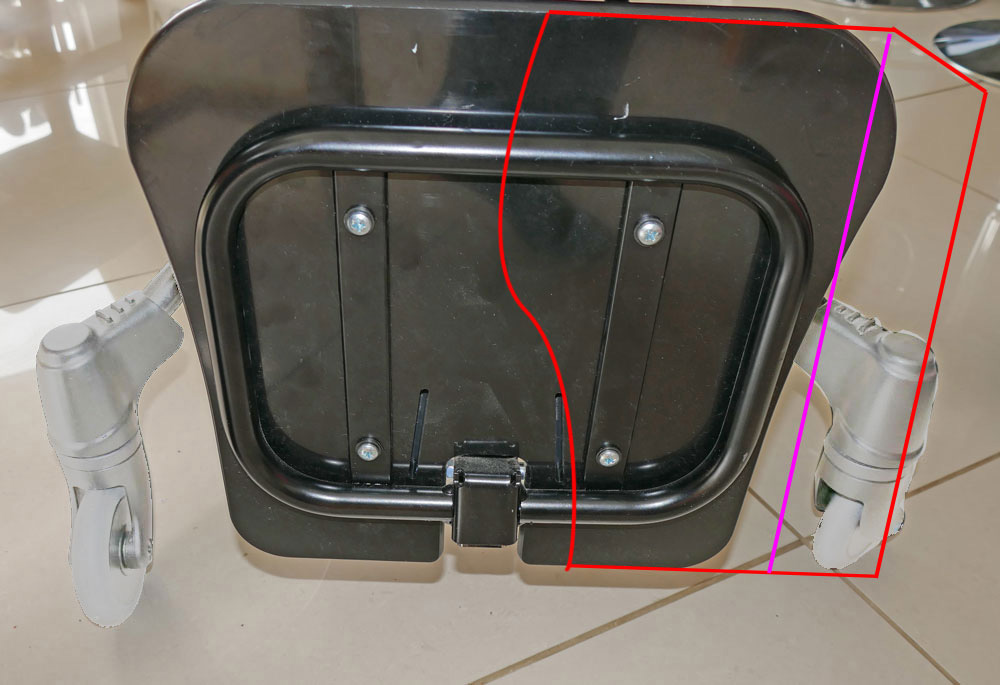

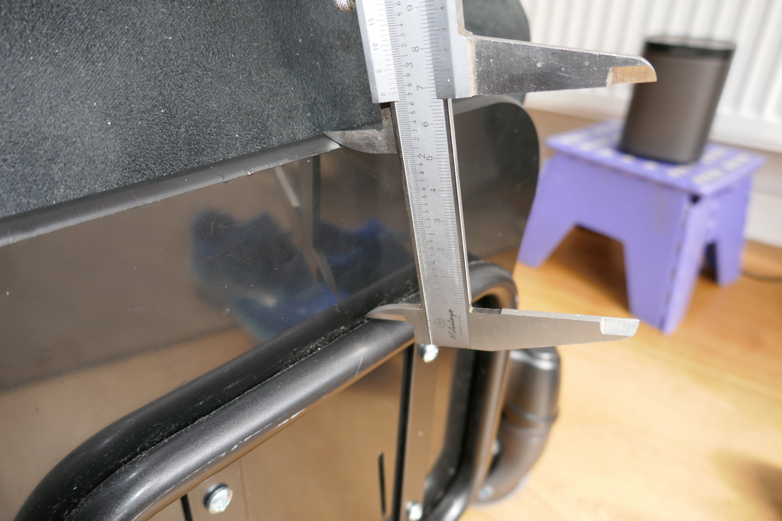

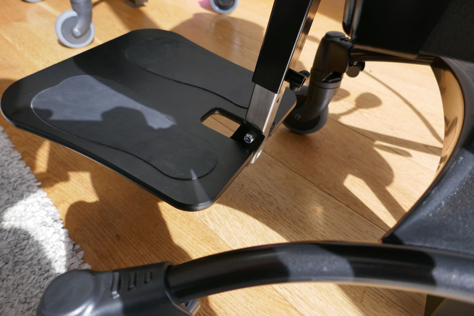

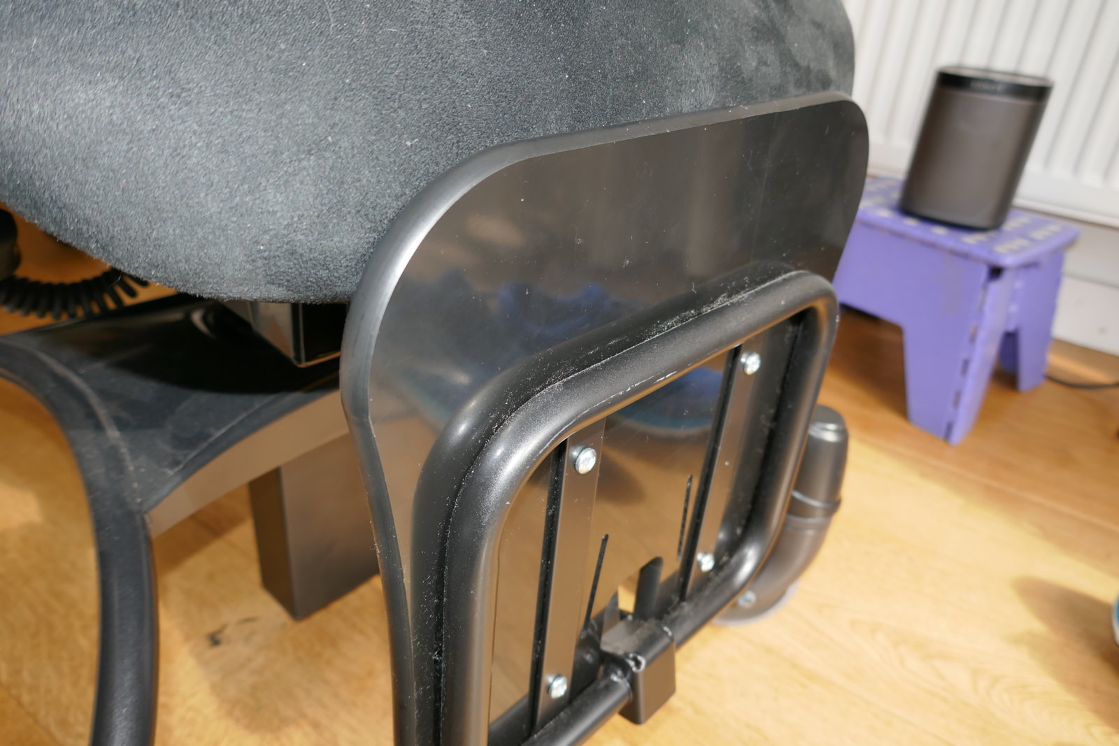

Underside of current footplate. Flat black part to be replaced, with side flaps. Currently ~250mm wide at centre, needs to be ~80mm wider each side. Tube steel to remain. NB this is not supposed to be stood on. Kid’s a lightweight 10yo.
Top to bottom as shown, plate is ~300mm. Round section steel ~25mm dia tube is a rectangular loop.
Pink line is proposed line of hinge/join.
Original material is a nice hard solid plastic, with a “routered” edge. Not sure what this is. Polyprop, HDPE, Nylon6 – dunno.

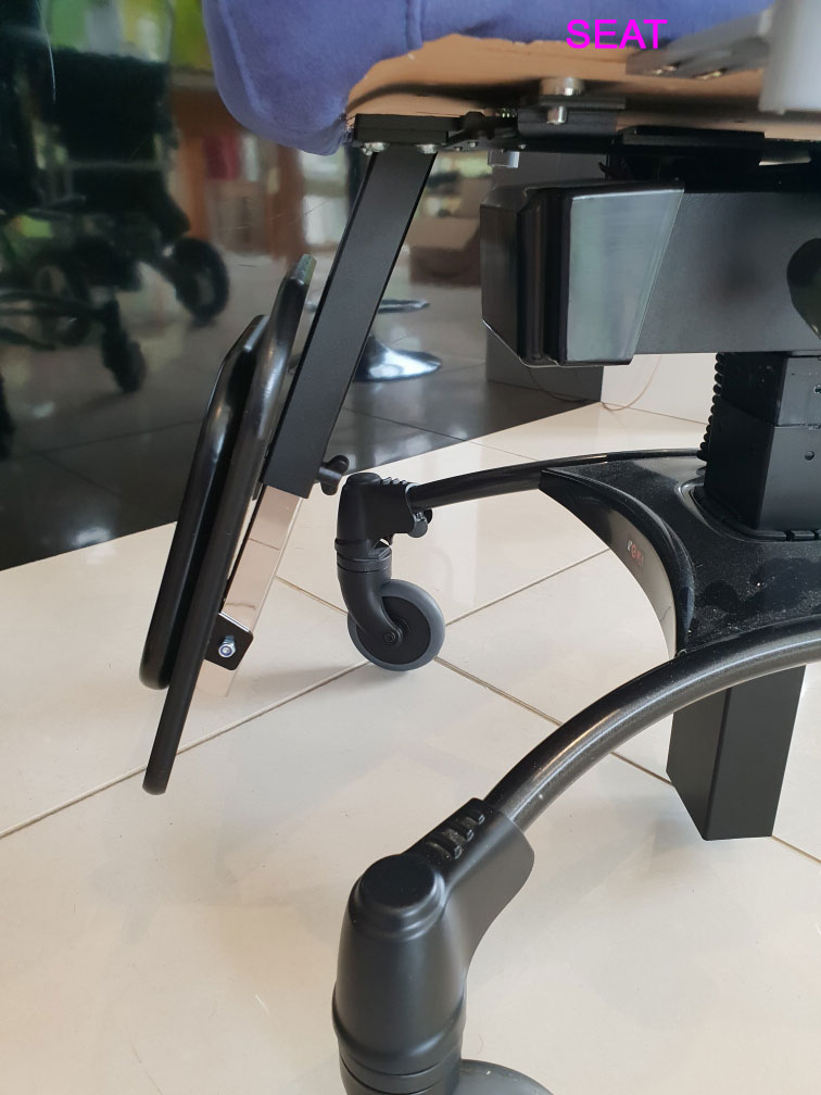

The footplate flips up as shown (in plane of paper/screen) so can’t be more than 12mm thick centrally.
The flaps have to hinge up out of the way so the user can get her legs round the sides, to fold the whole footplate up. The flaps would then be under the seat part of the chair - plenty of space. Flaps will have a ~19mm upstand at the edges.

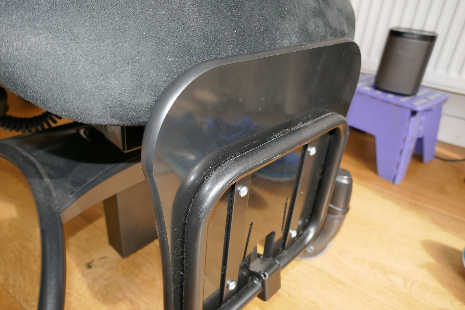

assuming thats the bottom of the seat have you got a picture off it in the down position
Big-All - I'm a bit better with a router than with Word Drawings, so I'd rebate them, & I take your point. They appear to be 8mm here. Probably as you say, better (let in to) the top surface. I could always put a row of screws with their heads hitting each other to control the gap.
The picture is looking at the bottom of the footplate when it's folded UP. See the wheels - greyed out a bit.

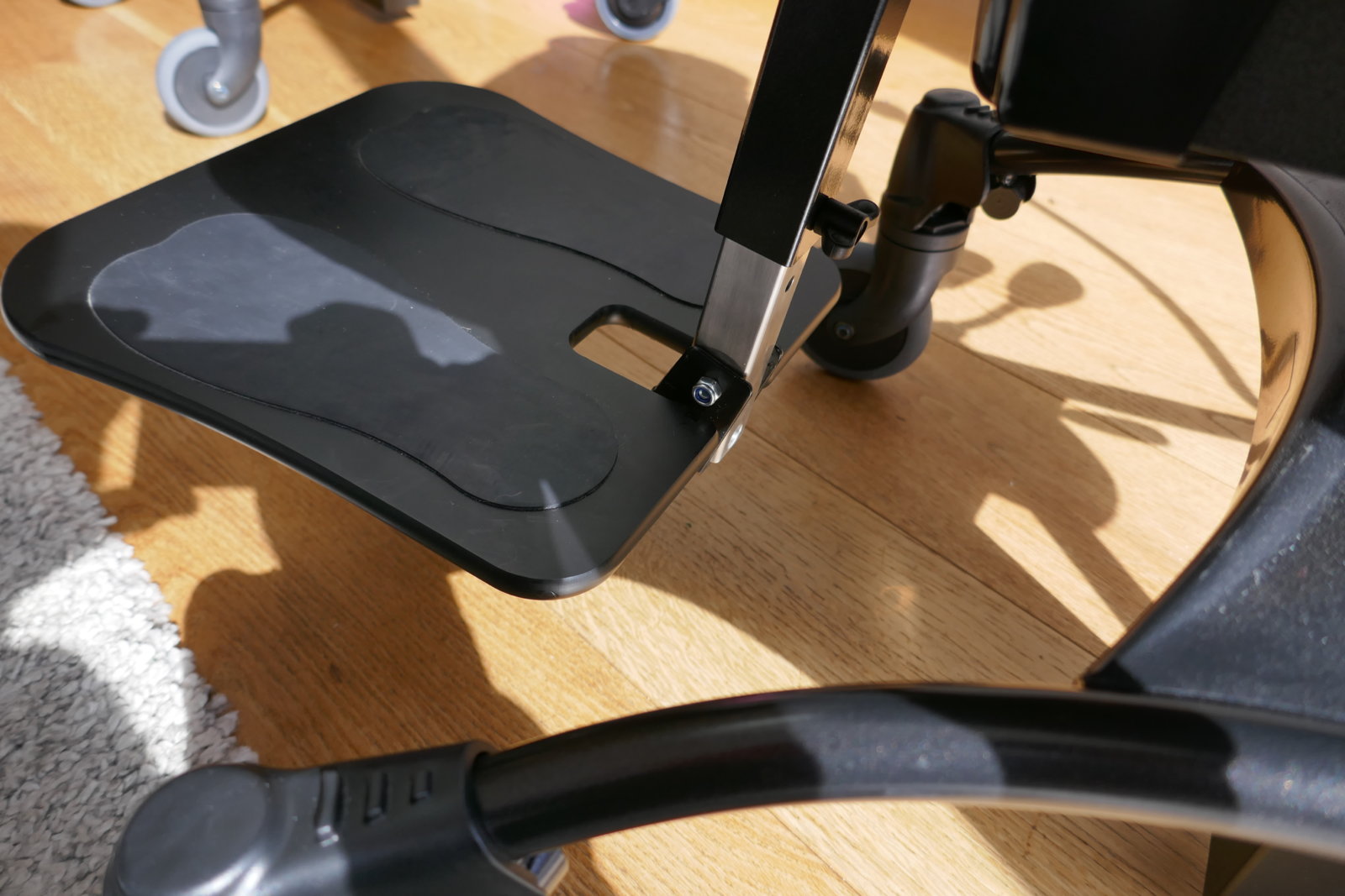

ahhh its the foot rest that folded up

Thsi pic makes it looks kinda funny. I didn't take it. the footplate is edge-on.

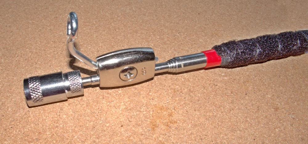

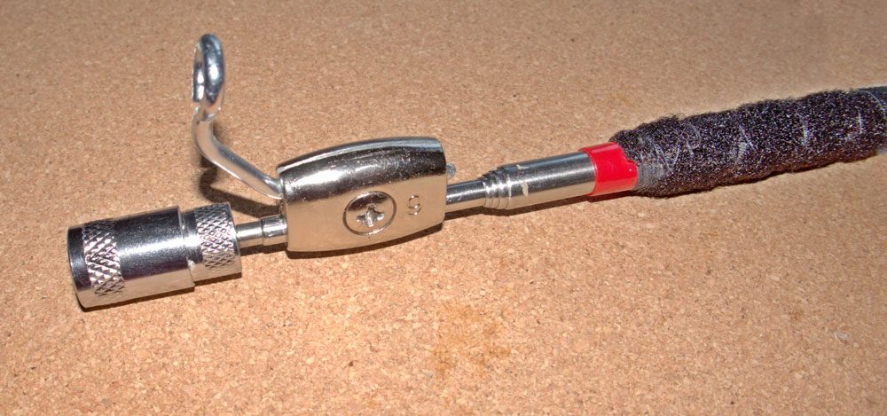

Know what you mean about wanting funky. The other pic is an extending hook I made for a lad to lift his footplate. So I started with a magnetic pick-up tool with a light on it. So he pokes the light into things, picks up things...
